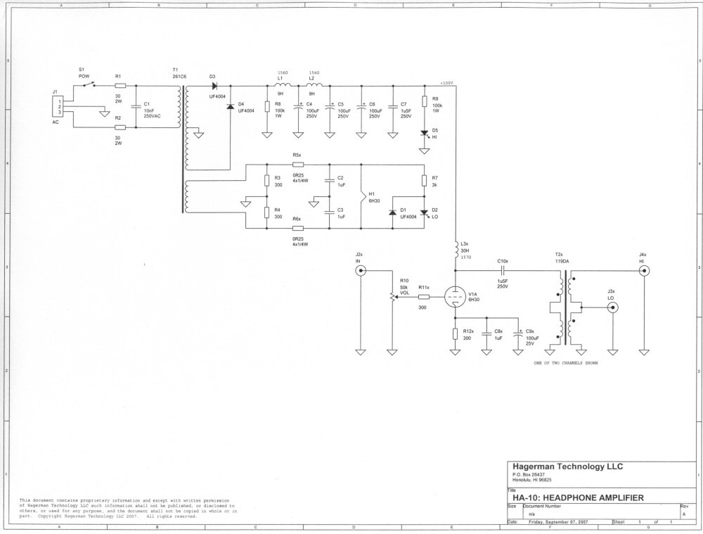

Is it a parafeed transformer?
If yes, use tube with CCS as anode load, and connect 1..10uF capacitor between transformer primary and anode (ground transformer another leg).
As schematic in post 50 http://www.diyaudio.com/forums/tubes-valves/300896-understanding-load-lines-5.html#post4923487
No, the post 50 schematic is series feed.
This is one of parafeed schematic.
In place of 30H choke the CCS, right?

Could I left the CCS to 20mA , the grid -3V and plate voltage 88V or I have to change something to improve the sound quality.
Edcor pin 1 to output cap, pins 5 & 9 to ground and pin 7 output, right?
Right.
Tomorrow I will add the OPT, now I'm tired. Thanks for all help I will keep us informed.
You can only have two independent variables. With the current set to 20mA and the grid at -3V the plate voltage will settle were it needs to. As the tube ages the plate voltage will increase over time.
