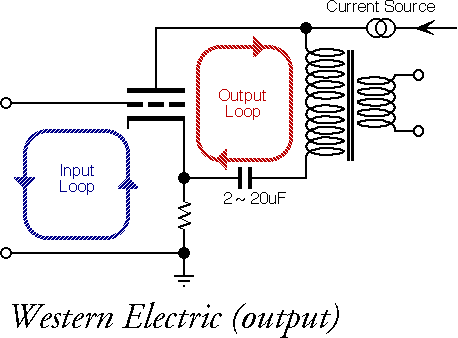

I have a friend who wants to hear a tube preamp feeding his powered speakers (QSC K8), to hear for himself what all this fuss over tubes is about. That's why I was thinking of a preamp with balanced outputs in the first place. Then I got the idea (from various sources) that an input transformer on the power amp would be cheaper and better performing. So I started looking at things like the Jensen JT11P-1. Edcor has a 0.5W 10K:10K transformer that should work, as well as 15K:10K and 15K:15K versions, but none have shielding cans. They certainly are inexpensive (less than $15 USD each). I should probably just buy a pair and see how that works.
Now, if I'm following correctly what you've been saying, I could feed a 4:1 transformer in parafeed mode from a cathode follower or maybe a common cathode 6e5P-triode, and get good performance that way. If the primary is specified at 2k4 impedance, and it's a 4:1 transformer, then the secondary will have a very low impedance (150R?). Will the primary inductance be high enough to get decent bass response from the preamp?
Looking at this Edcor 2:1 line matching transformer -- https://www.edcorusa.com/wsm600-150 -- I see that the primary impedance is only 3H.
Driven from a 200R output impedance (like a 5687 cathode follower), that would put the f3 at about 10Hz. That's not all that great, but is probably acceptable.
Edcor's 10K:600 XSM (2 watt) transformer -- https://www.edcorusa.com/xsm10k-600 -- shows 40H for the primary inductance. That's a little better.
It looks like there are compromises to be made everywhere I turn. There's a lesson in there... Everything is a compromise.

If you are going to do parafeed this is the way to do it. It removes the need for a cathode bypass cap since the AC potential of the tube cathode is virtual ground. It also reduces the sonic impact of the parafeed cap since the cap altered signal is used to modify the degenerative feedback of the valve.
Shoog

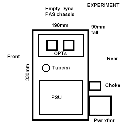

I'm still worried about how to keep induced hum from the power xfmr (and maybe power supply choke) out of a bare output xfmr. I have a gutted Dyna PAS chassis (steel) to work with. The power transformer will be mounted on the back panel of the chassis, hanging outside. I figure the OPT's will be inside the chassis, mounted on a non-conductive plate (masonite?). I will use some kind of non-conductive plate to mount the power xfmr. Maybe something like Garolite, or whatever that stuff is called.
The only reason using transformers is more complicated than just adding a split-load inverter is layout and worries about induced hum.

I haven't had issues with induced hum and some of my input/output transformers have been screened and some haven't. Sensible placement is essential and then if you can incorporate it an aluminium box with a ground wire should make an adequate screening can. Think 1/4" thickness aluminium. The only times I did get problems with induced hum is when the power transformer saturates and then starts spewing huge amounts of field into the case. I had this with my last vlave build on a underspec'd negative supply, I replaced it and the problem was gone.
Having the power/chokes on one face of the case and the signal transformers on the other should also help a lot.
My speakers make just 1mV of hum audible so I wouldn't sweat it to much.

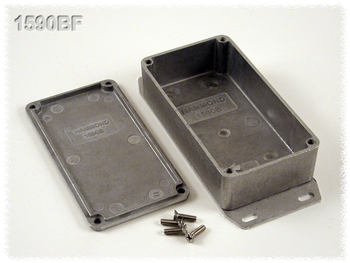

Thanks Shoog. That's encouraging. 1/4" thickness aluminum box.... Maybe one of those die-cast aluminum boxes used for guitar stompboxes, but with a flanged base, so that I can bolt it to the chassis. Hammond Mfg. - 1590 "F" Series - Diecast Aluminum - Flanged Photo Tables
You know that makes this even more expensive, don'cha?

Its inductive coupling which is Rongon's main concern and thats why aluminium was suggested over mu-metal or something more appropriate for radio interference. Iron would also do, but I think silicon Iron is best.
i was researching this myself since my latest solid state build has a small induced hum from the power toroid and the Studio crowd were suggesting aluminum shielding as a way of damping it.
I would build without and only add it if it proves essential.

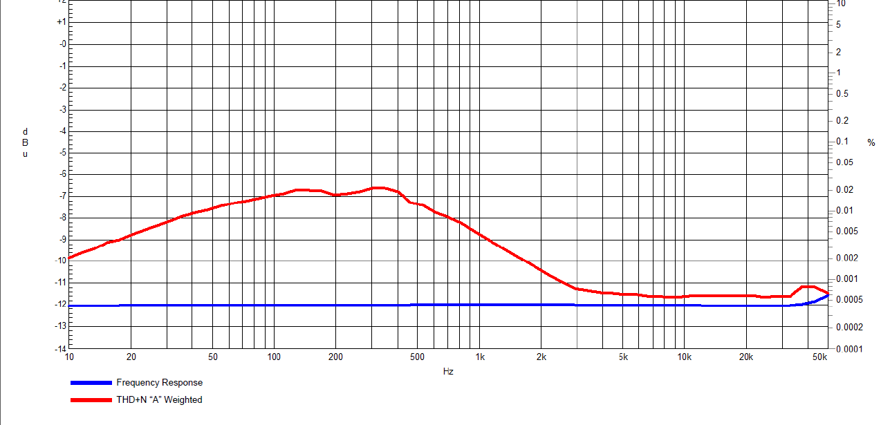

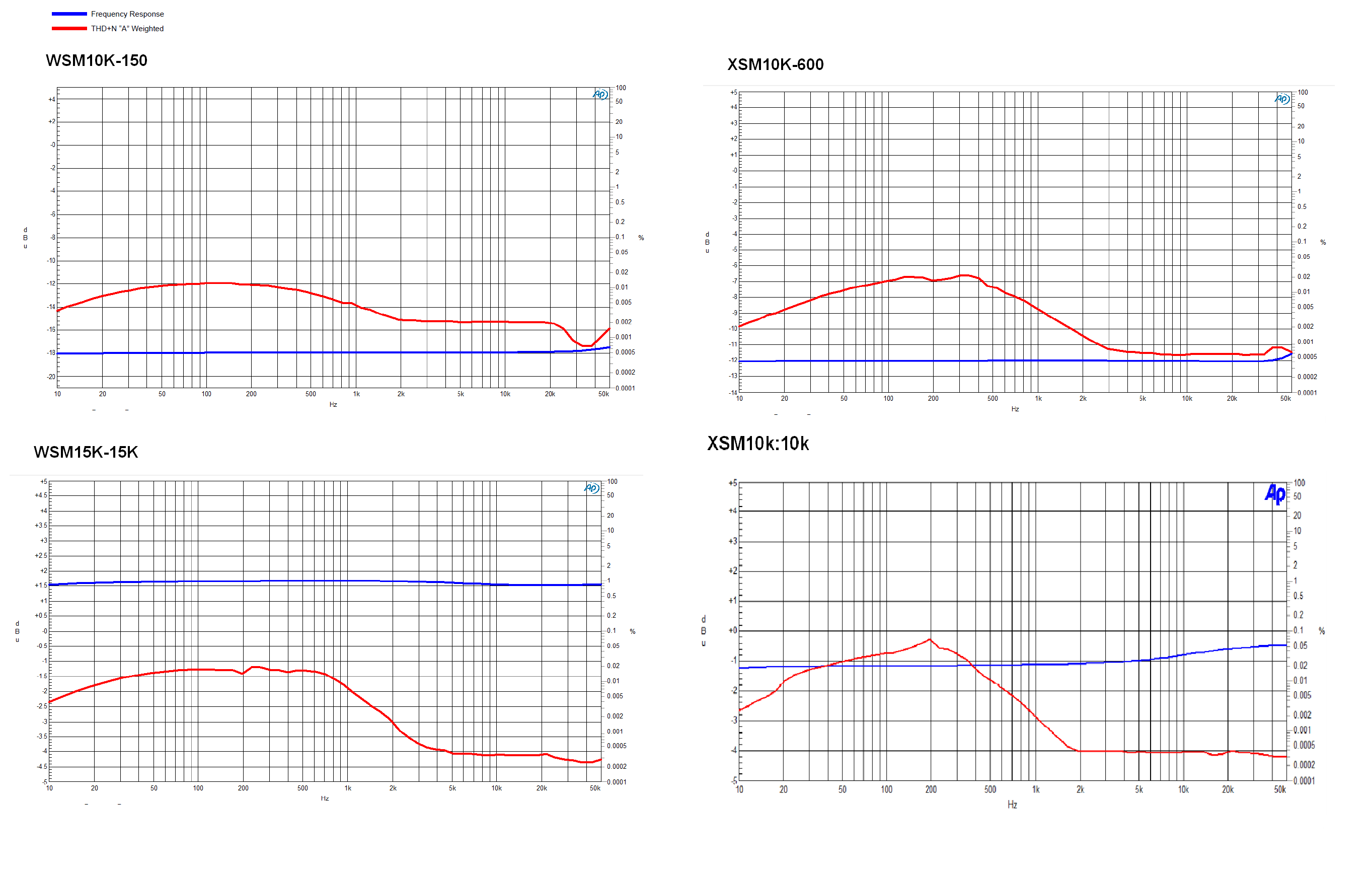

Thanks again. Last night, before I saw your last post, I bought a pair of XSM10k:600, along with a pair of WSM15k:15k (what the heck, maybe I'll learn something).
I picked those two because their frequency response graphs showed the least rise in high frequencies.
The XSM10k:10k doesn't look so good (rising treble response). WSM15k-15k response looks smoother. Also, not all of Edcor's offerings have frequency response charts available, so I had to make a decision based on limited data.
Of course, I don't know how valid those charts are, or how well they represent real-life performance.

I went searching for some other opinions and found that the professional studio people generally love the EDCORS. I think its all down to implementation. I would be looking at pushing at least 10-15mA of standing current at them using a mu-follower to preserve gain but lower output impedance. With step down its not difficult to get flat response out to 50Khz if you drive them sensibly. Thats why I would go for something like the 5697 which is more capable of higher bias currents than most medium mu valves.
The other good option for a driver is the SLCF which has two stages meaning you can choose whatever gain you like in the input - and then a very linear cathode follower to push the output. I have two and they work extremely well.
