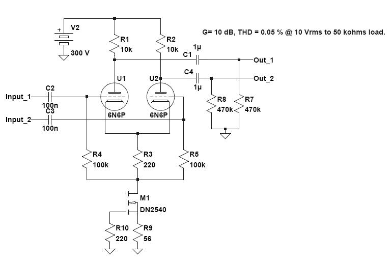

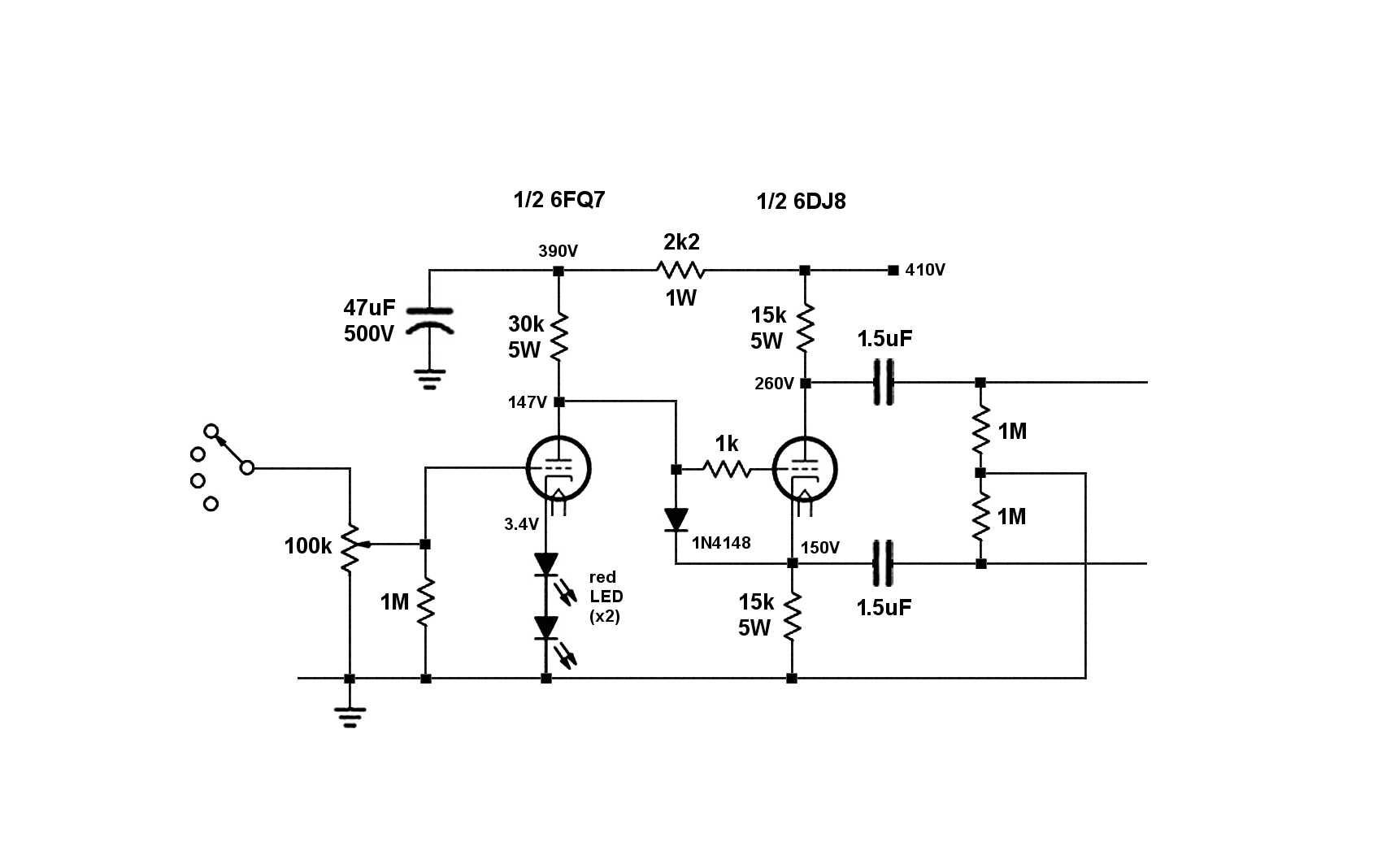

Here it is a whole year later, and I have two competing ways of getting balanced signal to my power amp.
I never did use the 10k:600 transformers. But I did learn how to use LTspice, and noticed that using a stepdown transformer like that makes the driving tube work pretty hard, which of course increases distortion. I don't think that's my goal.
Instead, I purchased a new pair of Edcor XSM15K-15K transformers (15k:15k, or 1:1, center tapped primary and secondary). The first Edcor 15k:15k transformers were the WSM version, which is on a smaller core. The primary inductance is small on those, no more than 15H. The XSM15K-15K is much better, at least 50H. Swapping those in brought an immediate improvement in bass response (no surprise there). I was able to decrease the output caps in my 6N6P line stage to 2uF (down from 10uF). The 2uF caps in the preamp makes it noticeably more listenable. I guess smaller value caps are indeed better sounding, if you can use them.
I've also completed a variation on SY's ImPasse preamp, using a 6CG7 voltage amp stage to a 6DJ8 cathodyne (concertina) phase splitter/output stage. The power supply is very basic, just an old Thordarson power transformer, 5Y3GT rectifier tube, CLC (47uF--16H--100uF), then each channel has its own RC (1k--100uF). Heaters are AC, with +50V bias to stay within heater-to-cathode limits.
In LTspice, both look like they should work well, with reasonable distortion levels. Again according to LTspice, the 6N6P line stage I have runs at about double the distortion of the 6CG7. With the two of them built, I can swap them in and out and compare the sound.
Transformer coupling is nice. I'm hearing nice solid images, but there is a sort of 'generalization' of low level details. It's like the sound is a little smoothed out. Very listenable, though. Maybe the transformers need to 'break in'?
The balanced out preamp (with the 6DJ8 cathodyne phase splitter) is nice too. It's more 'hi-fi' sounding, crisper highs, the bass might be a little tighter, more little details are audible.
I like both. I don't know which is 'better.'
I've attached a schematic of the actively balanced preamp.
