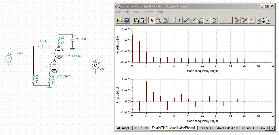

Since the White cathode follower is push pull, will it cancel all that sweet 2H?Yes, it is a White Follower, which is an excellent driver in my opinion.
It should be fine. See the attached FFT of a 6SN7 White Follower.

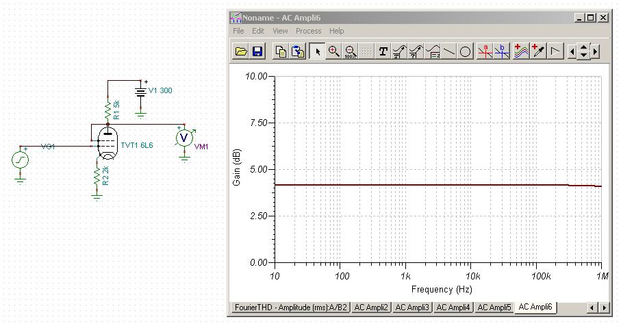

Maybe think outside the box? As was mentioned, use a very low mu tube, in this case a 6L6 triode connected. Also, use a lot of degeneration. THD is 0.02% or so. Gain is 4 dB.

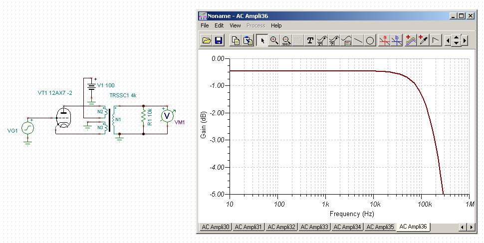

Look Ma! No resistors!
Well dang. This looks like fun, if you need attenuation of course... THD is 0.007% or so, even at 20 Hz!
Ooops, my bad. The currents flow in the same direction in the primaries... dang it. sorry about that!

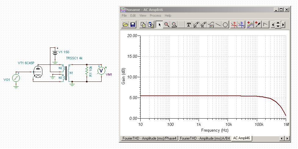

If you got a custom transformer made such that the cathode winding was 50% of the primary winding, and used a high Gm tube like a 6S45P, then you'd get something really awesome with 6 dB of gain.

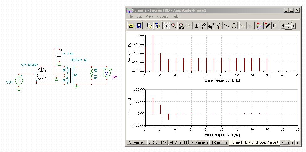

Look Ma! no resistors and no distortion!
Ah, the 6S45P/437A.... With a cathode winding @ 50% of the turns of the primary, THD is less than -100 dB (0.0009% @ 1 kHz) for 6 dB of gain and 1 volt p-p input. Dang. One tube. One transformer. Balanced output. How much more simple can it get?
Of course, the ultrapath feedback network could be added to this to increase bass performance even more...

What is the effective bandwidth of the coupling transformer when attempting to pass the maximum signal?
That is difficult to say, since I don't have accurate transformer specifications to put into the simulator. Results will vary from those shown, depending on who makes the transformer. I made some "educated" guesses based on the data sheets from various manufacturers.
