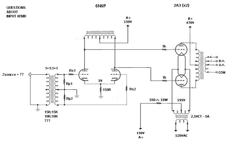

I want to get a balanced signal to my power amp (PP 2A3's, 6N6P LTP driver, just the two stages). My first thought was that I'd make a preamp with balanced outputs, but that will guarantee that I'll have too much gain. (Common problem.) Then dirkwright and others suggested I use transformers to split phase. I've found the best place to do that is at the input of the power amp instead of at the output of the preamp.
So I went looking for input transformers for tube amps. I've found some info on the Lundahl site, and it looks like the LL1690 is what I'd want to use there. But it's really pricey. Since it's a 1+1:1+1 'high impedance, high level' transformer, I figure Edcor has something similar. They have a couple of 15k:15k line transformers, one of which is the XSM15K-15K.
If I use that one, how would I wire it into my amp's inputs? I whipped up a schematic showing what I think is the way to do it.
Is the 1+1:1+1 input xfmr made to work as a 2:1+1 the way I have it shown?
Rp1 and Rp2 are the load resistors. How do I figure what values to put there? Would I need to do that empirically, putting a square wave in and adjusting for best looking waveform on a scope?
Rs1 and Rs2 are the grid stoppers for the LTP stage. Would those still be desirable with a transformer-coupled input?
Thanks for any pointers. I'm completely out of my element here...

How much are you willing to spend on this? Jensen, Cine Mag, Sowter, Lundahl, etc. all make fine high impedance 1:1 input transformers. You don't need a center tap on the transformer secondary, so you can use a normal input transformer. A 10k:10k input type should be fine for your application.

Step down is always going to perform better if you can burn some gain up - and for all the reasons you mentioned. Basically the more wire needed for higher impedance ratios, the more strays present and the more expensive the winding techniques to avoid them.

The way i have and would do it is with a LTP driving a PP output transformer which can be setup for zero standing current. Its surprisingly simple and produces a good result. Using a wilson current mirror is the best way to go but requires a cathode to cathode bypass with a large electro-cap.
An output impedance of 1000R places you into the expensive range since you need the transformer to be at least 4000R to get adequate loading. Here a 10K:10K transformer looks sensible, but to get 10K:10K+10K is even more expensive again.
There are no free lunches, but if i were you I would fight my phobia about parafeed caps and go the easy way. personally i think the ill's of a parafeed cap are far smaller than a gapped transformer unless you are going for that classic SE sound.
My candidate for this job would have to be the 5687 into a step down of 4:1+1 giving a gain of about 2x overall.

Mr. Yaniger's preamp for the Pass F4 was unbal in bal out (You can eliminate the input transformer)
