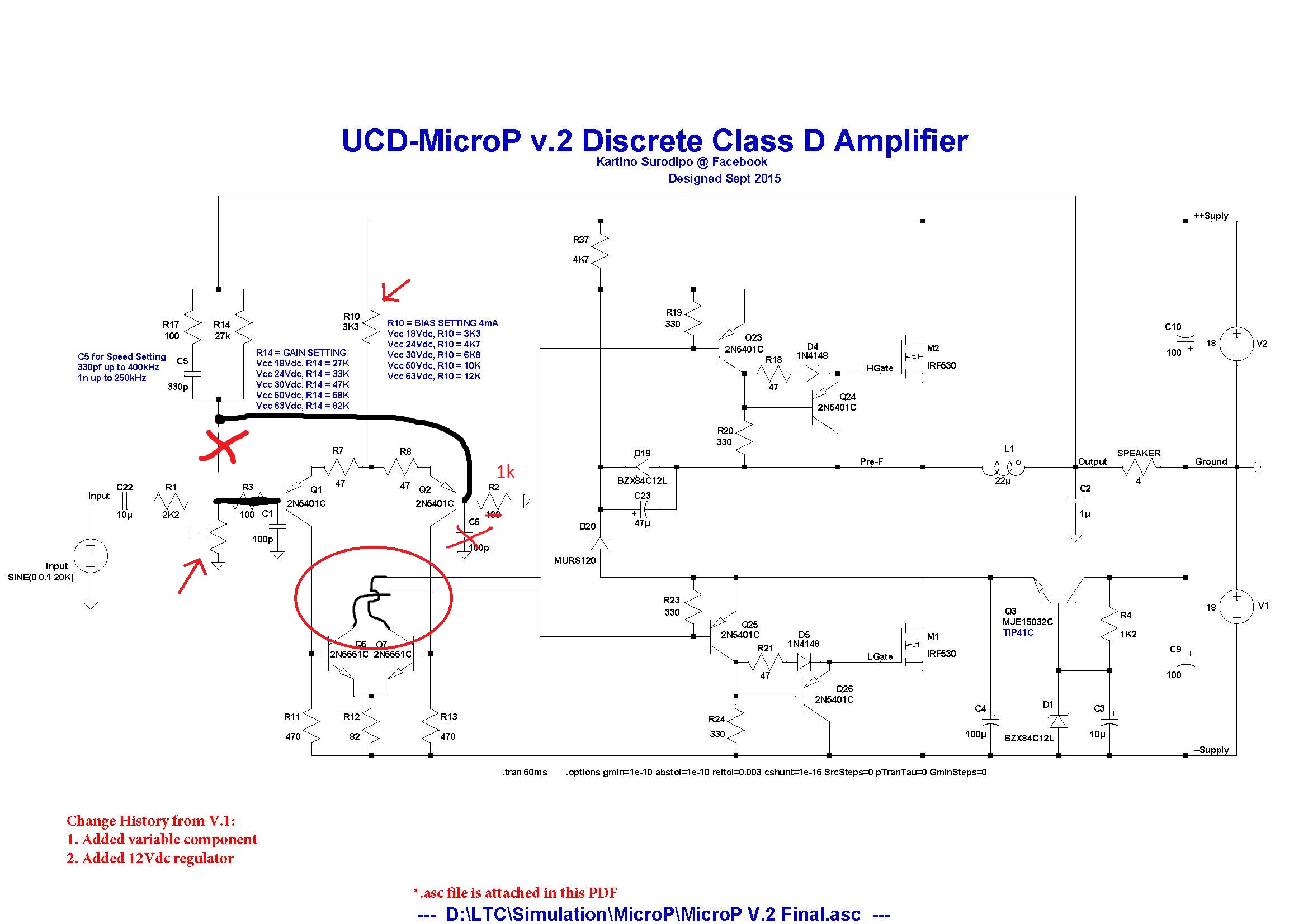

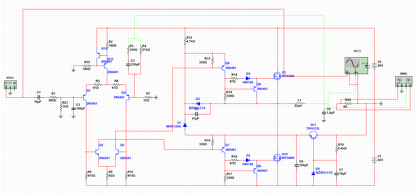

Ultra Simple Class D
simple dclass
A improved version of IRS900;)

IRF640 is quite a bad choice because of high Qrr, high Rdson.
BTW designing? Simplifying the patented UcD in a bad way can not be called designing IMHO. Bruno Putzeys designed.
Agree. But it is availabe here and cheap
Agree also, but too much if you called bad way. It is pure personal preference. As said before. It is a challenge. I know you and this forum since starting the class D forum.
