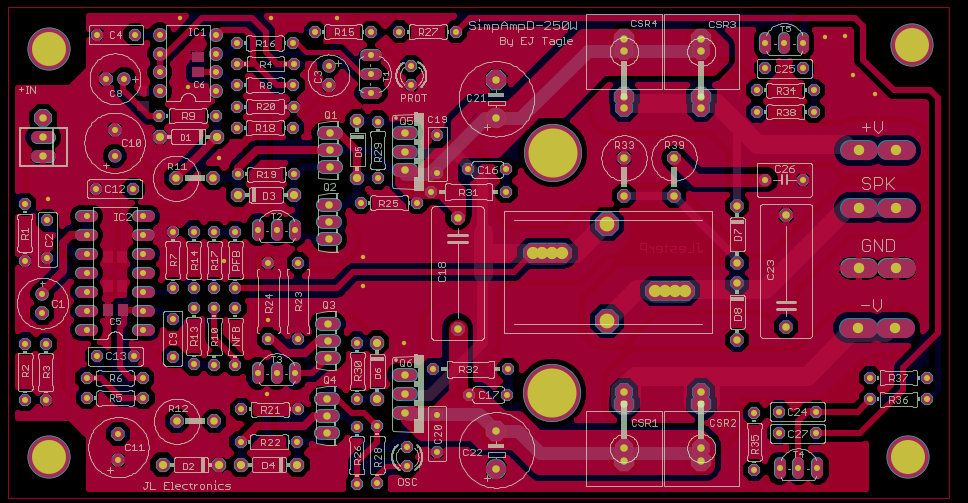

Post your pcb image bottom side and component side

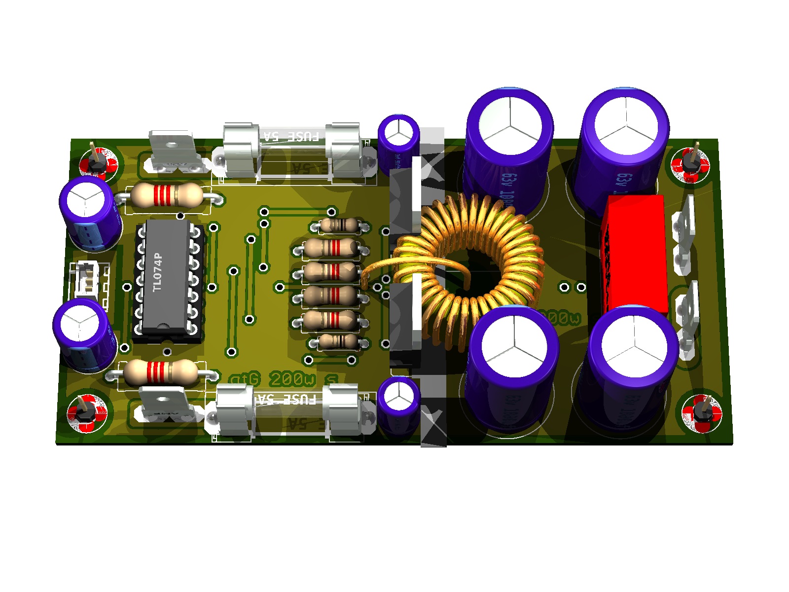

Nice work!Hi to all, this is my final amplifier SMPS +class D + speaker prot. It is working fine from several months.
Where we can find the schematic and pcb as built?

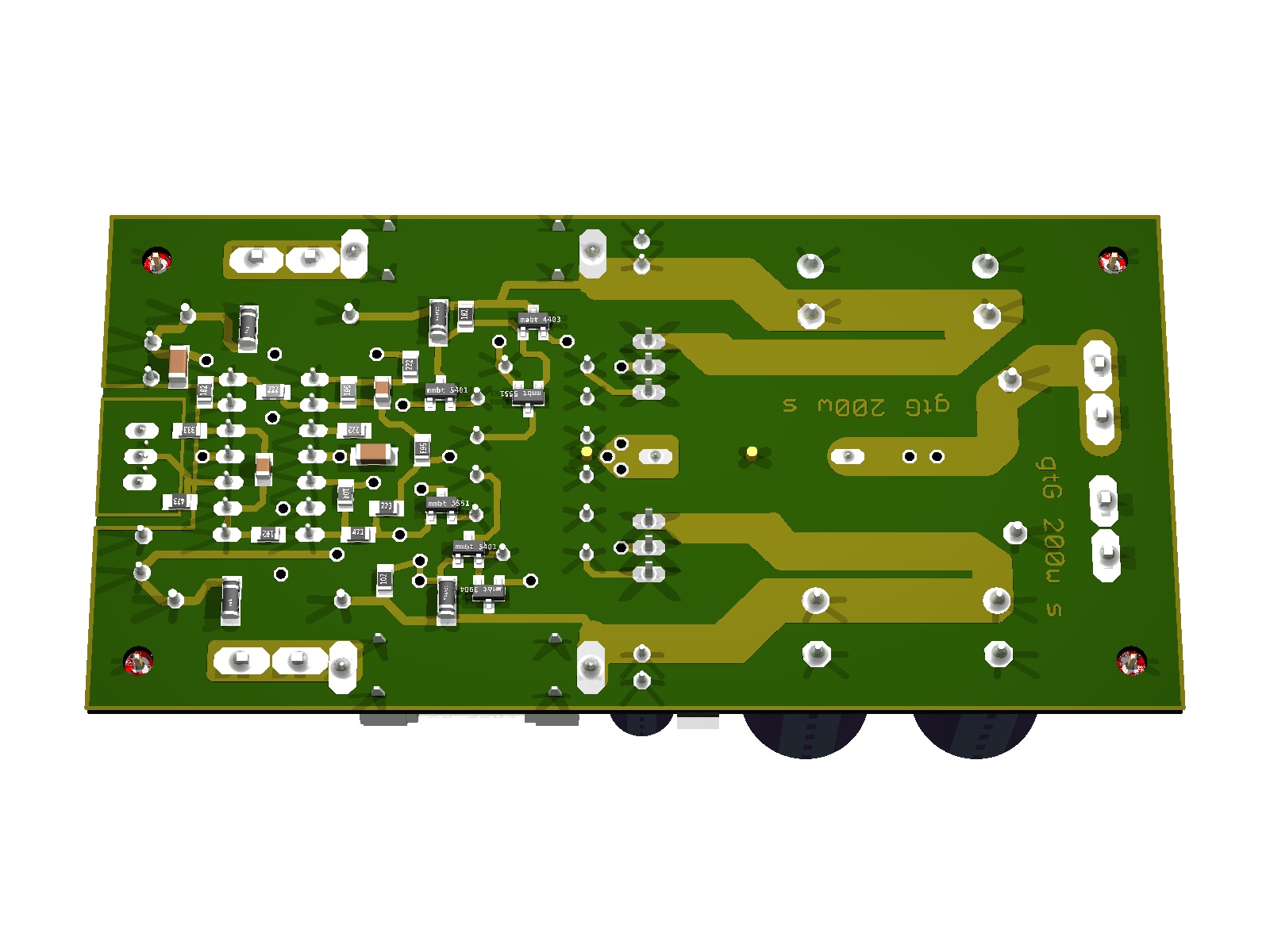

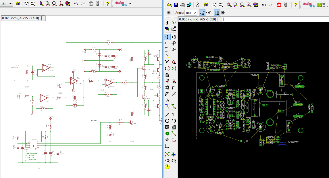

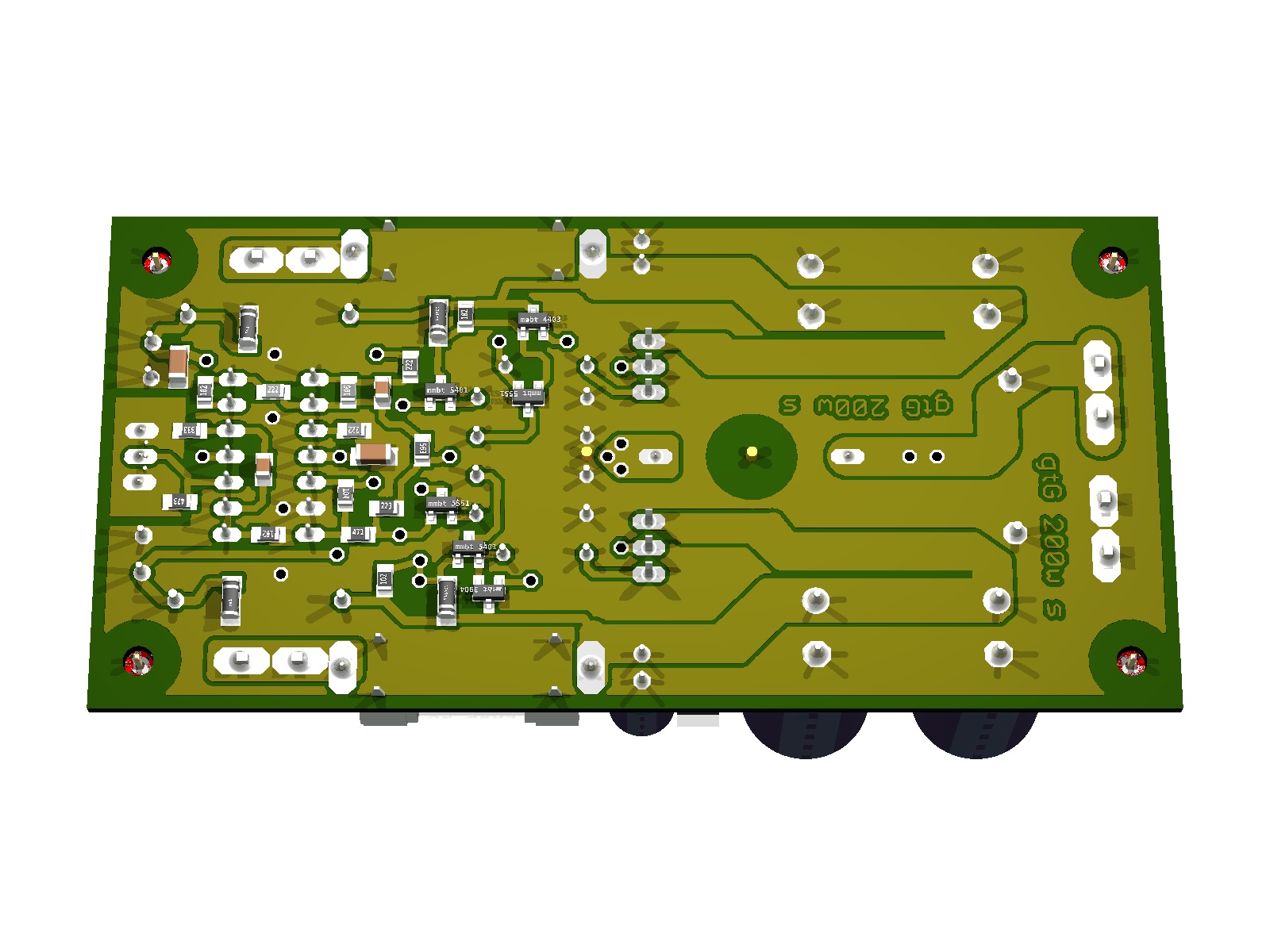

hi all finally smd version completed :UP: 😀😀
instead of bc337 and 327 i used mmbt 3904 and mmbt 4403 any comments are highly appreciated
Dear stewin could you please share schematic or pcb layout files?
Much appreciated!!
😎hi all finally smd version completed :UP: 😀😀
but mmbt5401 and mmbt5551 i have and i will use. i use tl074 from ti (texas instruments) as they are the only ones which work with this circuit.
