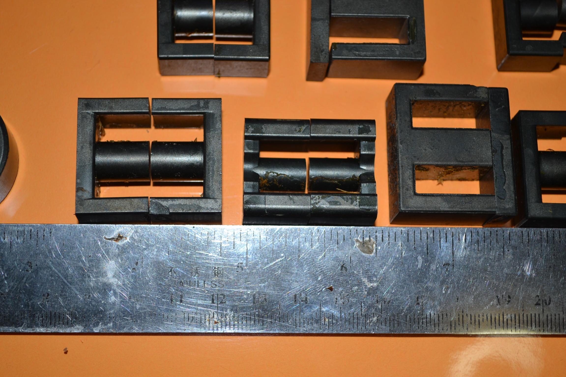

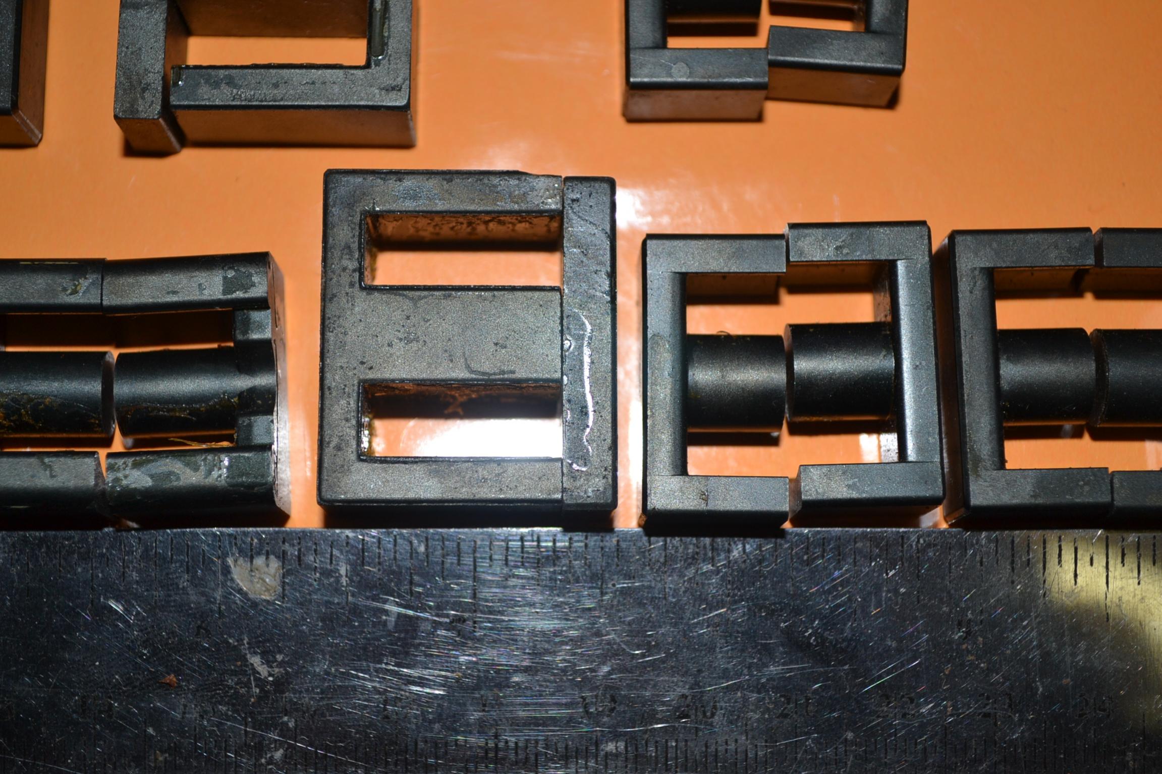

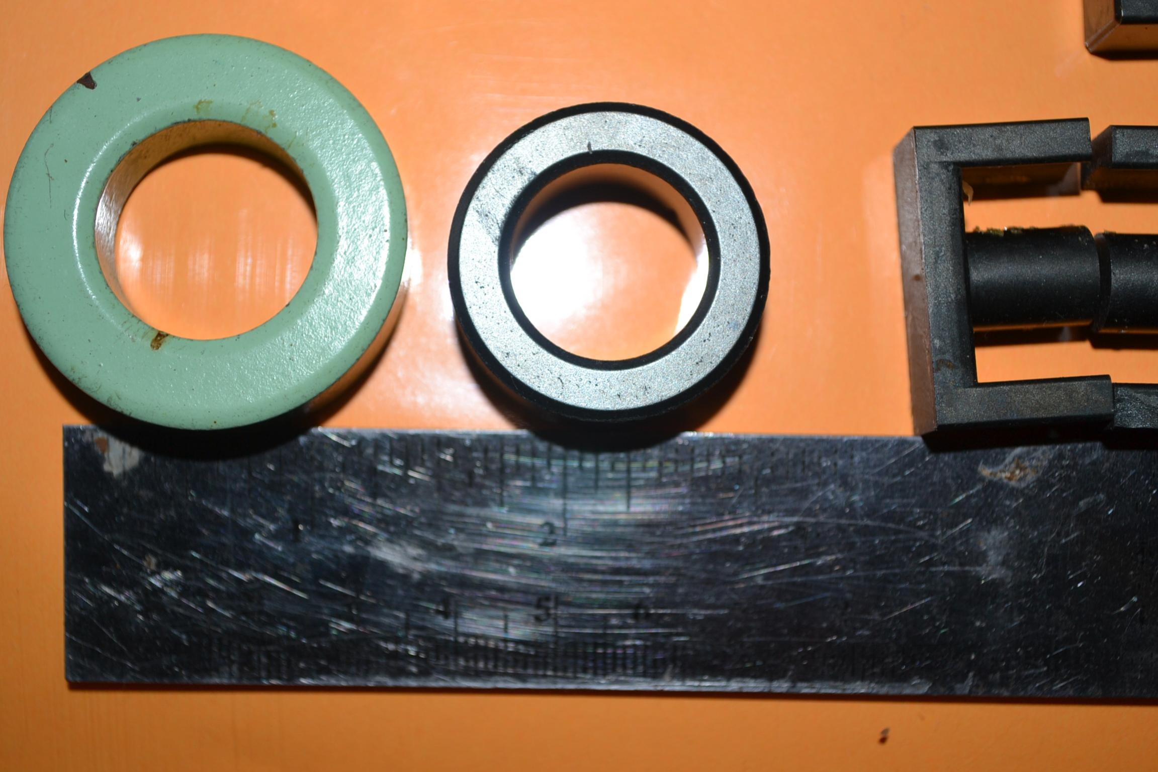

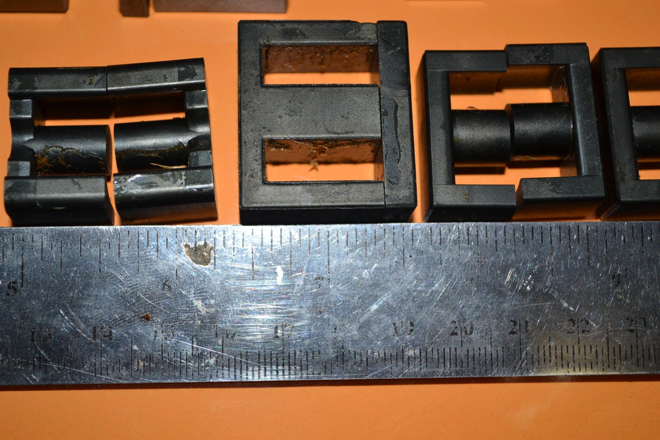

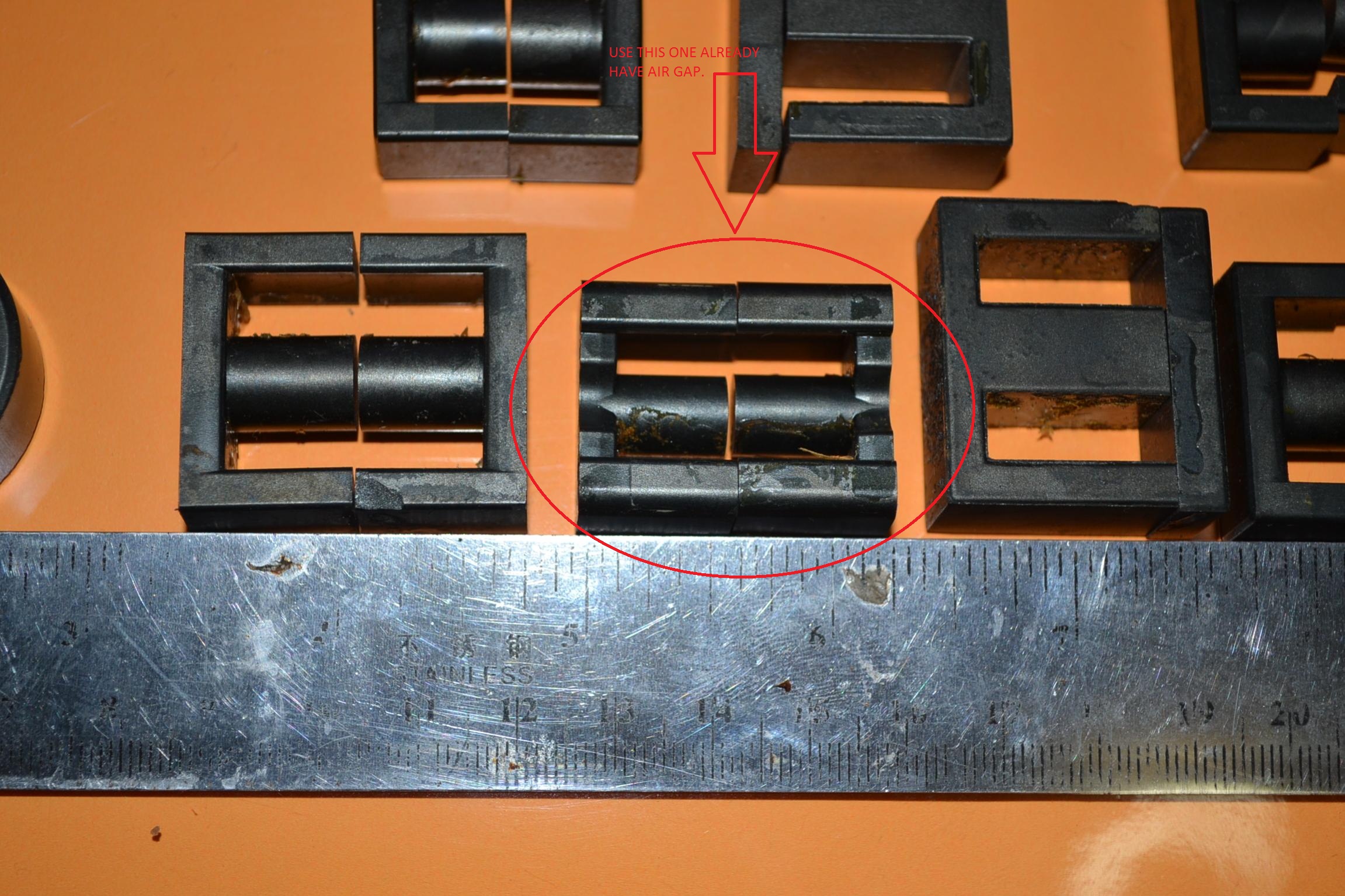

Norazmi thanx i did use 22uh 47 turns with the red core 1uf filter still have this problem coil heats up ill post my ee & ei ferrite cores smaller than ei33 maybe you can help me calculate

hehehe i want to experiment the core every core have different response red core good detail audio,green good for low ,

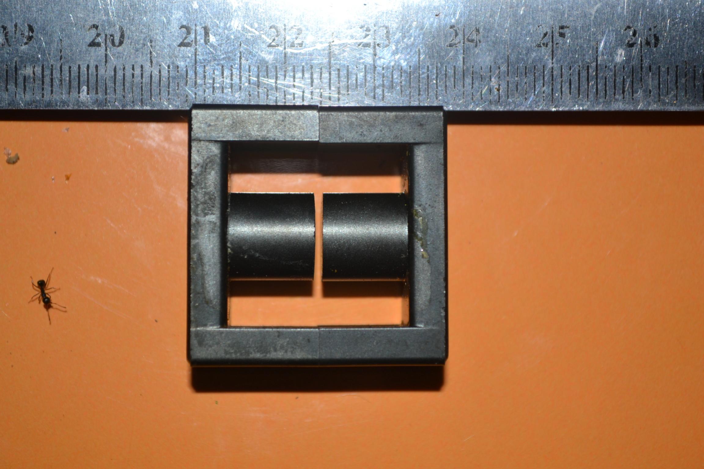

what about this one gap is bigger than the other one

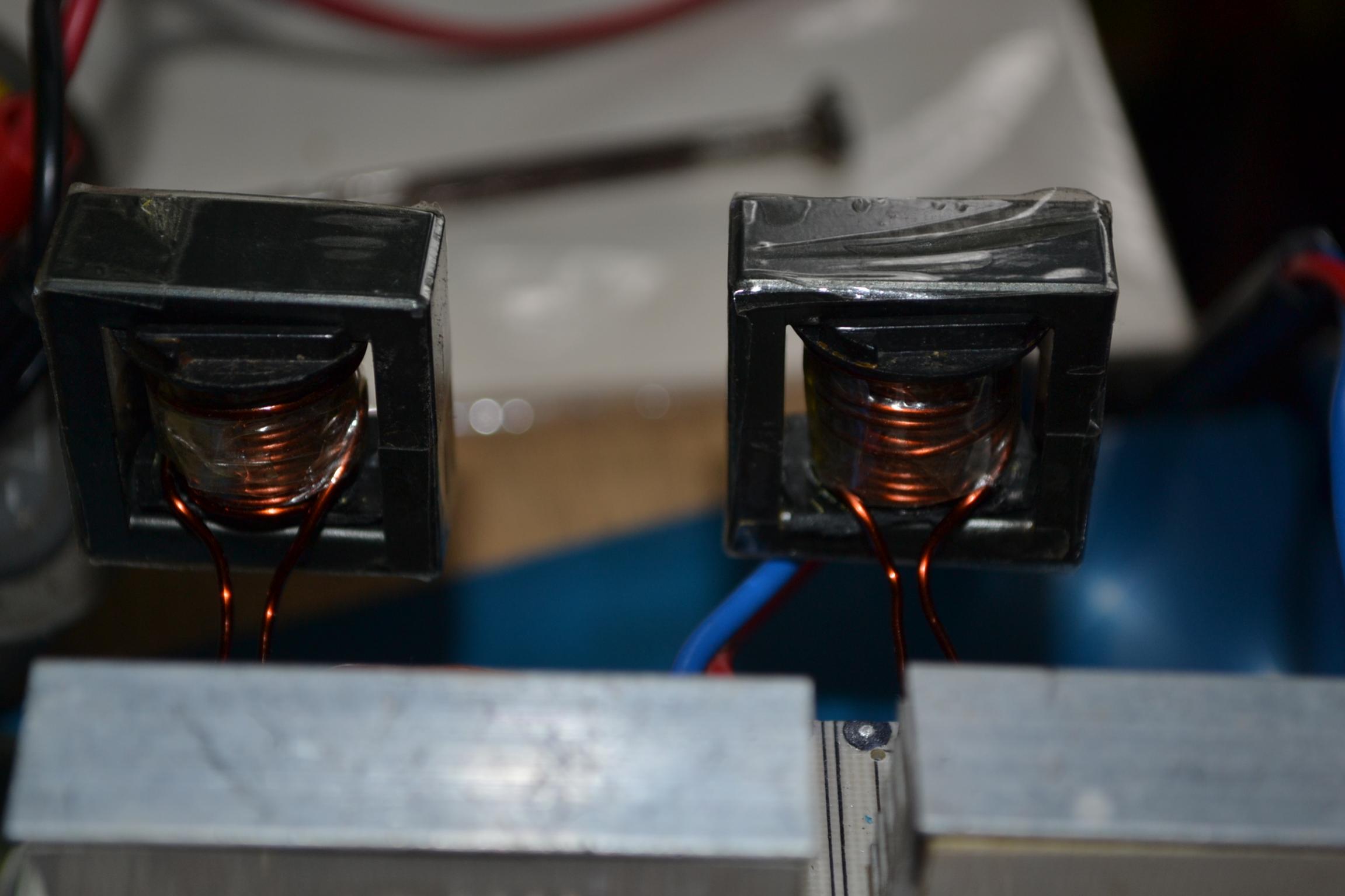

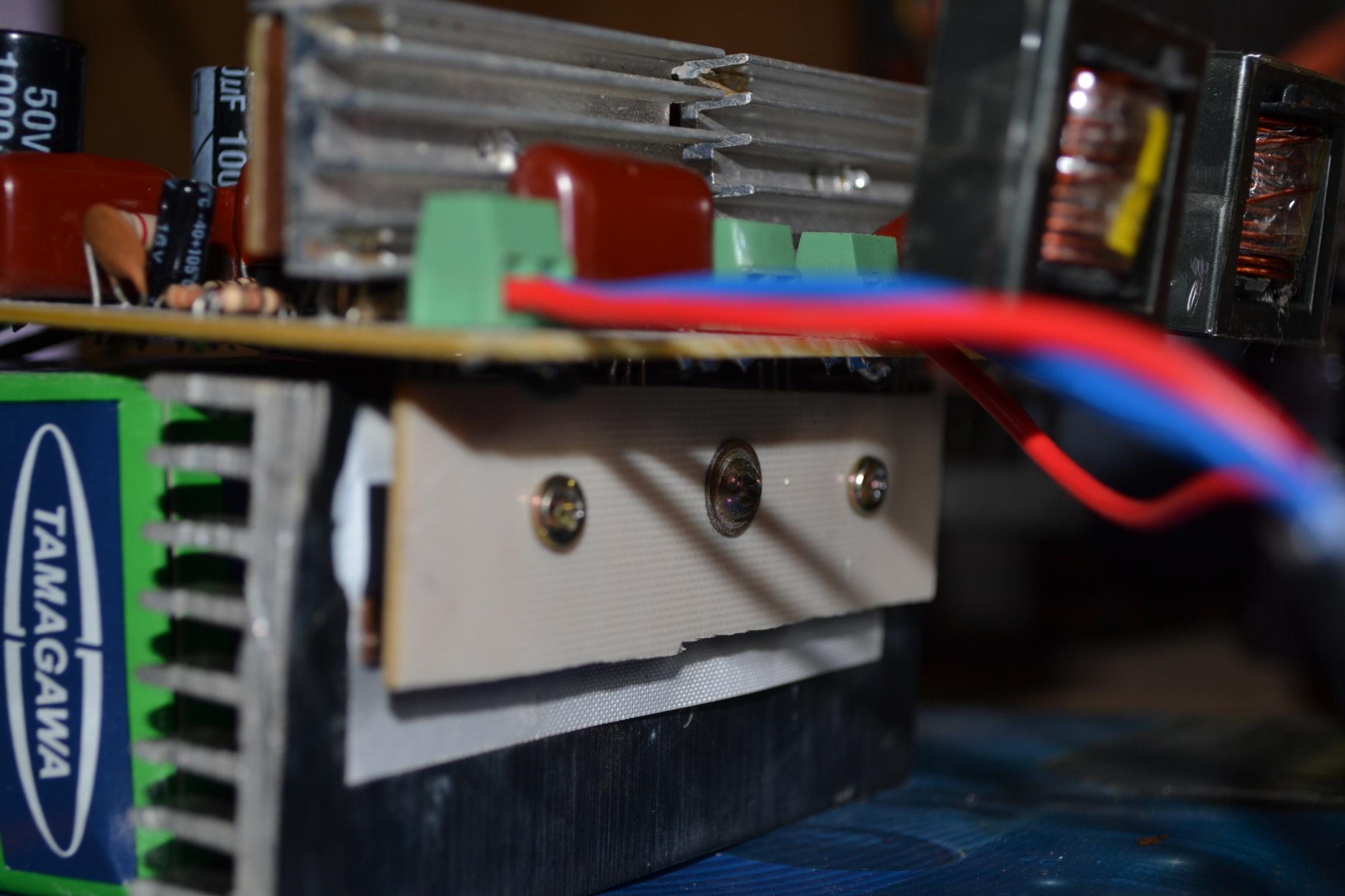

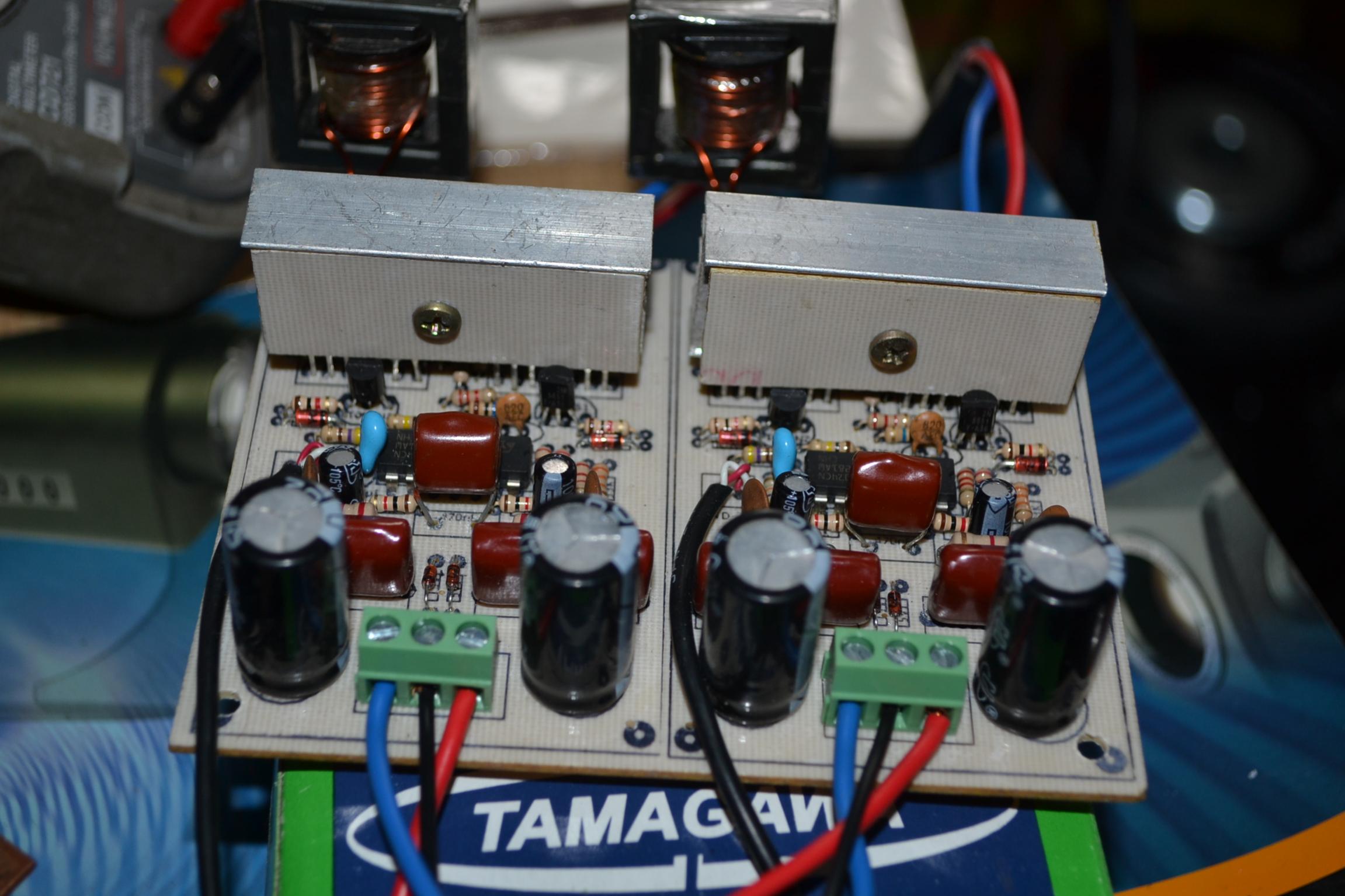

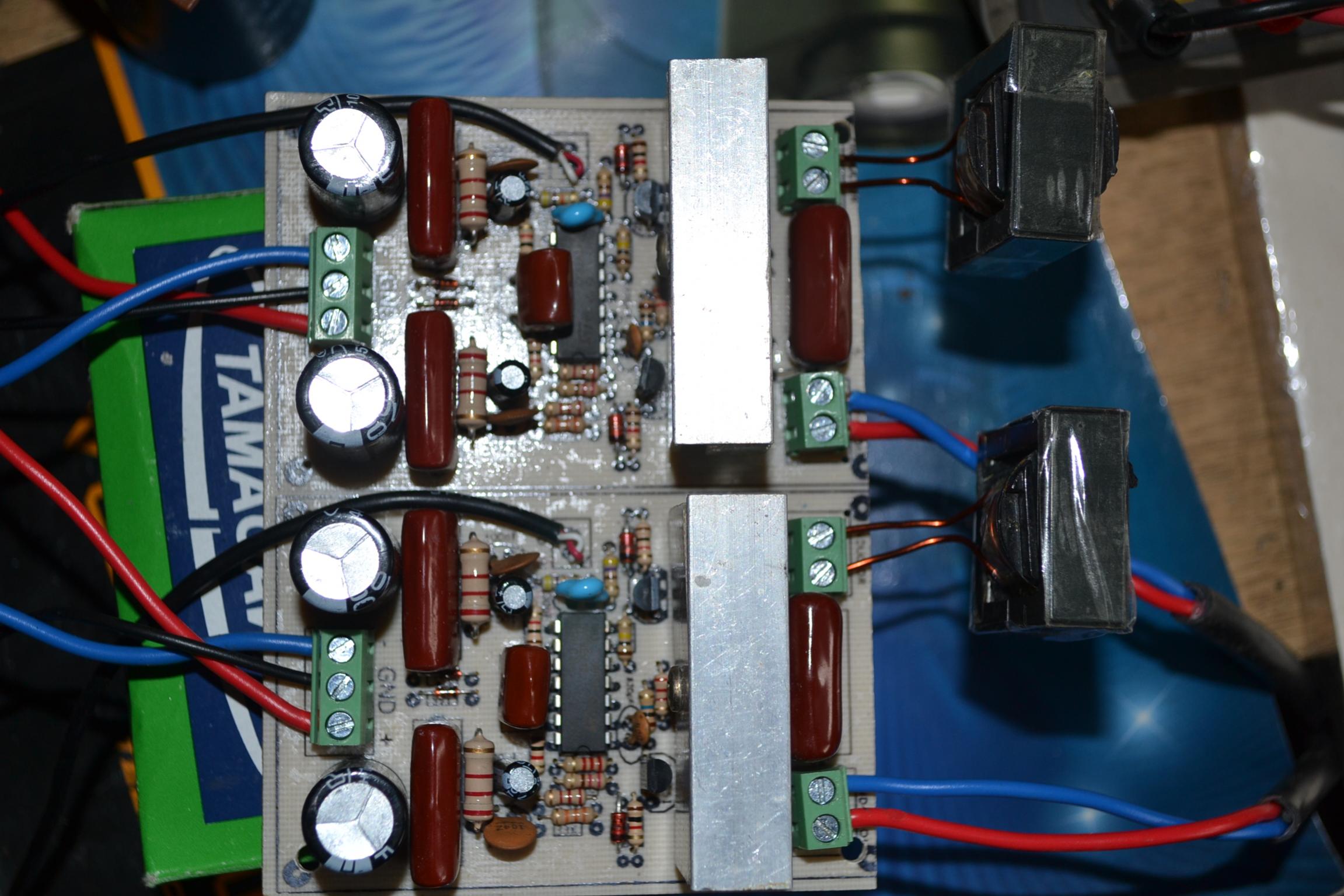

pwm with EE core
update outputs are warm coil not heating up good result loud and clear output filters used 2 uf idle current 8mv dc
