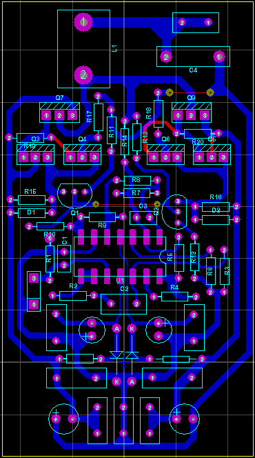

My guess - for some reason MOSFETs are not switching properly e.g. there is less than 10V peak at MOSFET gates. What kind of zenners did you use?

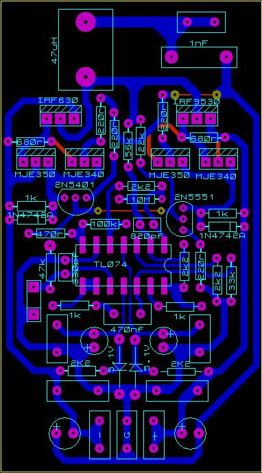

here is my component value.my supply voltage is +/-43v DC.
the zeners are 5.1v for tl074 supply and 12v parallel with 1k resistor.
i use similar MJE340-350 instead of BD139-140 but there is no difference.
also i change irfp630-9530 with irfp540-9540 but nothing change.🙁
However my simulation on proteus works right and initial PWM is stable and change right by input signal.🙄
LOL, rezamir ur output filter cap is 1nf? correct it with 1UF @ 680nf. i`ll check others component not finish yet.

Rezamir nice board. 😀
please measure output offset, voltage at gate for each mosfet, many have build this amp, so far no problem about mosfet heating fast as long as u not reach +/- 50. Did u try with BD139 and BD140? i`m suspect there something error with ur component please double check it at your board. i`ve check 50% of your board seems to be ok.
btw what is the red trace for? on your board have blue trace and red trace, double sided board? As i can see transistor gate driver at right bd139 abd bd140 or maybe ur using mje340. mje 350, R20 ro Q6 , there is touching trace with R18? please check it while it shouldn't .

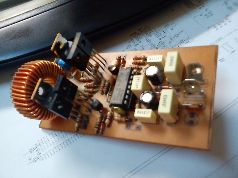

yeeeeeeees
it works, my problem was using MJE340-50 against BD139-140
now output offset is about 65mv (its not a little more than normal?) and sound is soooo cool.
Nice 😀 . its ok with output offset. did you measure inductance? I use 27 uh, even 22 uh will work nice. and filter caps 1uf 250vdc is good. will be lower the dc offset less than 30mv.
regards.
regards.
i use 20uh at first but output offset was more than 200mv! but now i use 46uh and its about 60mv.
there is no problem now but 2N5551 warm up a little. it seems has problem in this frequency (stable at 227khz). i think its better to change.
