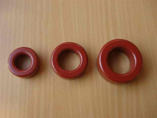

I got here a few sizes of T106-2 which one will suit best to the amp? I will be using +/-24VAC 6amp power trans.
Thanks!
T106-2 iron powder, u can make 30 uh with 47 turn and +/- 24 vac is good and no problem with that supply. For the EI ferrite core if u want u can dis-arm with boiling hot water about 10-15 mins, it will dis-arm itself or u can use thinner after boiling it.
