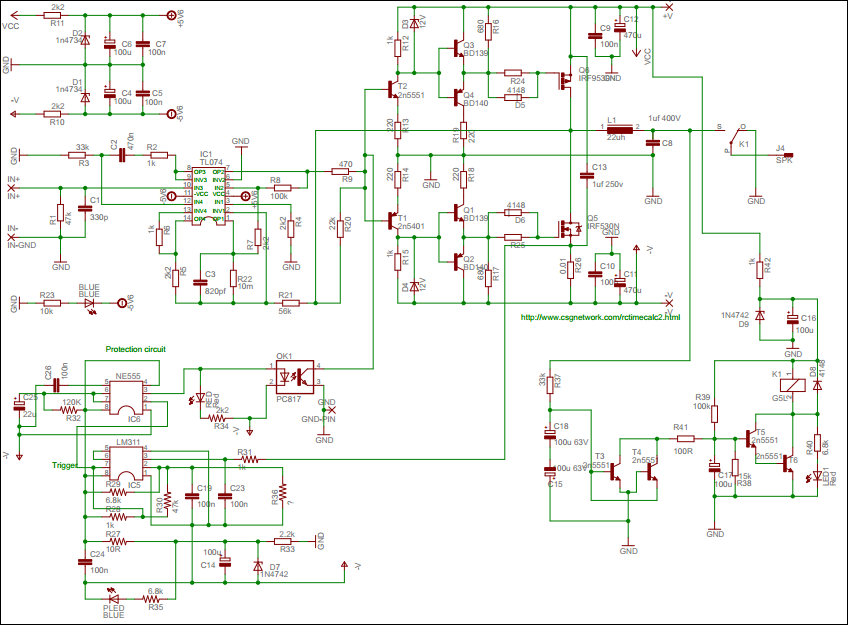

Nope, there's no sense in paralleling because cheap and easily obtainable P-Ch Mosfets are limited to 100V.
Here's my schem. It's not final yet.
I used parallel 2 x 0R1 5W because it's easily available.
13A flowing at 0.05W resistor has a dissipation of 8.45W so the current sense resistor rating is sufficient :)

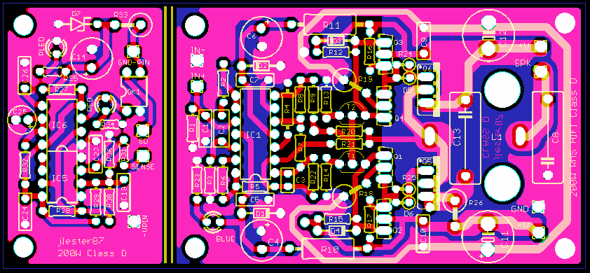

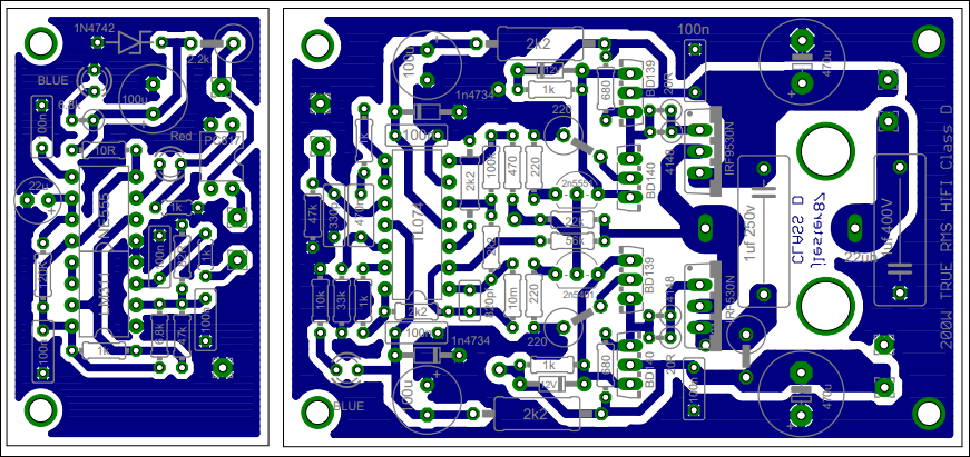

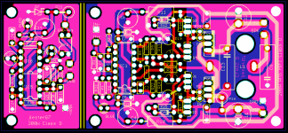

I decided to put the over current protect in a daughter board. No speaker protect too, you just have to use an external one.
The layout is very compact and uses no jumpers. :)

jlester, now move all the traces over to the top side to complete the ground plane and EMI levels should get lower as ground impedance gets lower.
Yes that one originally has ground plane on top but I didn't share it because 2 sided pcb is hard to etch and is not diy friendly.
Anyway here it is :)
