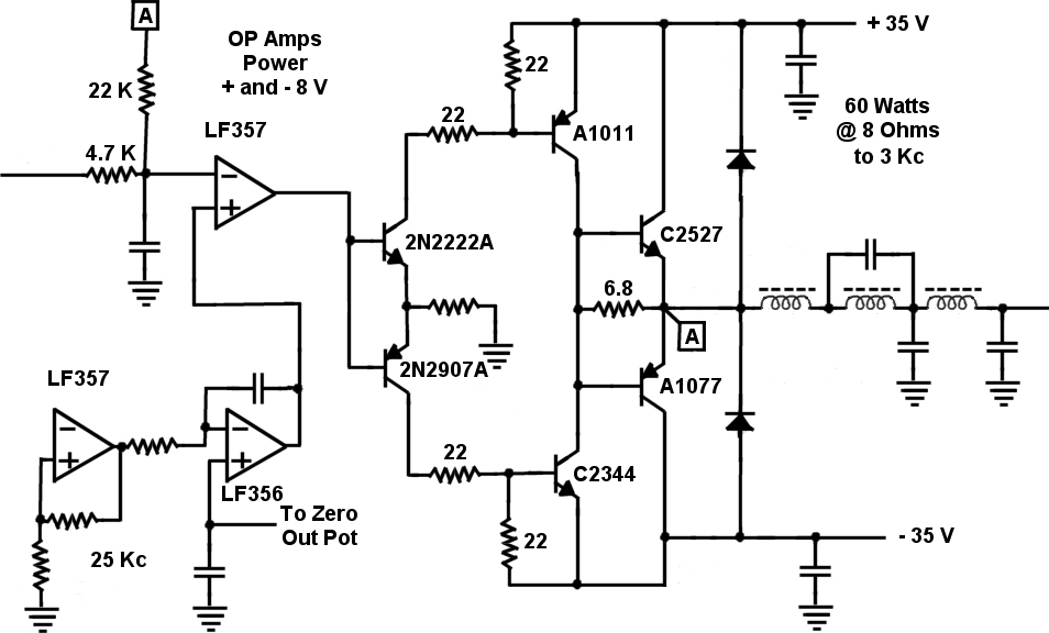

No Mos-Fet Class D

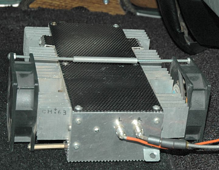

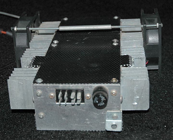

I made this from scratch over 20 years ago, and it is still working. Only good up to 3KHz but I only use it as driver for two 18 inch woofers. Finding transistors that would work for one for full range is probably not to be found.
by junk parts i mean tested parts,to make sure they are not broken.every transisor and diode is tested
What the user above posted is kinda the schematic type i want,but i want to use mosfets and more modern opamps

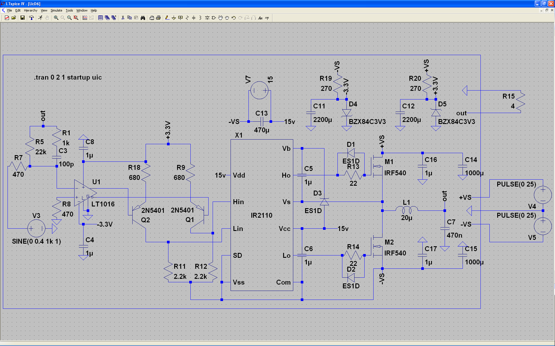

This schematic i posted is UcD ie post filter feedback self oscillating, V3 is the audio input.
Power you can scale to your liking by choosing rail voltages and mosfets accordingly.
My current setup has one channel running at just shy of 500kHz and the other channel around 600kHz, rail voltages are currently 2x22VDC and i'm using IRF540 mosfets salvaged from a scapped project, the gate drive is a IR2010 and the comparator a MAX913.
nice! but i am afraid im not going to build this without a pcb,and im also scared i cant find those awkard diodes,not even in shops,but i will give it a try once i have the pcb!

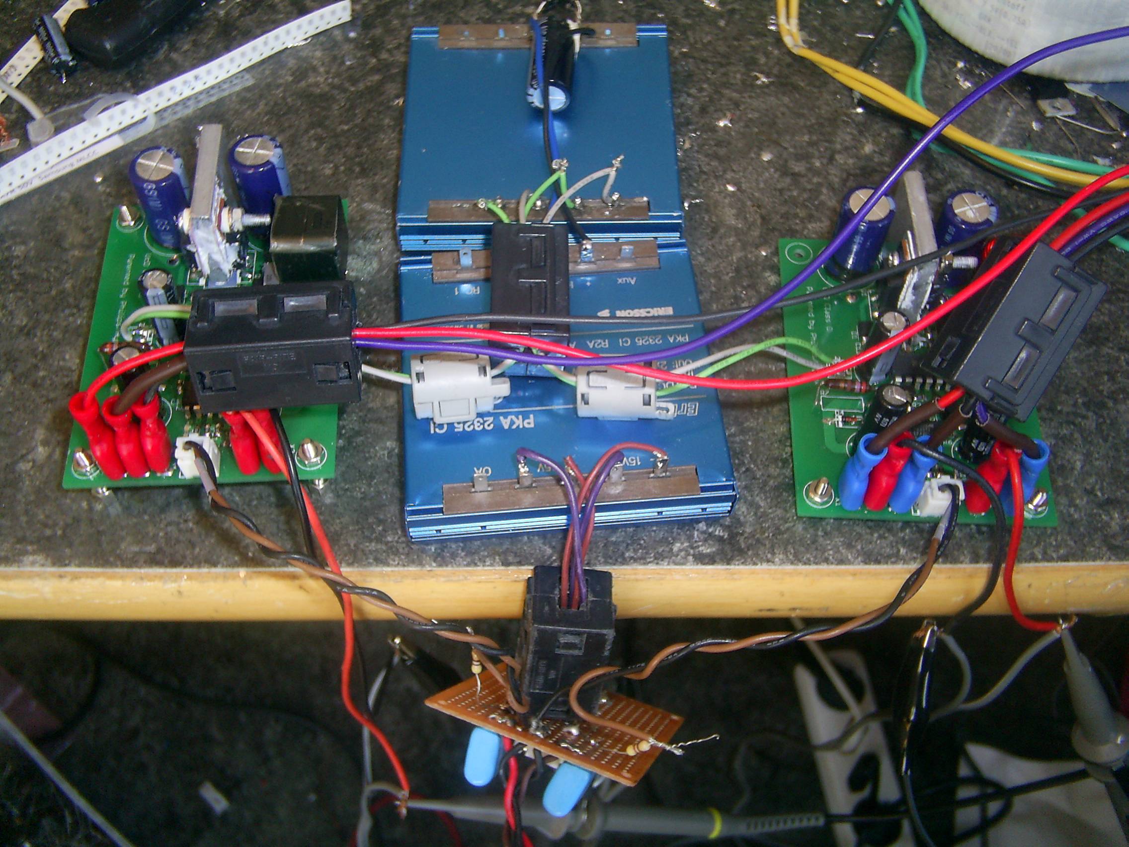

I only have a preliminary layout which is already posted in another thread, but as i have some EMI issues to deal with i cant recommend it, quite frankly i shouldent have posted this project what so ever until i had the EMC stuff fixed, tested, passed and behind me.
I also need to drop the noise floor quite a bit assuming it is even possible, im gonna assume -60dB is a level noticable throughout a livingroom considering thats where you'll find 0.1% or was it 1% THD.
