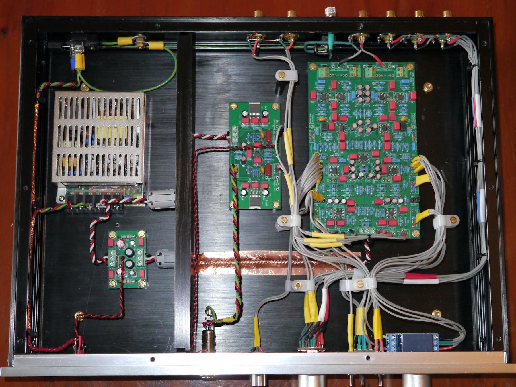

Only hiccup I had was self inflicted, I put the SE/BAL jumpers in wrong, and had a really badly distorted/low output initially. Once I fixed those, I was in business.
I subbed the OPA1642s for the OPA1656s in the warp filter because of the latter's unavailability. To my untrained ear, they seem to be working well in the role. I still have the 1656s on order (Mouser is still saying mid April) to install when they show up.
I'll go take some pictures in the next day or three.

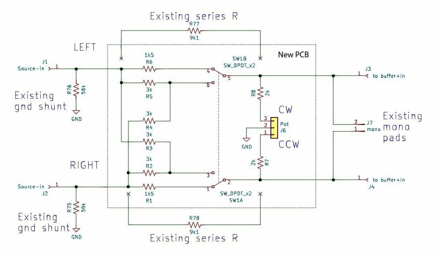

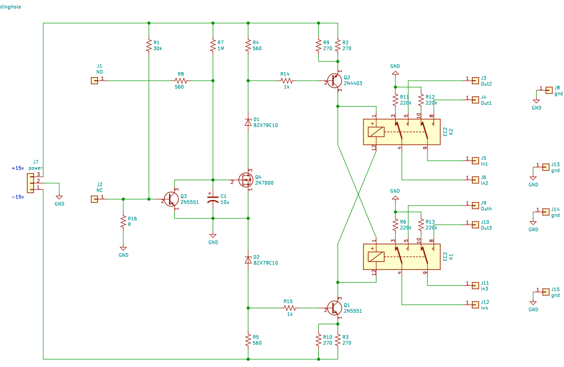

Two new mini add on boards have been constructed to provide more functionality- a mono/balance board where the functions operate concurrently with the same range/law as before, and an output relay board that delays the output turn on by c. 2s after power up, only allows output signals when the supply voltage exceeds +/-12v, will automatically mute/unmute when a headphone is inserted/removed from the headphone socket, and will allow for switched mute/unmute.
A v3.0 board with these functions built in is under consideration.
Any interest?
Any interest?
Any interest?
In a v3 board, no. I'm only just getting together a mouser order for the V2 (using the Mouser carts listed in #48) I purchased last year (don't ask). But mini boards? Yes, I'd take a set to add to my V2.

The relay board can have one or two "stereo" relays. If only one is chosen a 270 ohm R should be removed from each leg.
For 10v minimum operation the zeners should be dropped from 10v to 5v or so, and the relays will have to be a lower voltage- 12v rather than 24v.

He was the one that requested the modified mono/balance and output muting relay functions.
Perhaps the two of you should get in touch (@CV1040 is his moniker) to arrange to get some of the add on boards made as at this time there is insufficient demand for me to have a set fabricated, although there will be Gerbers available.

Steven, any help I can provide let me know? I'll be an early adopter of the add on boards too – as soon as Wyn and Sean (PCB guy) have them available.
Inspirational V2 MC c/w HP amp build picture attached.
