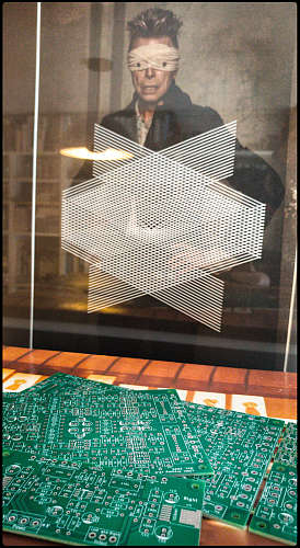

I would definitely be interested in the v2.0 PCB - possibly even 2 off. If there are a few people down south here who are interested, we can have the PCBs sent in a single parcel via Aramex Global shopper - fixed rate for below 500 grammes.

As for purchasing boards, please PM me with details as I am about to place an order and it's currently fully subscribed so I will need a commitment to increase the quantity, and as the boards are sold at cost having potential buyers back out is not good.

Hi Wyn,
The PCBs were delivered just after 5pm this afternoon. Ten days from Aramex NY to SA including customs clearance and delivery. I have a whole bunch of resistors arriving tomorrow, and then I am going to start populating two RIAA boards - a tube based one (BigBottle JFET/Tube) and yours. Unfortunately I will have to wait until the end of January to order the opamps.

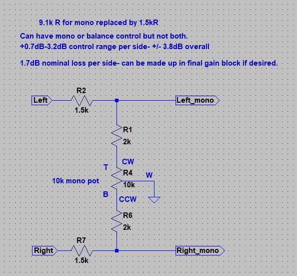

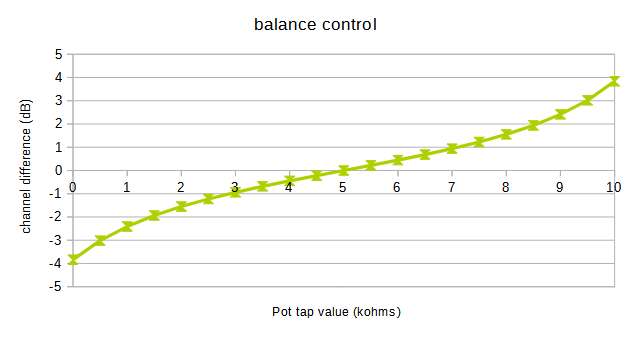

A new feature- a balance control with +/- 3.8dB of adjustment has been added to the line stage due to popular demand.
The builder can choose to have mono/stereo or balance control, but not, presently, both.

BOM for the balance function.
Access to this page has been denied.
An additional add on board is required, or the user can manually wire the components.
Note: the 1.5k and 3.6K Rs replace R77/78 (9.1k) and R83/84 (5.11k) in the original line stage.
The balance board is assembled and wired between the Left mono and Right mono pads- left to left and right to right. Mono will still work, (i.e. a switch can short left mono to right mono) but it will disable the balance function if activated.
