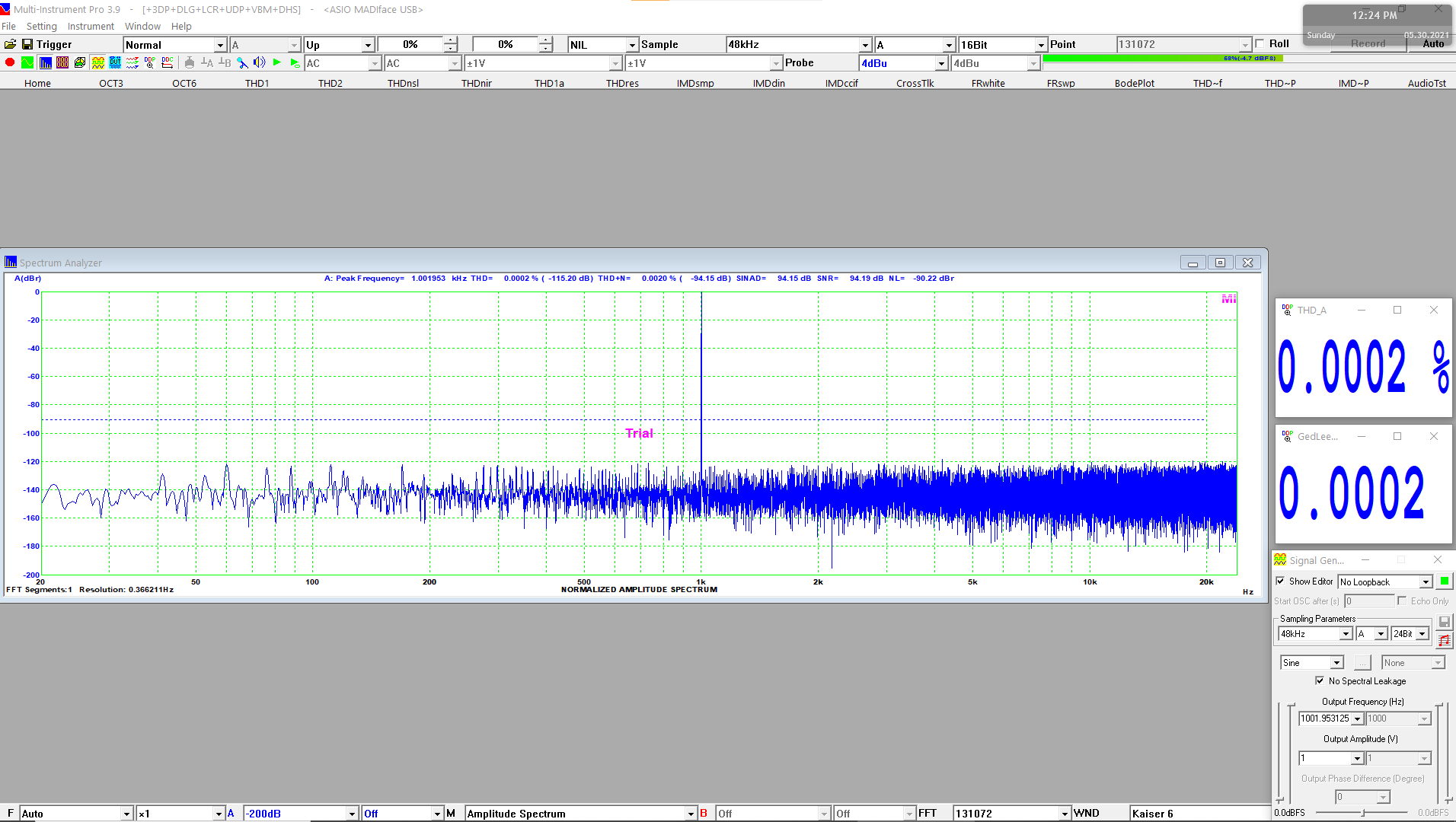

I am testing out a new piece of software to go with the RME box so that i can make some measurements that I cannot otherwise make- Virtual Instrument (Virtins).
Below is a THD/GedLee metric measurement of the post phono stages in the preamp (warp filter. buffer, passive volume control, output buffer/amplifier, plus the RME DAC and ADC.
The output signal is 1v rms, and both the THD metric and the GedLee metric are identical, which means that the measures that I took to ensure that the levels of high order non linearity were acceptable was successful.
The same result applies to the phono stage itself, except the noise is much higher and the result is less impressive.

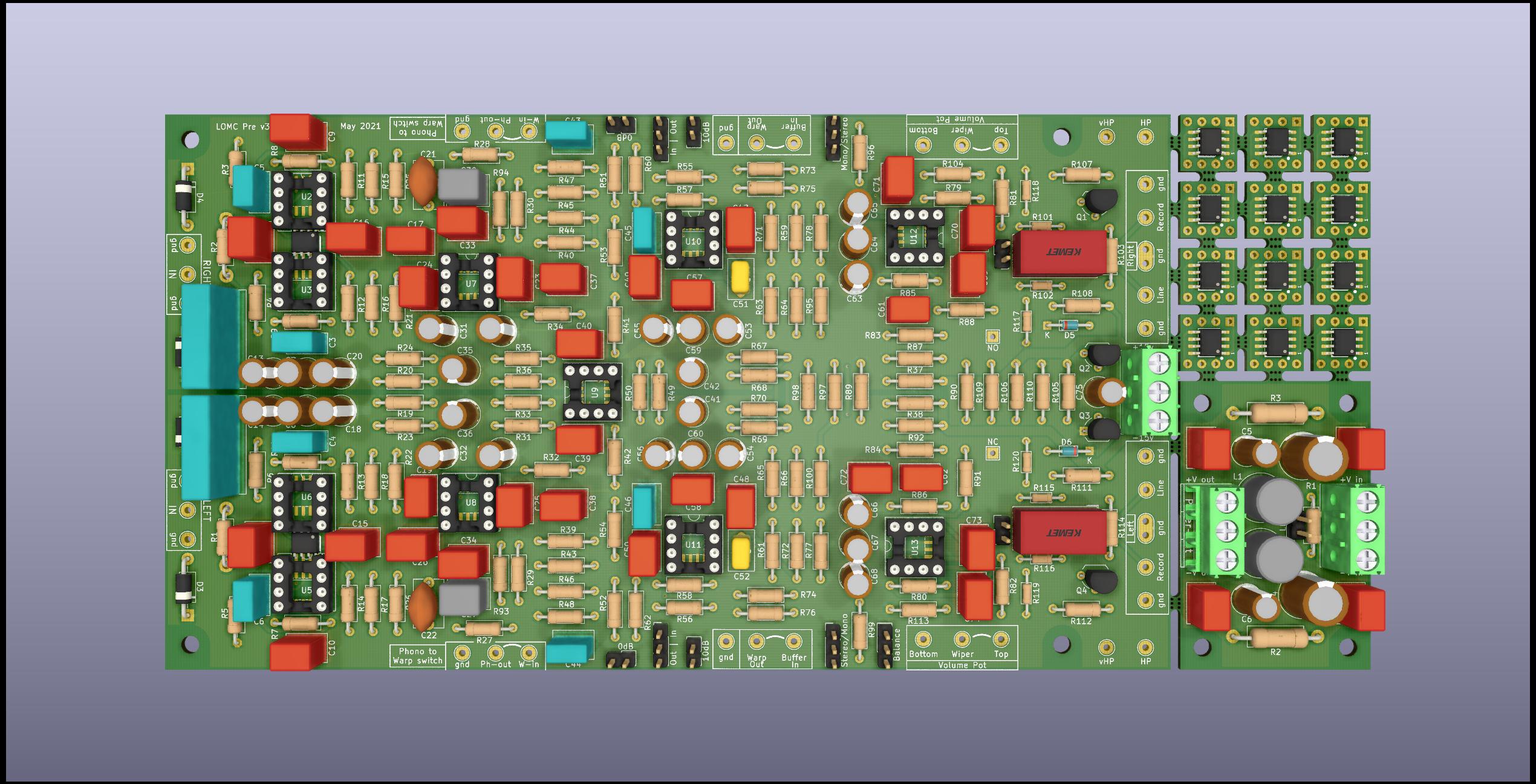

In case anyone is interested the latest batch of boards- v3.0-, 18 in total, are almost all gone.
Only three remain.
Only three remain.
There will be a small revision to the next board order, making it v3.1.

Due to the kind generosity of a DiyAudio member there are now v3.1 boards enroute.
There will be at least 8 available at a substantially reduced cost due to his support.
