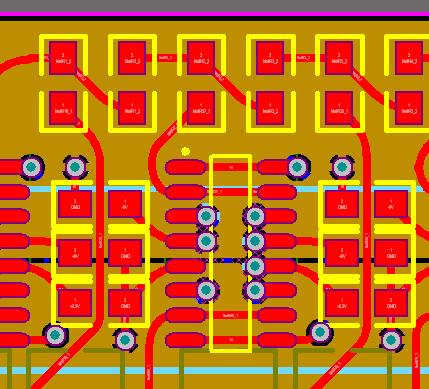

Finally, I collect enough information to design such a REAL R-2R attenuator.
Fully balanced attenuation through 16 bit R-2R resistor network.
65535 steps current attenuations available, two Ultra low-noise low distortion OPAMP AD797AR were used as I/V convertor, the same structure as the module in Mark Levinson's No.32 ^_^
Considerate LAYOUT, 4-LAYERS PCB with 2 Oz copper,thanks Mark ^_^
Considerate POWER MANAGEMENT, onboard ultra-high performance linear regulator
High-precison SMT chip resistors
Simple data interface for micro controller
dimension:5545mil*2135mil
current switches: DG413DY, ultra precision analog switches
I/V convertor : AD797AR, ultra low-noise,ultra low distortion OP from ADI
Onboard regulator:LT1355
Resistors : YAGEO RT series @ 1% tolerance
The PCB will arrive next week, I will assemble the whole module and test then.
Anyone interest in it? ^_^

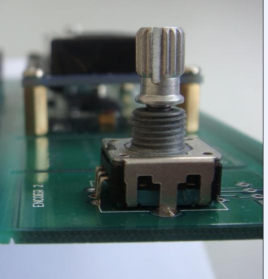

Hi,how much pulses per resolution must have optical encoder?032,064,100,125 or 128 pulses?Which ic drivers can i use for incremental encoders?
Hi rishard,sorry for the lately reply
I use general rotary encoder in my application, as I know, the pulses of resolution is not the matter for most application

Hi bbp,thank You for answer.I have last question for my project,can you show me other layers of PCB with DG431DY,not only TOP.I need this know for a objective view how this cicuit work.I think this is best of the the volume-controls.Hi rishard,sorry for the lately reply
plase refer to the close look at analog switches

Hi bbp,can You show BOM file?How function have T1 and T2(5D-BC807)in this circuit,emitors from this transistor`s is not conect?perhaps each module will cost $150,I am working the BOM file out with pricing.
each module can only be configurate as a fully balanced mono channel or stereo single-end channels
I think 0.1% resistors is the best choice for this module, althogh 1% tolerance is enough for the project, but the highly cost for the resistors is really a problem.
I got only 1%/50ppm low noise chip resistors for the evaluatetion board at the moment
the next step is to assemble the module and get a highly authentic testing result by AUDIO PRECISION SYSTEM TWO
regards
bbp
sorry rishard, I can't show you all the information of my project >_<
the T1 and T2 here is used as a diode
O.K. i understand You,it is possible send me two pcb boards without materials,only with BOM file,i work on different mcu section with two incremental optical shaft encoder like M.L.(ELEKTROSWITCH SERIES 900) and the steps i want use only 80dB range,from -80dB to -57dB with 1dB steps and -57dB to 0dB with 0.1dB steps,further i can use the wery nice 7x5 dot-matrix display PD4435 (3pcs in cascaded multidisplay operation) etc....If it`s possible sending to U.K. or Eu drop me the prise,regards rishardsorry rishard, I can't show you all the information of my project >_<
