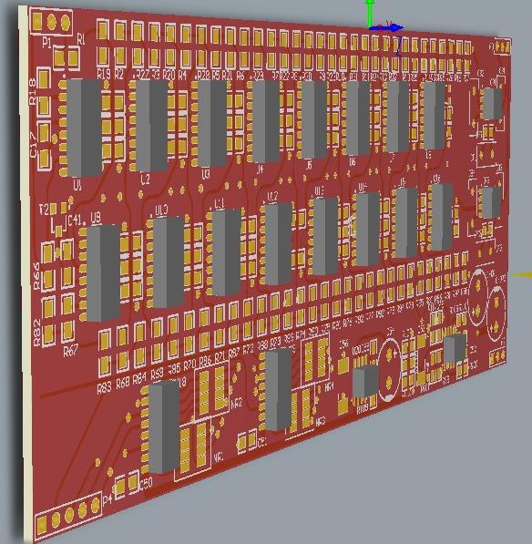

Ultra high precision Volume module like Mark Levinsion's
Finally, I collect enough information to design such a REAL R-2R attenuator.
Fully balanced attenuation through 16 bit R-2R resistor network.
65535 steps current attenuations available, two Ultra low-noise low distortion OPAMP AD797AR were used as I/V convertor, the same structure as the module in Mark Levinson's No.32 ^_^
Considerate LAYOUT, 4-LAYERS PCB with 2 Oz copper,thanks Mark ^_^
Considerate POWER MANAGEMENT, onboard ultra-high performance linear regulator
High-precison SMT chip resistors
Simple data interface for micro controller
dimension:5545mil*2135mil
current switches: DG413DY, ultra precision analog switches
I/V convertor : AD797AR, ultra low-noise,ultra low distortion OP from ADI
Onboard regulator:LT1355
Resistors : YAGEO RT series @ 1% tolerance
The PCB will arrive next week, I will assemble the whole module and test then.
Anyone interest in it? ^_^

If you have 65535 steps and an R-2R ladder, you need far better than 1% tolerance resistors. You need 0.001%. I've no idea where you'd get such things.
we don't need such high precision resistors up to 0.001%, 1% is enough in this application. even though, Mark Levinsion's product uses 5% resistors in their module in No.32, 1% resistors in No.320s/326s ^_^
We don't need a tolerance = 1/65535=0.00001526 in each step, just think about the R-2R DACs like PCM1704U-K ^_^

You might not need 0.001%, but you do need better than 1% if you want to keep the errors down and make the accuracy reflect the precision. I'm assuming you don't actually make all those 65535 steps available to the user, but actually code for a logarithmic law and pick codes that give 1dB steps. At 6dB of attenuation, 1% resistors give an uncertainty in attenuation of 1.4%, and between channels of 2%, or 0.2dB. Stepped balance controls typically go in steps of 0.25dB, so those 1% resistors could cause balance error of one balance step. I don't see that a stepped attenuator is entitled to any balance errors, so whilst 0.001% isn't necessary after all, I think you need better than 1%, and 5% is certainly not good enough.
Of course we don't need all the 65535 steps in the actual application,I plan to make the attenuations adding 0.1 dB/step from -96dB to -46dB and 1 dB/step from -46 to 0 dB.
That means I need to calculate the relationship for decimal/dB >_<
For the tolerance, 0.1dB is equal to 1.14%

No, I'm afraid your calculations above are incorrect. A 1% error would mean that the attenuation was 0.99 or 1.01 of what it ought to be. Further, 10 log is for powers, but potential dividers deal with voltages, so we use 20 log. Taking the 0.99 case, 20 * log(0.99) = -0.087dB - near enough 0.1dB.

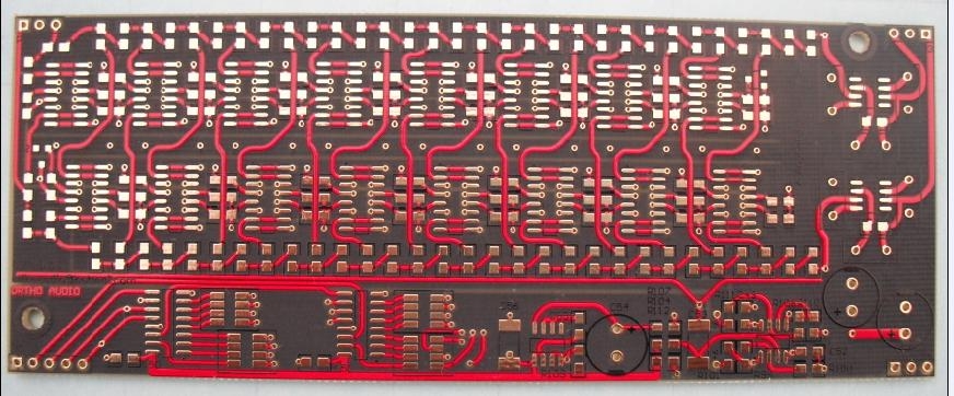

Looks nice! I like the color, when are you going to start the project ?
well, the main components of the project will arrive this two days, I can assemble one or two module and send them to have a Audio Precision Test.
then, I will start the software for MCU part.
maybe a simple LCD1602 and two rotary encoder will be added to the MCU part
a female board is needed,if we want to configurate the module as a preamplifier, which provides DC supply +/-15V and 8 or more signal relays for the input source selection
