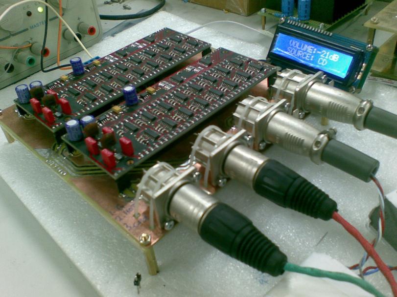

For the MCU control part added,FEMALE BOARD added,source selection added,and I need more than 3 hours to assembled one module, more than 2 hours to assemble the controller board/female board ... ... >_<

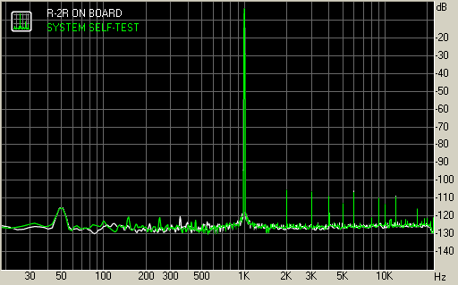

FEMALE-BOARD designed for AP TEST only

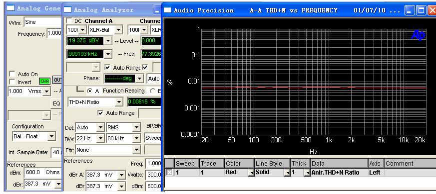

RMAA pre-test result, green line is the equivalent THD line and the white is the test result of R-2R MODULE ^_^
Looks good, Are you able to hear any or see any thing on your scope when changing volume level ? ( ticking or poping )

Yes, the display is optional, when you need it
the MCU part is just a prototype design this moment, it still needs modify and run fully test
I test the performance of hearing/sound quality, the sound is clearity,not any pot clik happen when I change the volume status
I will send this module for a AP test today or tomorrow
THD VS FREQUENCY

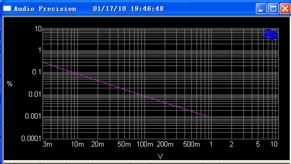

THD VS AMPLITUDE (input range 3mV~8mV,the module gives -20dB attenuation)
reference No.32's mark test by stereophile
The module archive ultra-high performance indeed ^_^

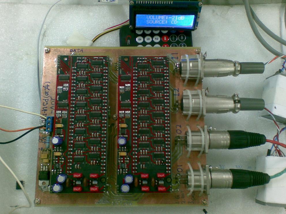

Yeah, it is a R-2R ladder with 2K0/4K02 resistors, I was about to make a 24-bits resolution R-2R ladder in last month, but I find the PCB's too large even I start the project with 4-layers board.
16-bits R-2R ladder will provide a max attenuation of 96.33dB, 24-bits will give a 144dB attenuation ! I think 144dB is a ullllllltra-high dynamic that we do not need such a precision contorl actually ^_^

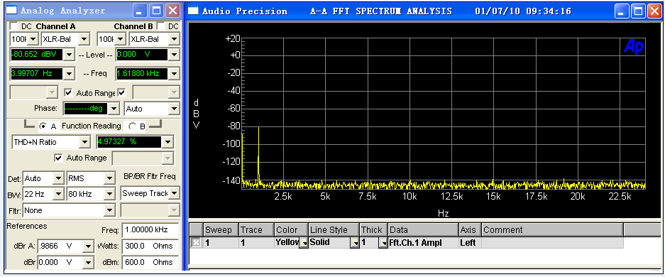

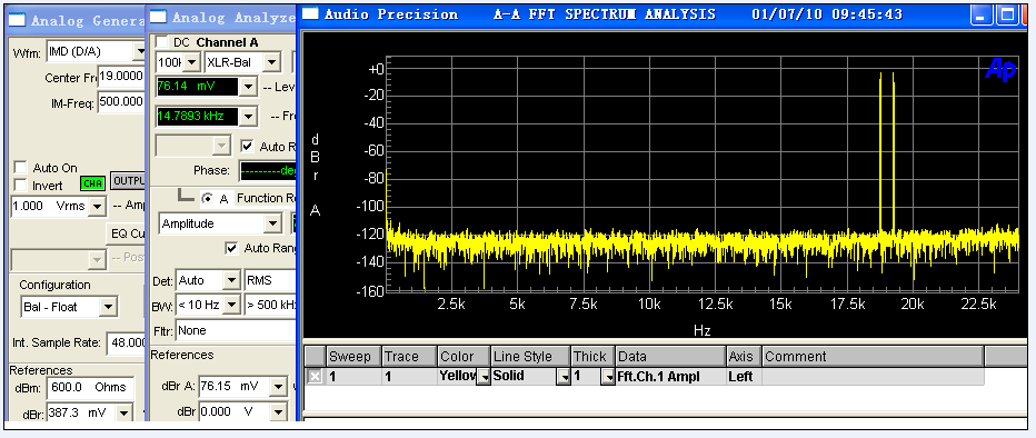

after I finish the LAYOUT and soldering, the board was send for AP test.
From the measurement mark, I know that this module is something useable in my DIY project,because the mark is better than PGA2310PA from TI, which single chip was used in many HI-END equipments.
I was doubt that if the module can archive a close performance with PGA2310PA in the days I didn't get the measurement result, considering the PCB is a 55mm*145mm 'huge' guy and PGA2310 is only a single chip. more area of the PCB, more noise atactive/senstive.
