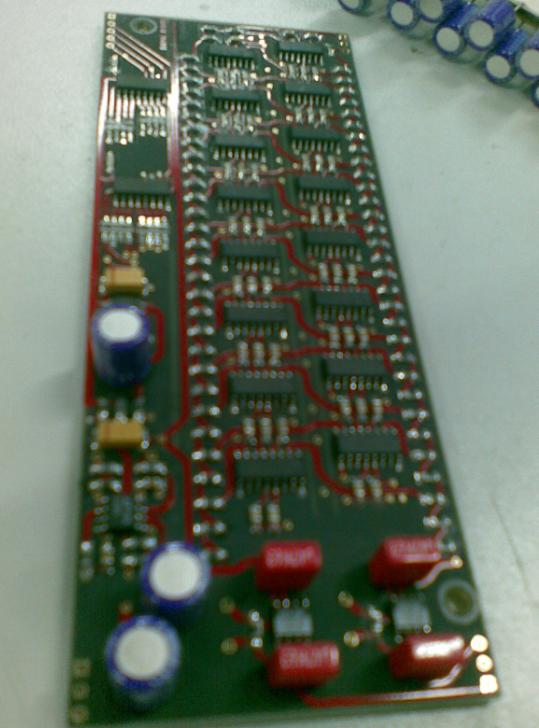

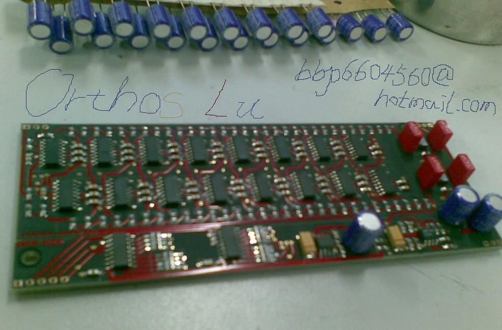

Assembled !!!
One module assembled
It took me 3 hours to do this job >_<
more than 700 pads solder needed, over 50 capacitors and 100 resistors with 0805 package and 18 pieces SOP16 ICs
it is not an easy job for me, but I fell so excited ^_^
regards
bbp

GREAT WORK! looks good, reminds me of the time i spend 7 hours on my 4 smd aleph a's took the time did it slowly 🙂 they turned out just perfectly like yours 🙂

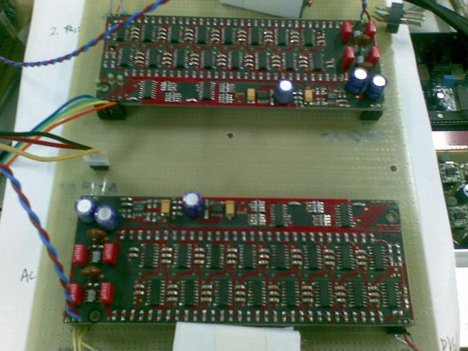

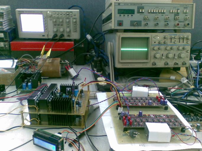

The project almost comes out, board assembled,MCU controller works well,RMAA TEST is pretty good
Now the module is runing with my new headphone amplifier ^_^
