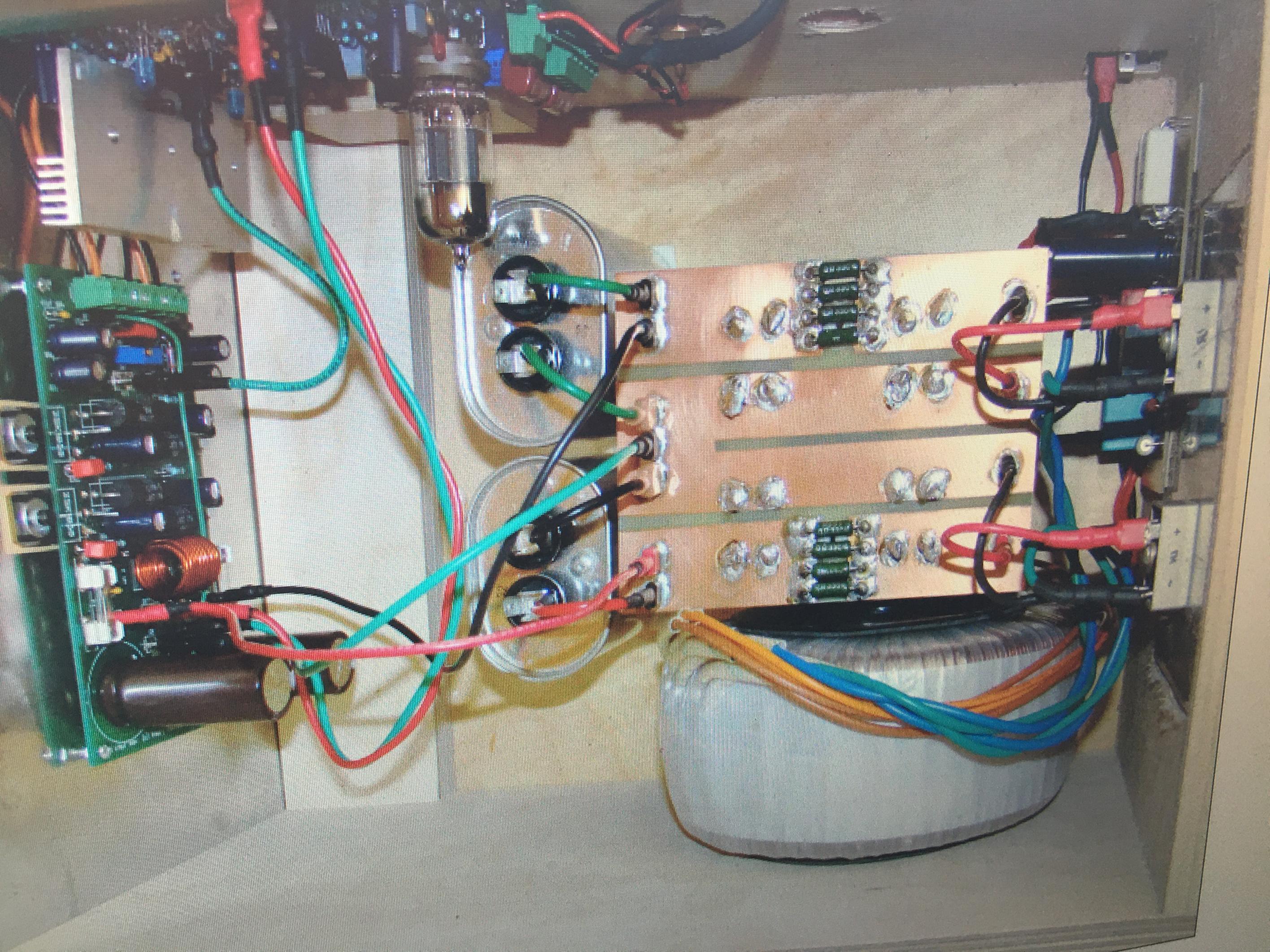

I was just looking at your connection diagram PDF. GND1 should connect directly to the power supply, not through the wire to the input end of the board. Speaker returns should also go directly to the power supply. The input end should either connect to the output end of the board or the power supply directly, one or the other but not both.
Grounding is very important to eliminate hum. It can be tricky to get right.
Here is a decent picture of how I had the boards wired. Not saying it was the best it could have been but it was a quiet set up.

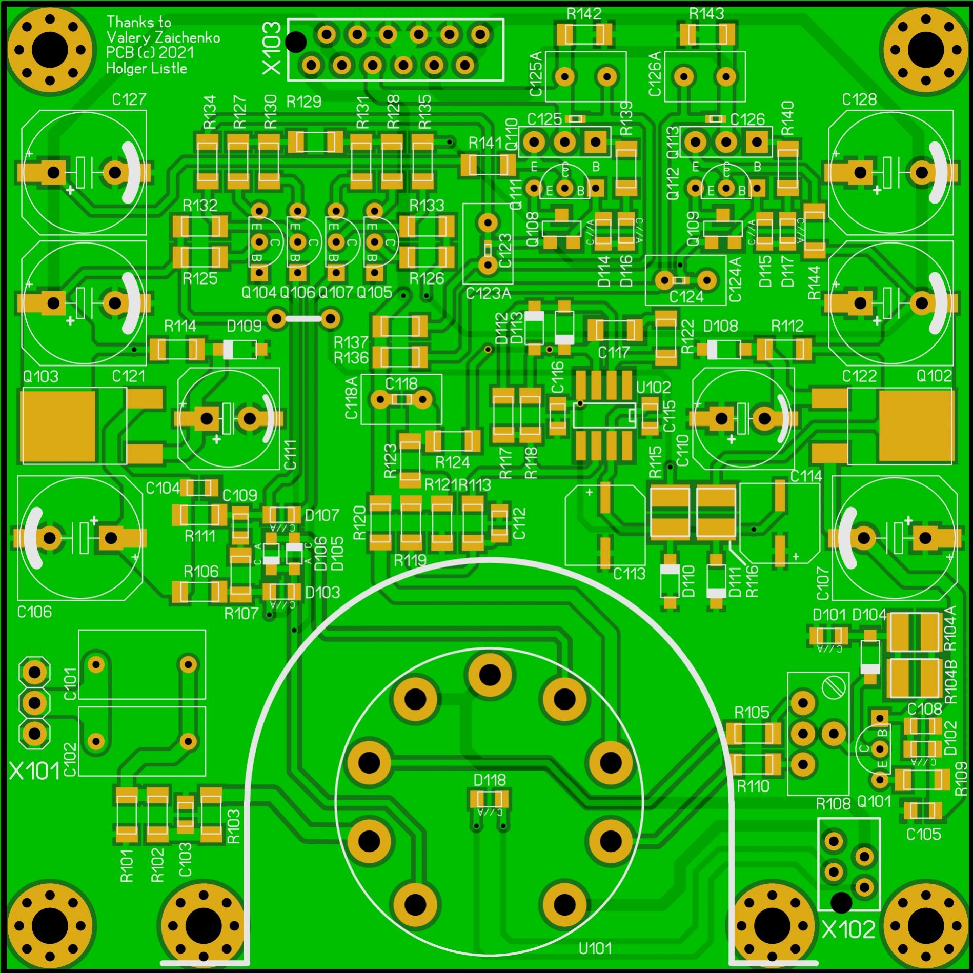

I started to prepare for a "Full Enchilada"-Build - TubSuMo + NS-OPS. The PCBs provided so far are a masterpiece of layout work - anyway I need to redraw them to fit some of my requirements. I started with TubSuMo IPS, which I wanted to be designed in a way that you can watch illuminated tubes through the enclosure's front panel 😀 In addition, I took the chance to give some options for the caps - I plan to assemble cheap SMD caps for first test and replace them with Nichicon KZs and Silver Micas for the final setup. Here's a screenshot of how my idea looks like - still a lot of checking and refinement to do:
I take the chance to thank Valery, Jeff and all the other guys to lead a great idea to an idiot-proof design. Once I finished IPS I'm going to start NS-OPS sim + layout with 4 pairs of ‎2SC3263‎/2SA1294 - it seems to be quite impossible to catch 2SC2922/2SA1216 these days 😡

Thanks, Jeff 🙂 Yep, I noticed the change to the Onsemi devices, but I'm curious about the impact on sound signature - did anyone ever compare the well-known smooth/warm Sanken sound to the Onsemis? I will try to find out and maybe I build both versions for 1:1 comparison with my sources and speakers - at least for me that's what counts 😀
Same applies for the tube selection, I have some old 12AU7 at hand and ordered some matched/selected for comparison. This is going to be fun!
By the way: Is there a condign SMT replacement for A992/C1845 available? I found SOT-23 variants (MMBT) for some MPSA TO-92 devices, but nothing for the Fairchild semis...

I've never heard any difference between the On Semi or the Sanken output devices, the distortion is so low in these amps it would be hard to hear any difference in output stages. You need to pay attention when first warming up the On Semi output devices though. They will blow if you let them run away, while the Sankens would just blow the fuse.
We've been using the FJV versions of 992/3324 as Rick suggests.
