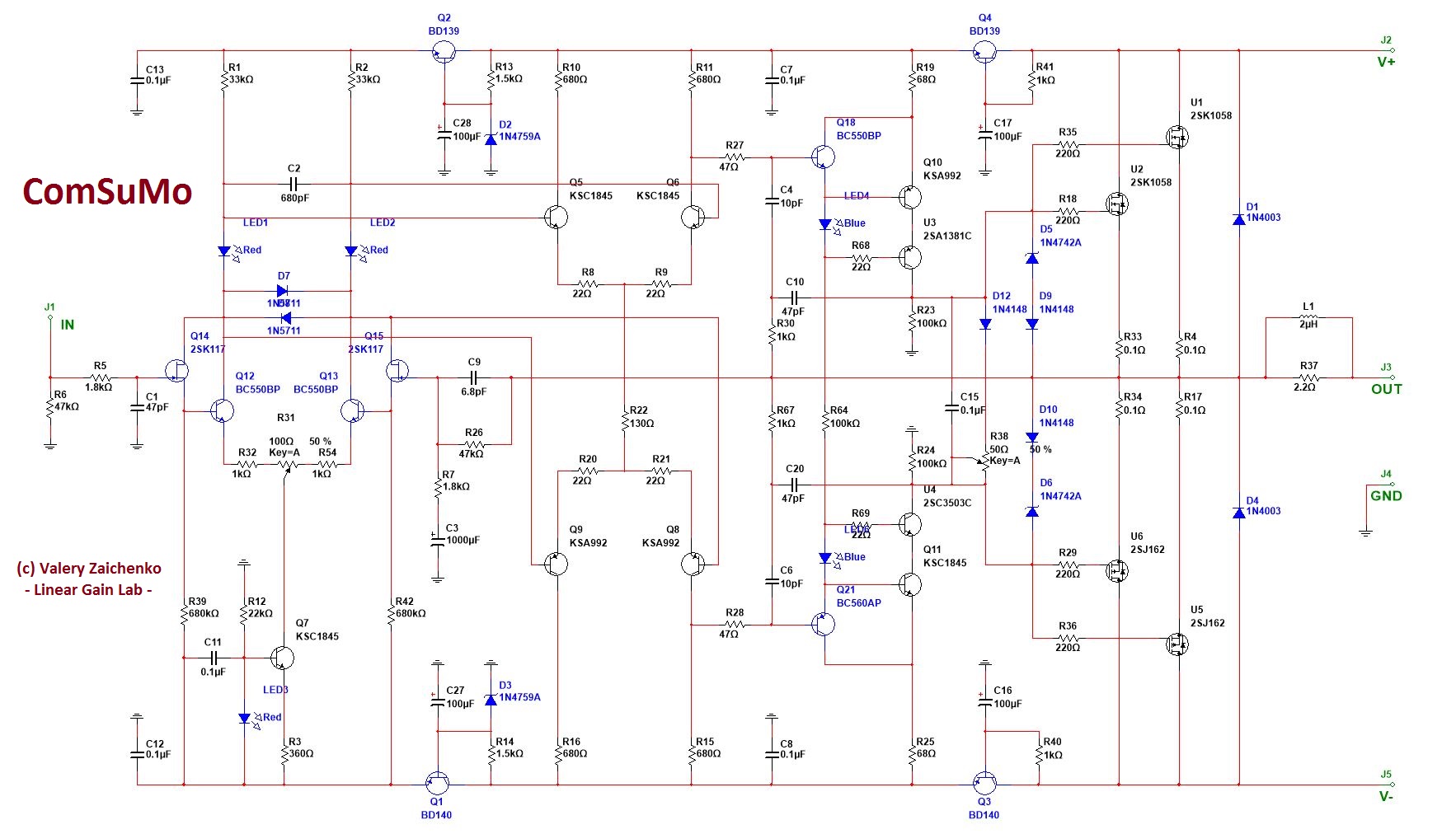

Can you please explain what ComSuMo option is? I really don't remember the design with such a name.
At the time of extensive testing in 2015 I have tried 3 input devices at the input:
1) Tube triodes
2) jFETs
3) BJTs
All 3 options worked very well, although my personal preference soundwise is tghe tube.
Valery
ComSuMo
Hi Valery,
Nice to have you back, assuming your and your family's health is good now.
I picked up ComSuMo from the start of this same thread, attaching a picture for reference.
Suman

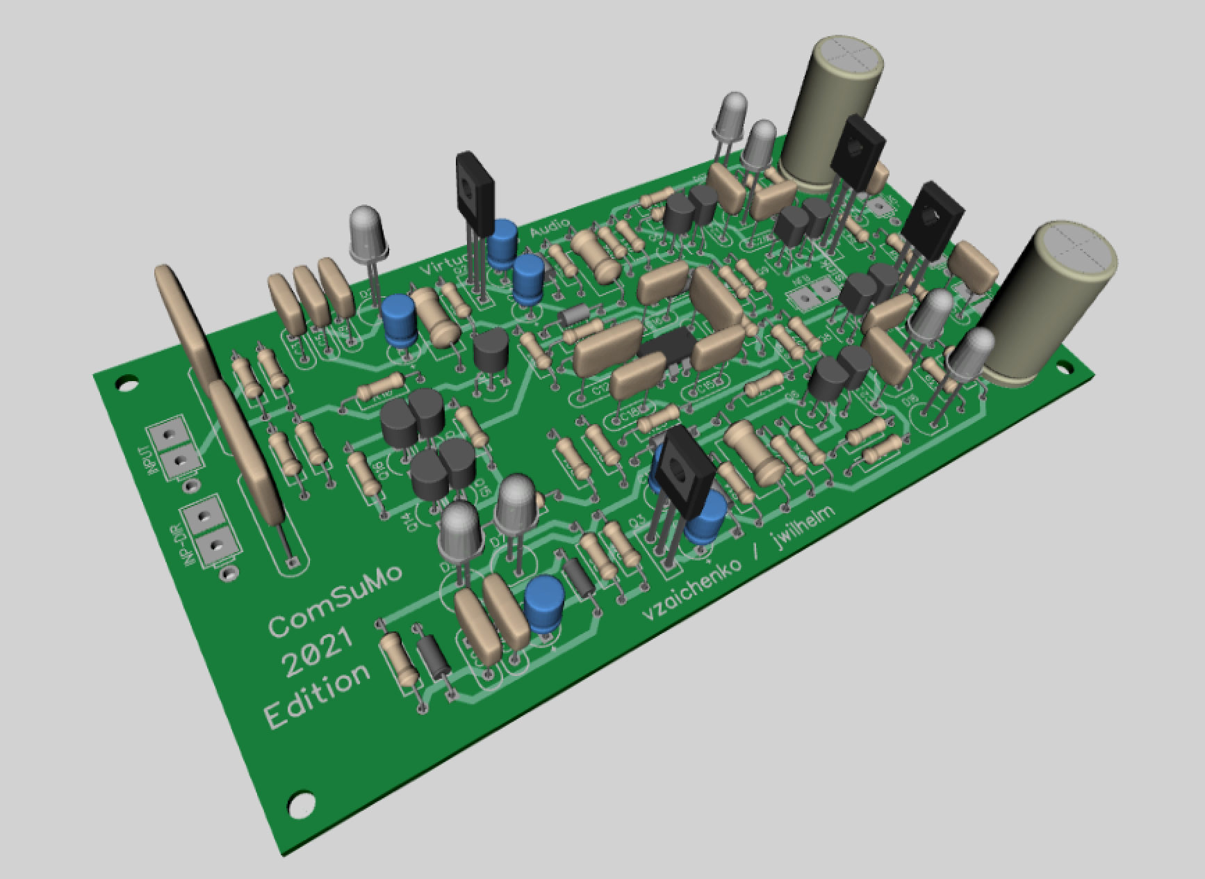

ComSuMo 2021 Edition
OK, here we go - updated layout with corresponding schematic and berbers.
These gerbers are not good for home etching - soldering pads are too small for hand-drilling.
No problem for manufactured boards though.
Valery
  • @01-ComSuMo-IPS-01_schematic.pdf
  • @01-ComSuMo-IPS-01_gerber.zip
Hi Suman,
Answering your questions:
- Yes, matched pairs in all the BJT LTPs will be an advantage;
- No, matching between BJT & FET is not required; also, the pair of FETs at the input does not require matching (followers);
- Optimum rails right now are +/-50...55V DC;
- You can use it with Slewmaster OPS no problem.
Please let me know if you will have more questions ;)
Valery
