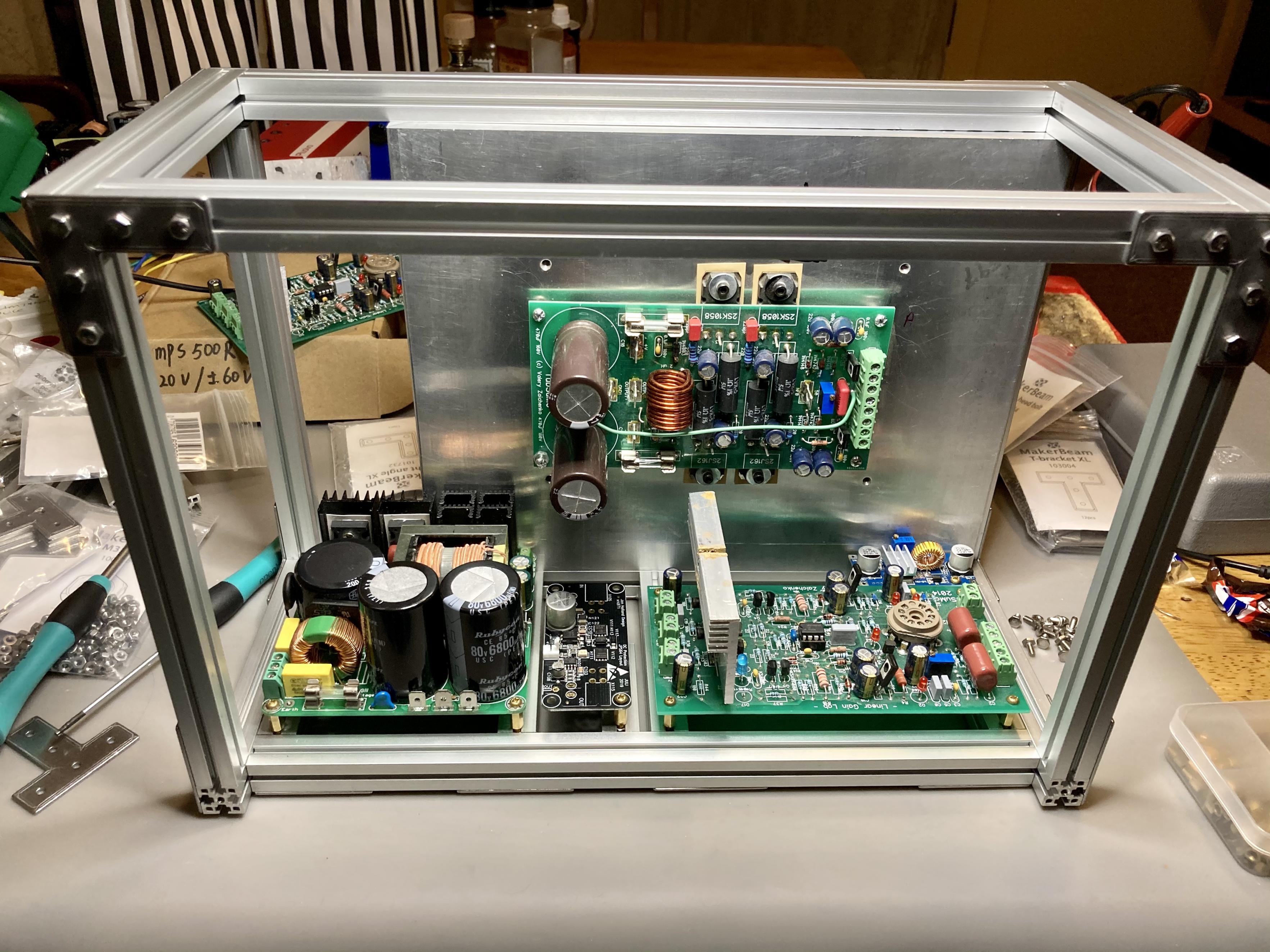

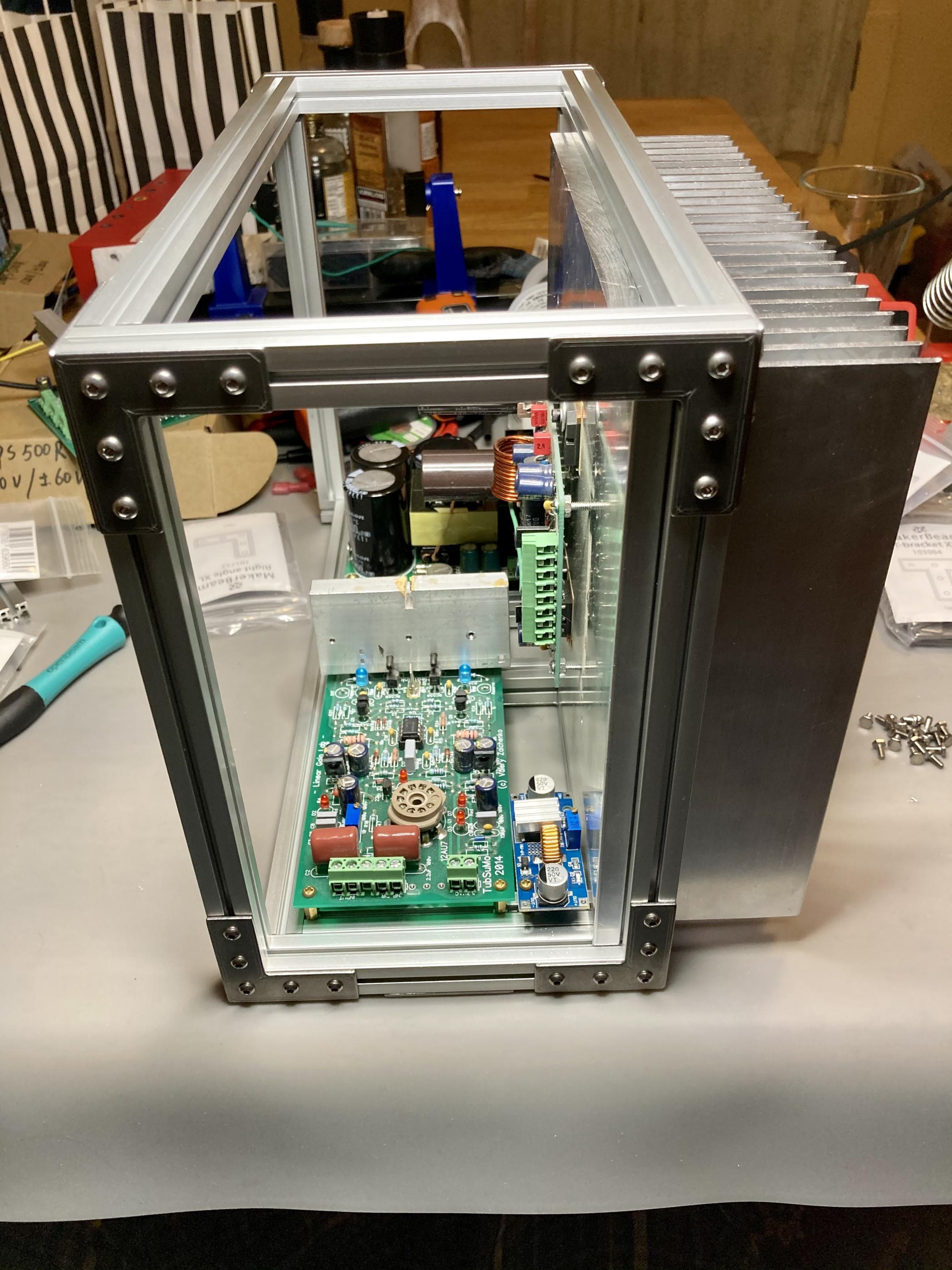

New TubSuMo
I am starting a TubSuMo build based on completed boards, heatsinks, and tubes from Evan (see post 662 Ultra-high performance, yet rather simple - hybrid and more!).
I’m planning on using SMPS to simplify things. This will include auxiliary voltage for the 12AU7 as well as power protections. If cost were not a consideration, I’d definitely go with 1 SMPS per channel in monoblocks, but I’m theorizing putting everything in one chassis.

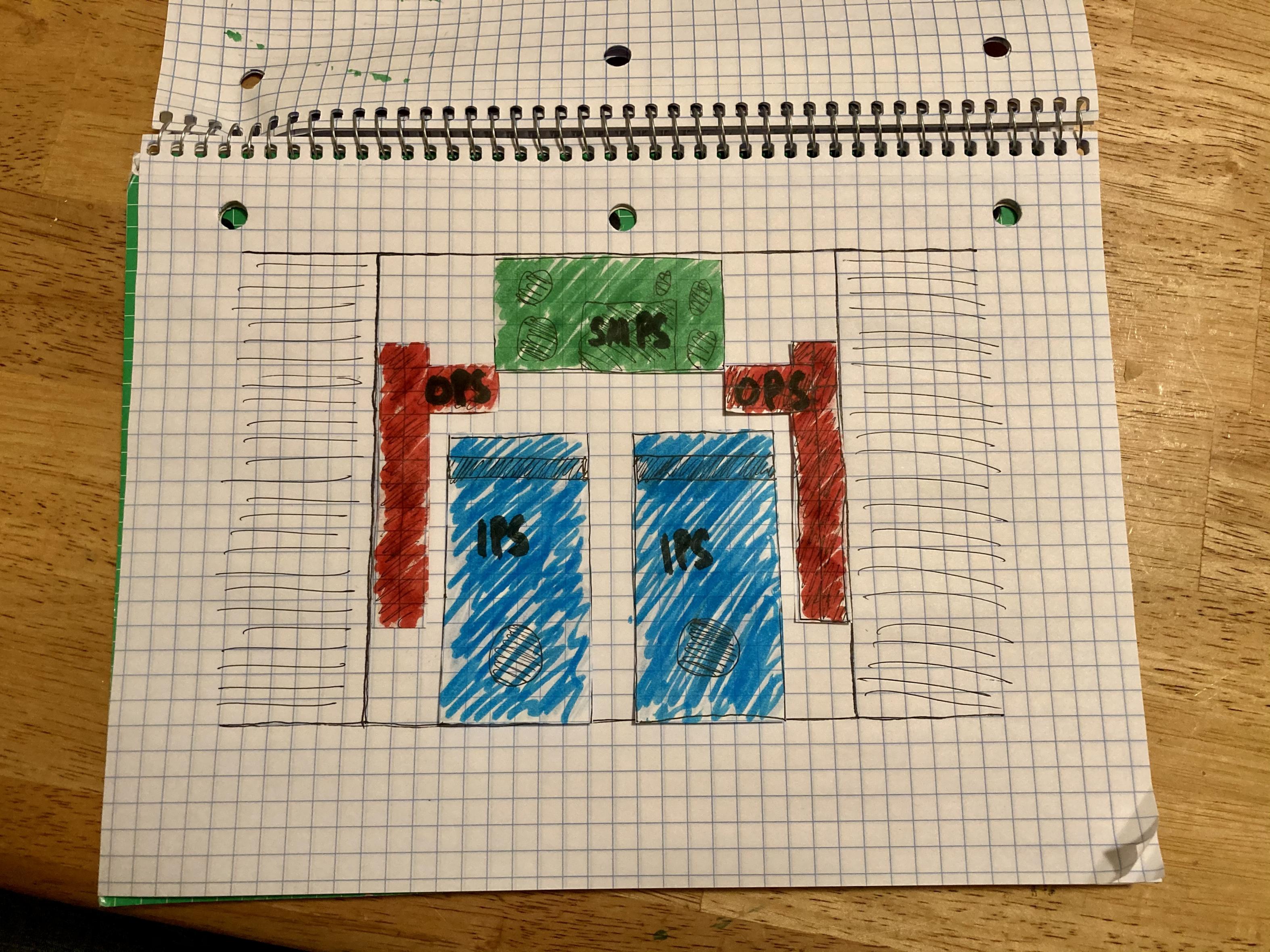

See my attached to-scale drawing. 😀 I’ve preliminarily surmised I can use the diyAudio store 244x240 base plate and heat sink brackets for a baseline structure. The heatsinks are 10x8x3 inches.
The smps drawing is based on the Connex SMPS500RXE. I think I can fit one bigger smps in that area, or two 300w in there stacked with riser board(s) from the store.
Evan has generously sent me his original monoblock enclosures, as well. I will likely use those for initial testing, but they are a bit larger than ideal.

Hi Marc, all looks good. Evan's build is well-tested.
You will need 6.3V AC or DC for the tubes' filaments - both options are perfectly fine according to the data sheet. Each tube consumes 300mA - your aux voltage source must be powerful enough.
I like the configuration with two SMPS300RE PSU boards better - separate PSUs lead to lower crosstalk, it is also easier to avoid ground loops.
+/-60V will be no problem. bias setting - as usual. Start with lower bias, then adjust, let the thing warm up, adjust again.

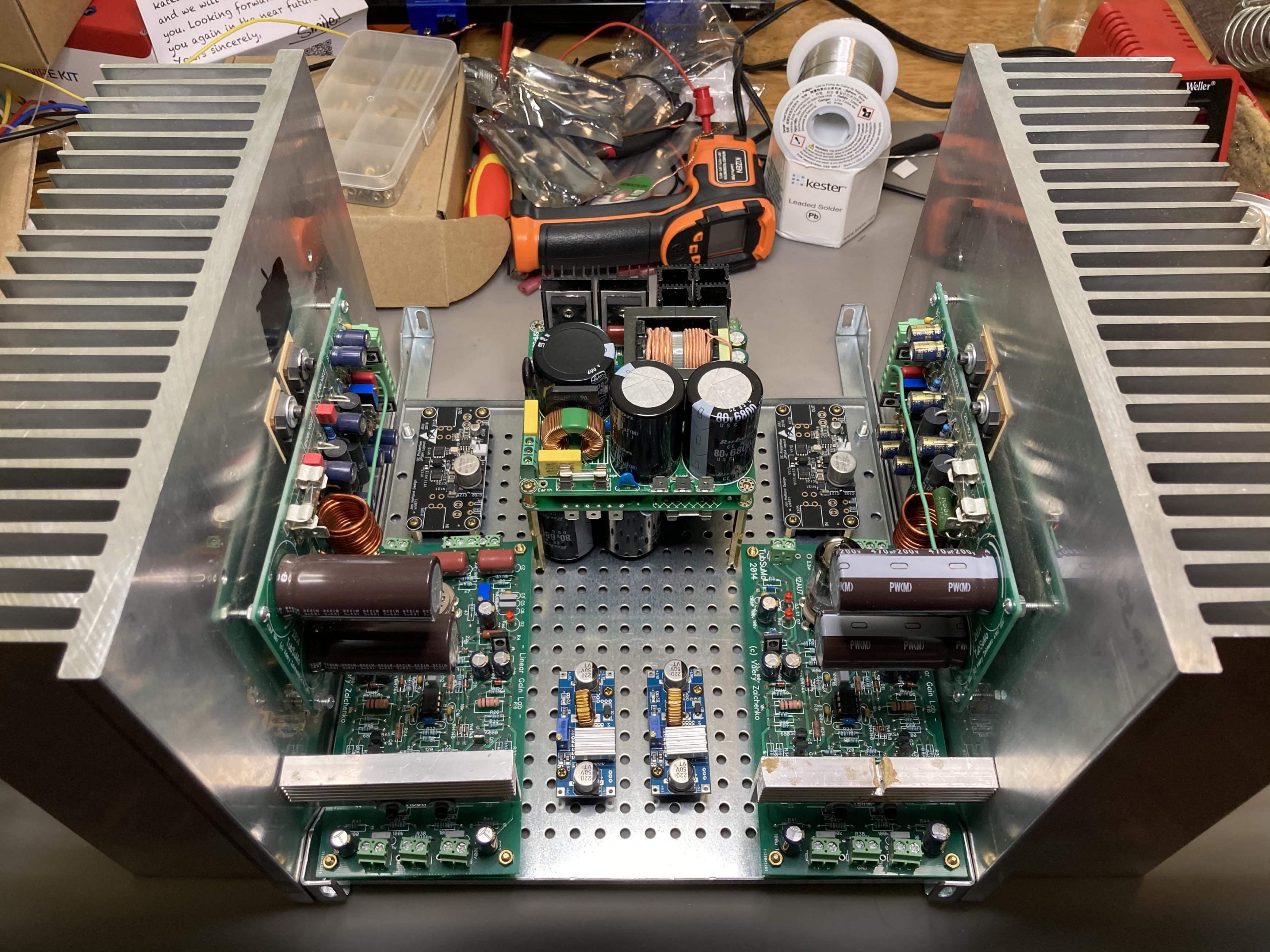

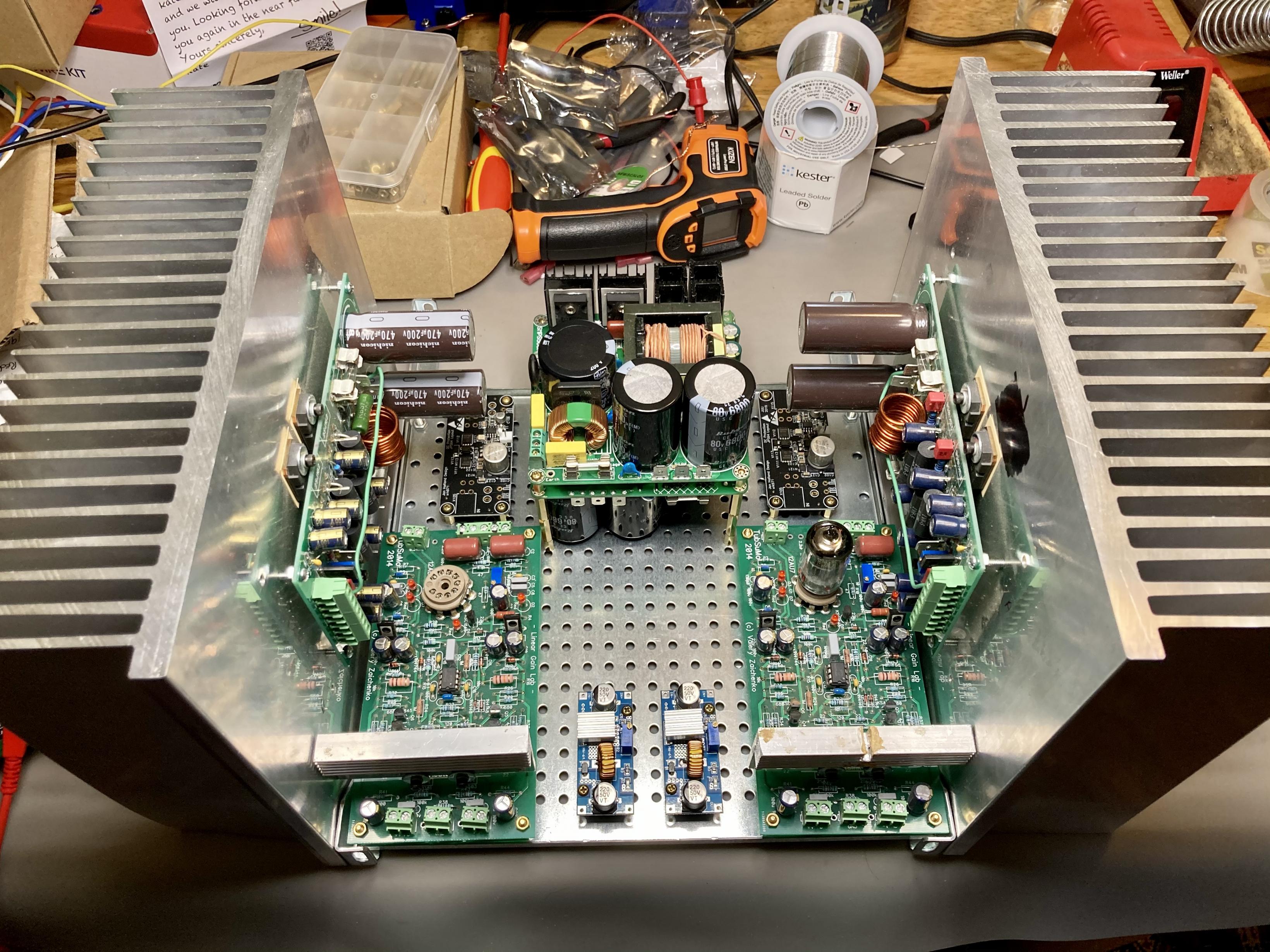

A bunch of goodies arrived today. 😀
I couldn’t help but play around with some test fitments.
Still have some riser panels on the way for securing the SMPS.
I can envision also developing narrow and tall monoblocks, but I will have to step up the DIY with something like makerbeams...

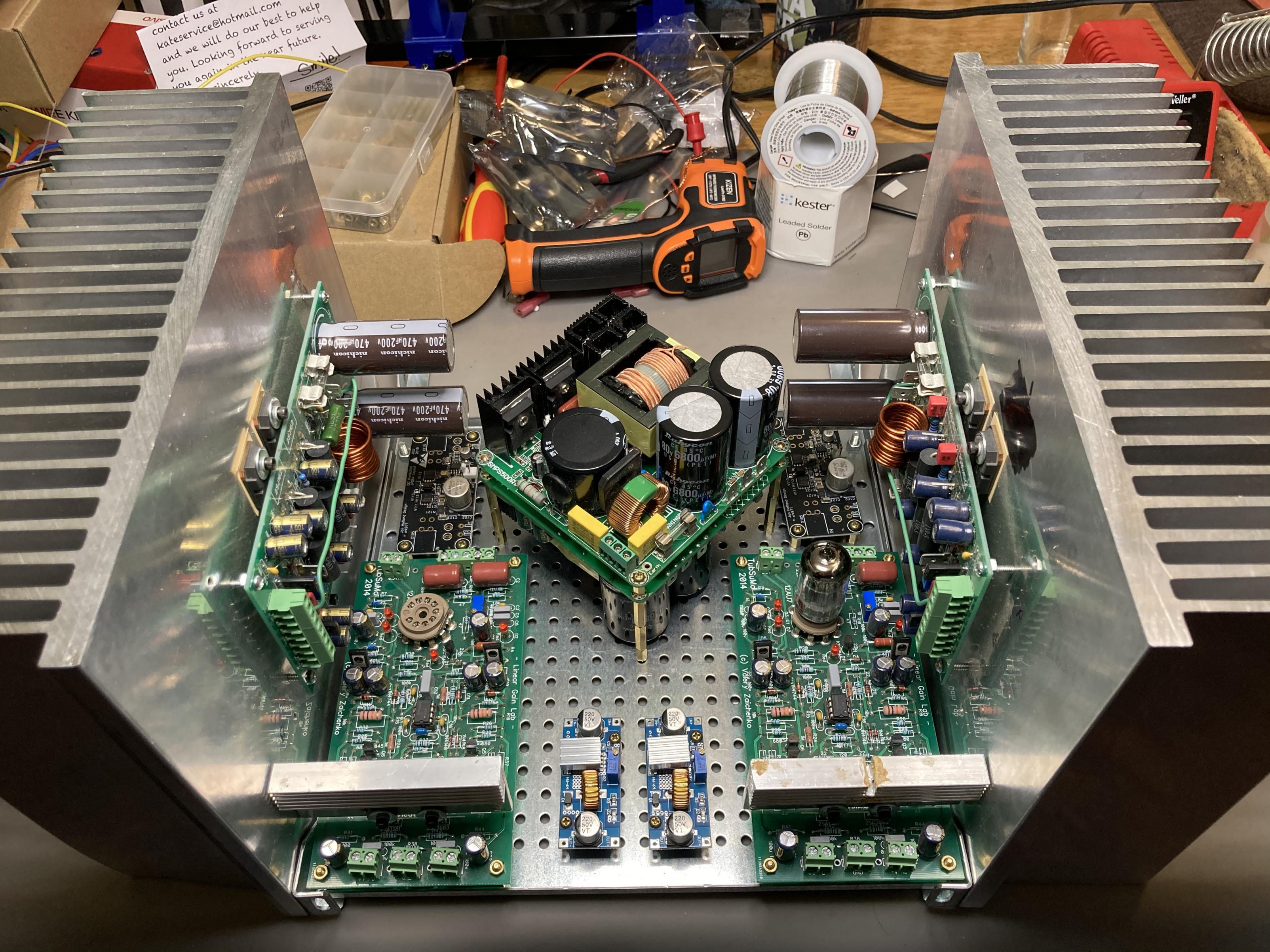

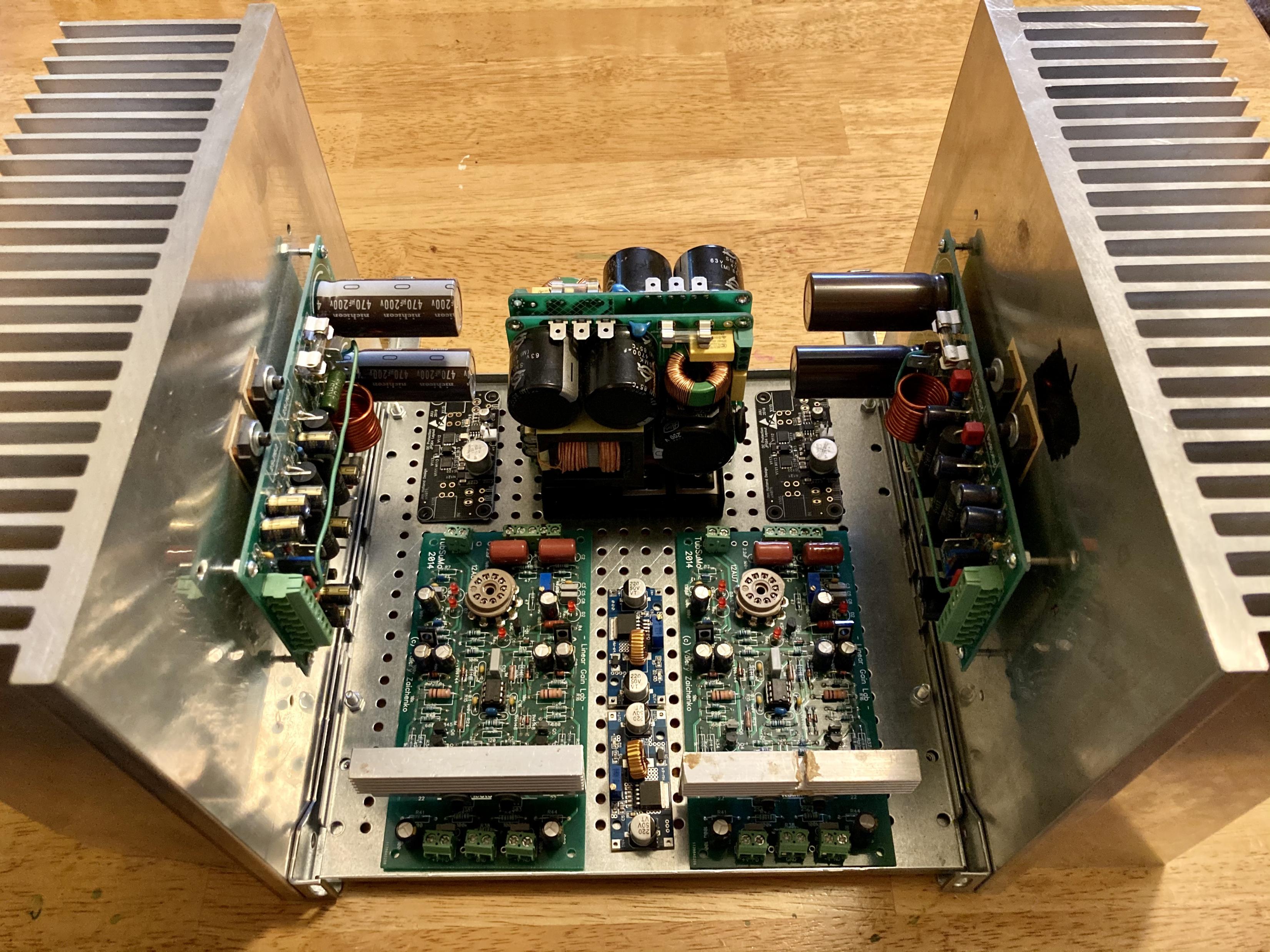

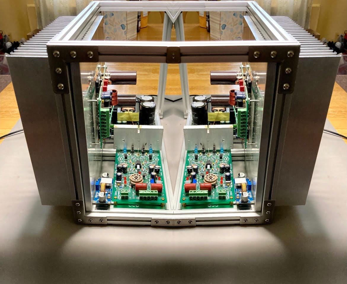

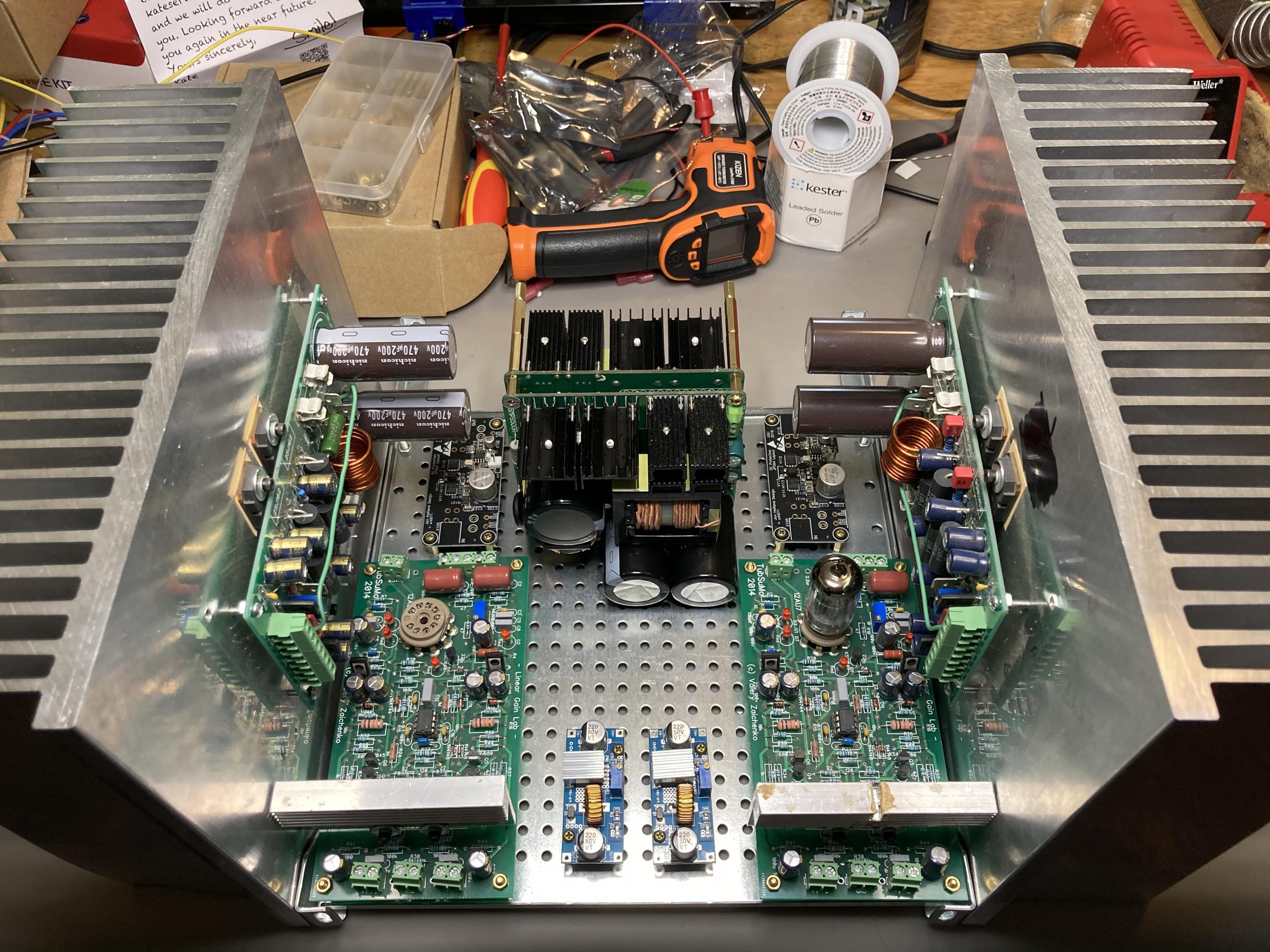

Tight spaces... Monoblock arrangement is getting more favorable. However, it’s still compelling to try to build all of this into a stout single chassis.
Though I liked the spacing of the previous post picture, it wouldn’t have given the SMPS enough room for cooling on the heatsinks.
Other options are in the pictures.

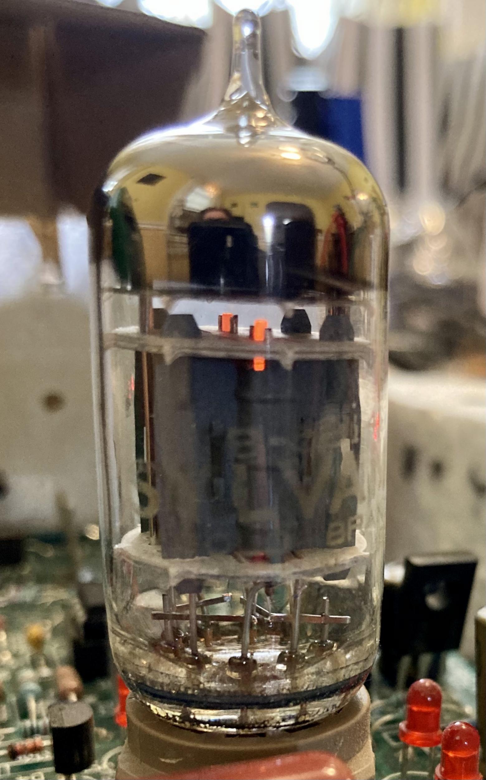

Also, I fired up one tube! Very exciting.
Magic glow 😛 As John Broskie says: "No glow - no go!" 😉

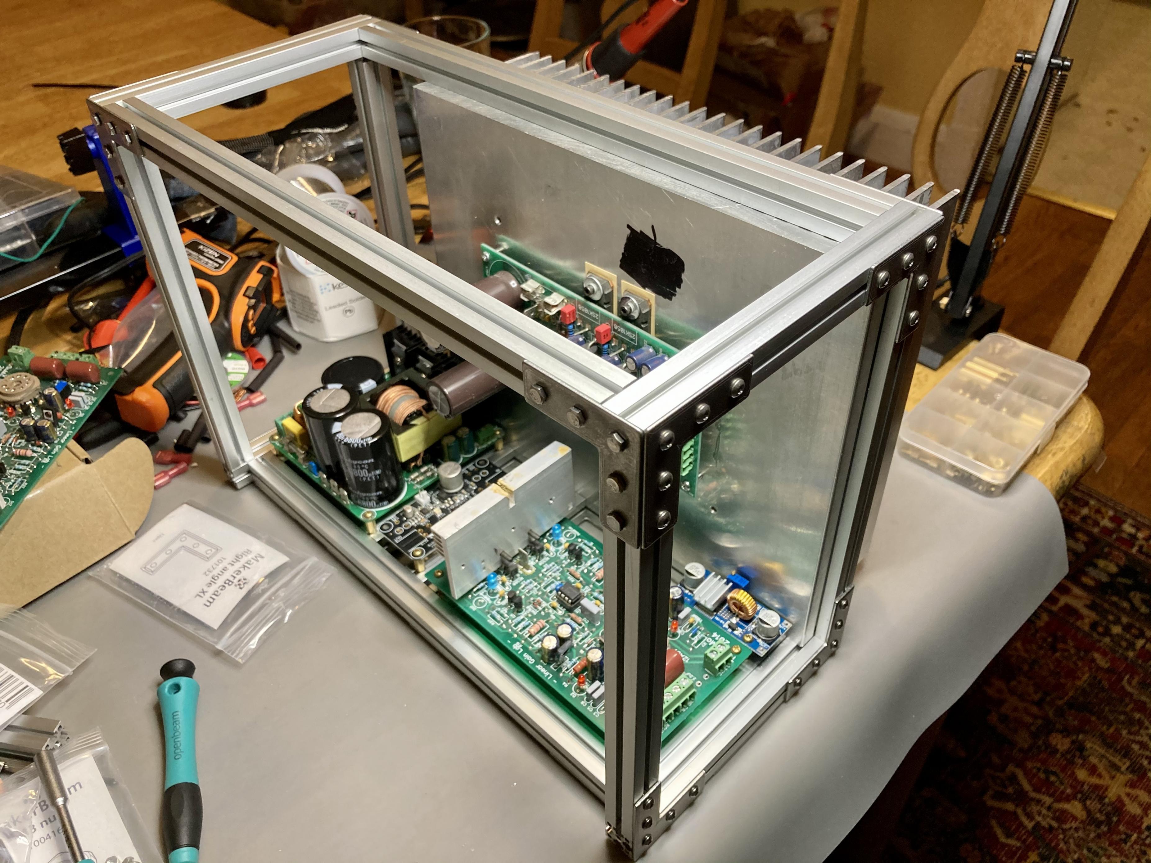

To be clear, that picture is just the one monoblock I built the structure for, mirrored and added as a second image for an *imagined* stereo amp. I’ve yet to wire everything up and test the prototype. Eventually, I expect to have the two built and tested in a quasi-mirrored arrangement. Some additional brackets could meld them together for the Hyper TubSuMo Megazord. 😀
I’m just seeing this. I really like the look of the monoblock. Certainly nicer than the plywood I sent over. The smps certainly saves space and weight.
With your woodworking skills, Evan, I would have done the same thing. I’m going out of my way to put these together with zero drilling, tapping, or cutting of aluminum. I don’t have the machining chops. Polycarbonate panels are likely going to go into the slots of the makerbeams. This project is too interesting to close up out of sight.
The SMPS absolutely cut down on space and weight. I’ve been interested in trying them out with a strong class AB amp for a while.

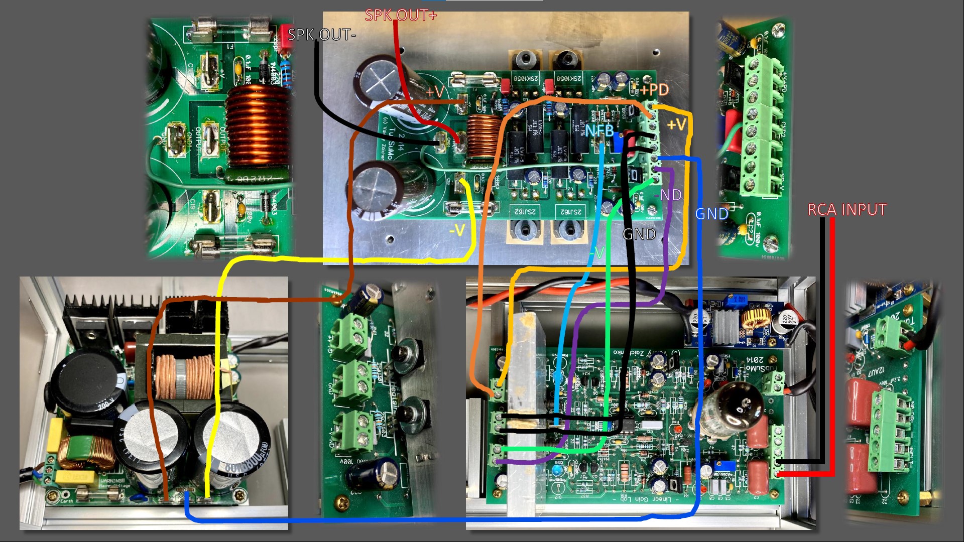

Valery and others familiar with this amp, can you please review my wiring drawing? I have reasoned out the obvious connections between the boards. Does neutral from the power supply connect to the OPS next to 'GND2' in one of the open terminals there?
What's not shown here is xrk's SSR speaker protection board I will connect to the speaker output. Ready-to-Run (RTR) SSR DC Speaker Protection and Delay GB
I believe that should keep the output disconnected from the speakers until the 12AU7 is warmed up.
Thanks!
Thanks!
