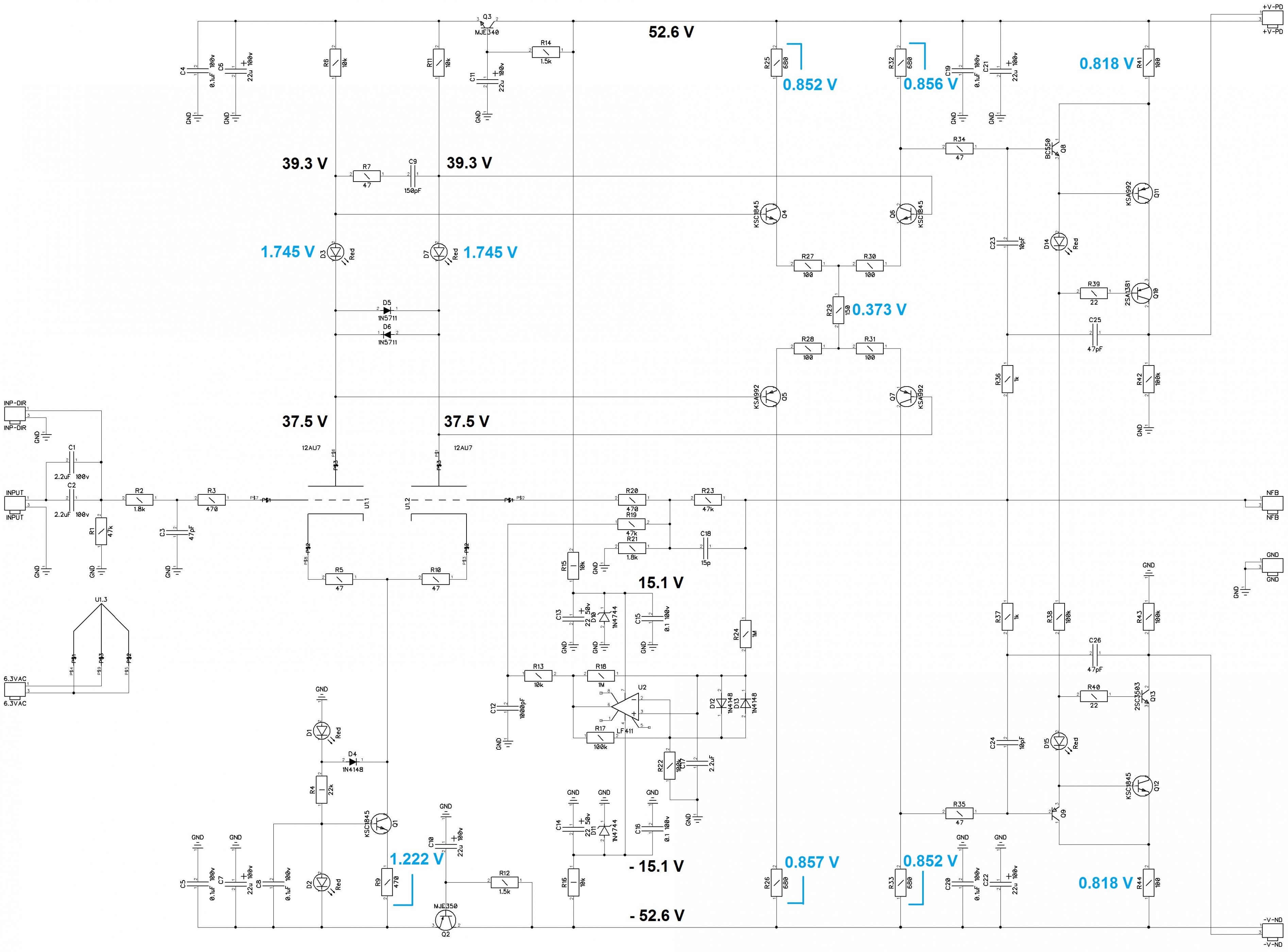

Hi Ladislav,
Please see the final version schematics attached (V1.3).
Note - the offset trimmer is dropped, also note R27-R31, C18 values are changed, D8, D9 zeners are removed.
It also makes sense to connect both 6.3V AC heater wires to the main ground (om PSU) through 0.1uF capacitors.
As I mentioned earlier - offset within +/-10mV is perfectly fine.
You can make it smaller, is you like, fine-tuning the servo:
R13 = 100R
C12 = 0.1uF
R19 = 27K

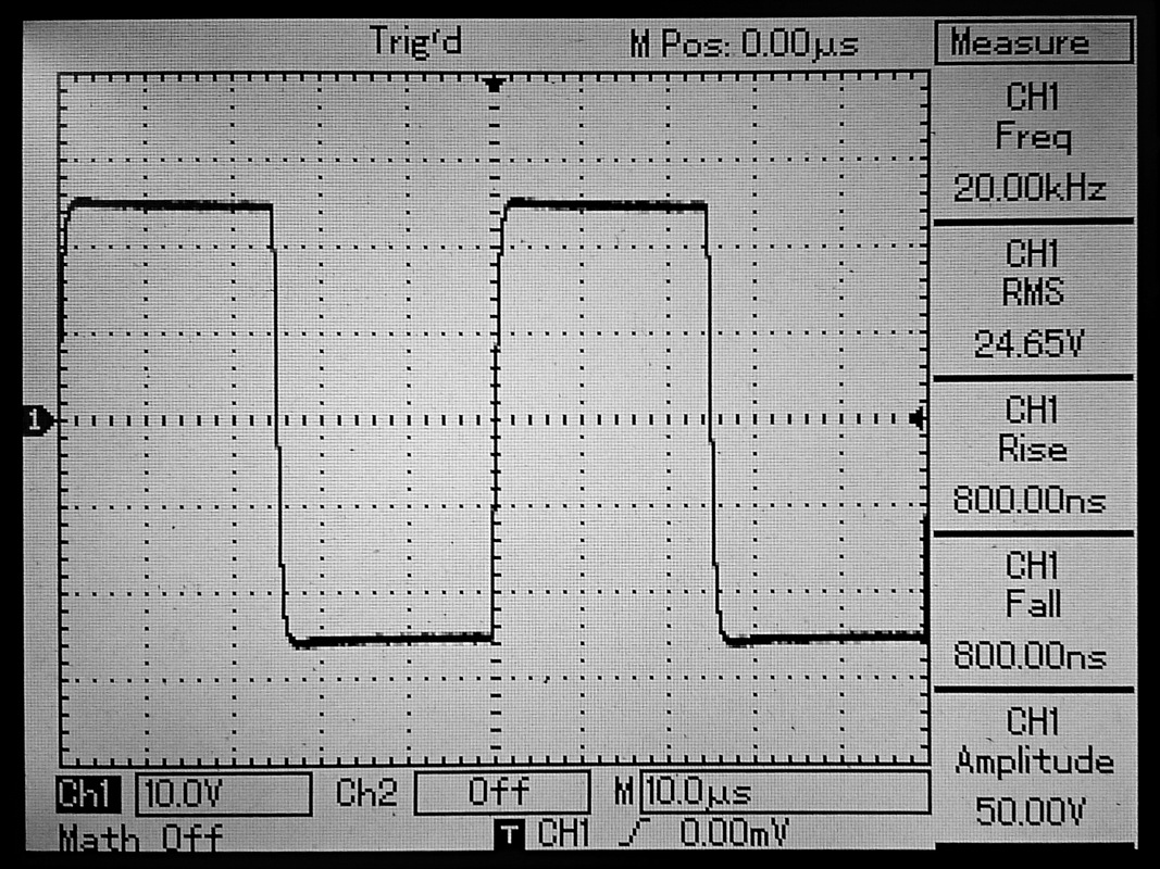

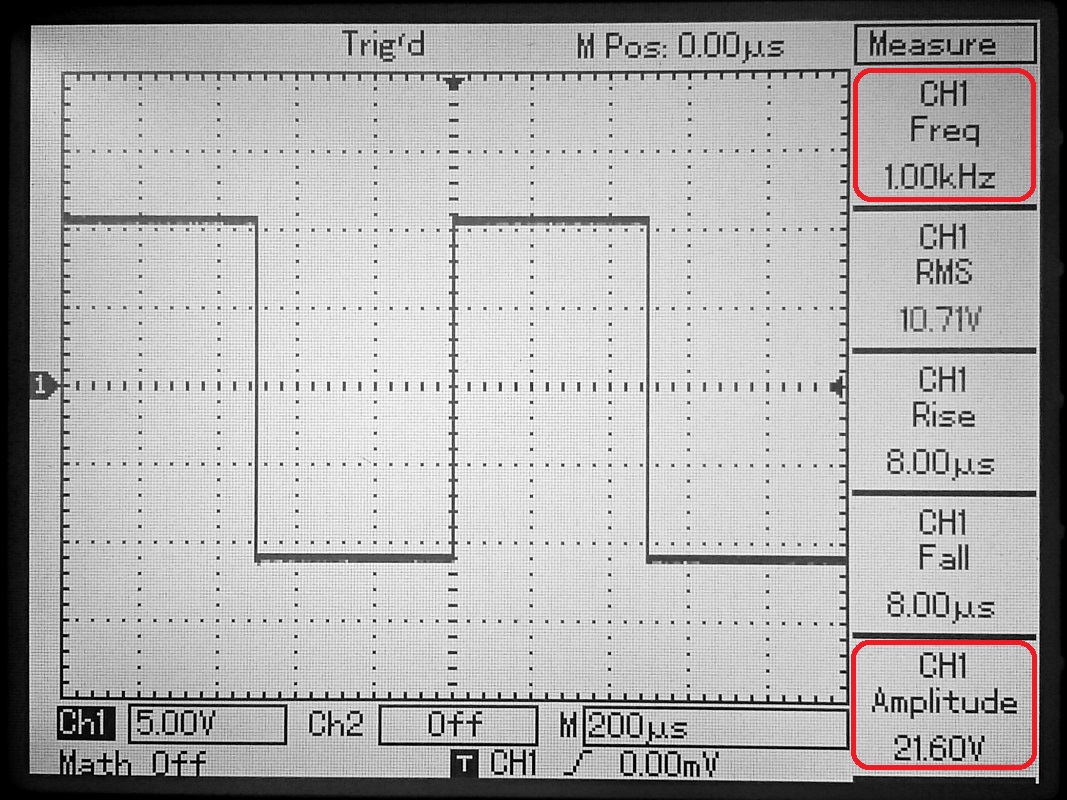

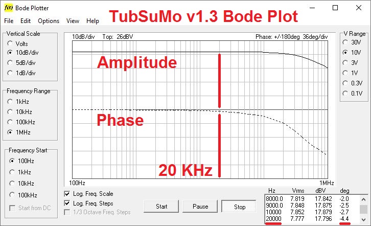

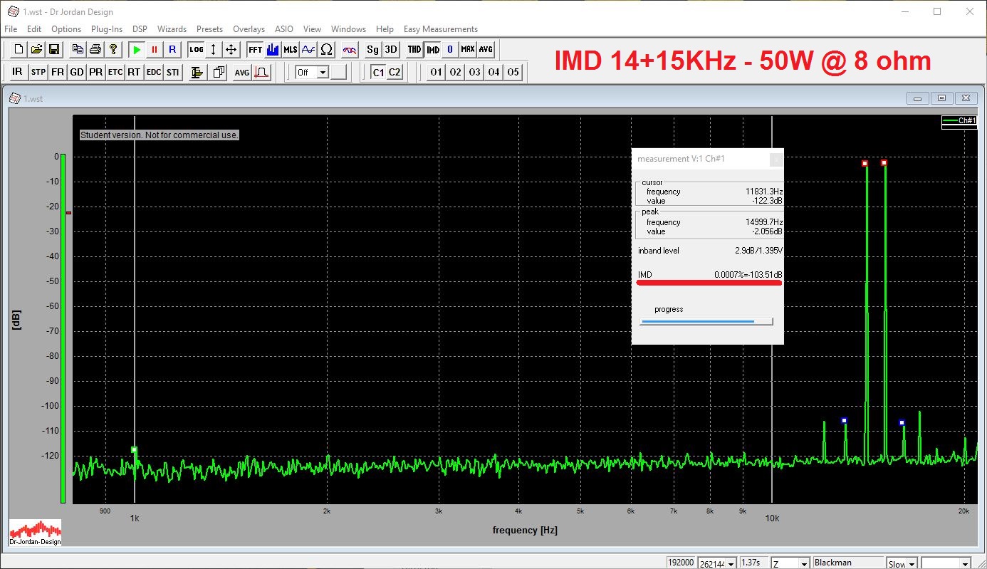

I have also attached the voltages, measured on my lab prototype, as well as some live measurements, made particularly with this V1.3 setup (all spectrums are taken at 50W @ 8 ohm load).
Your rails are fine - no problem at all.
Also note the minor changes in the OPS schematic: R13 = 160R instead of the diode, R4-R7 values.

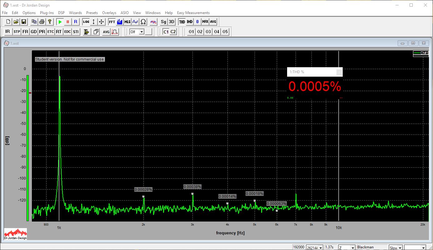

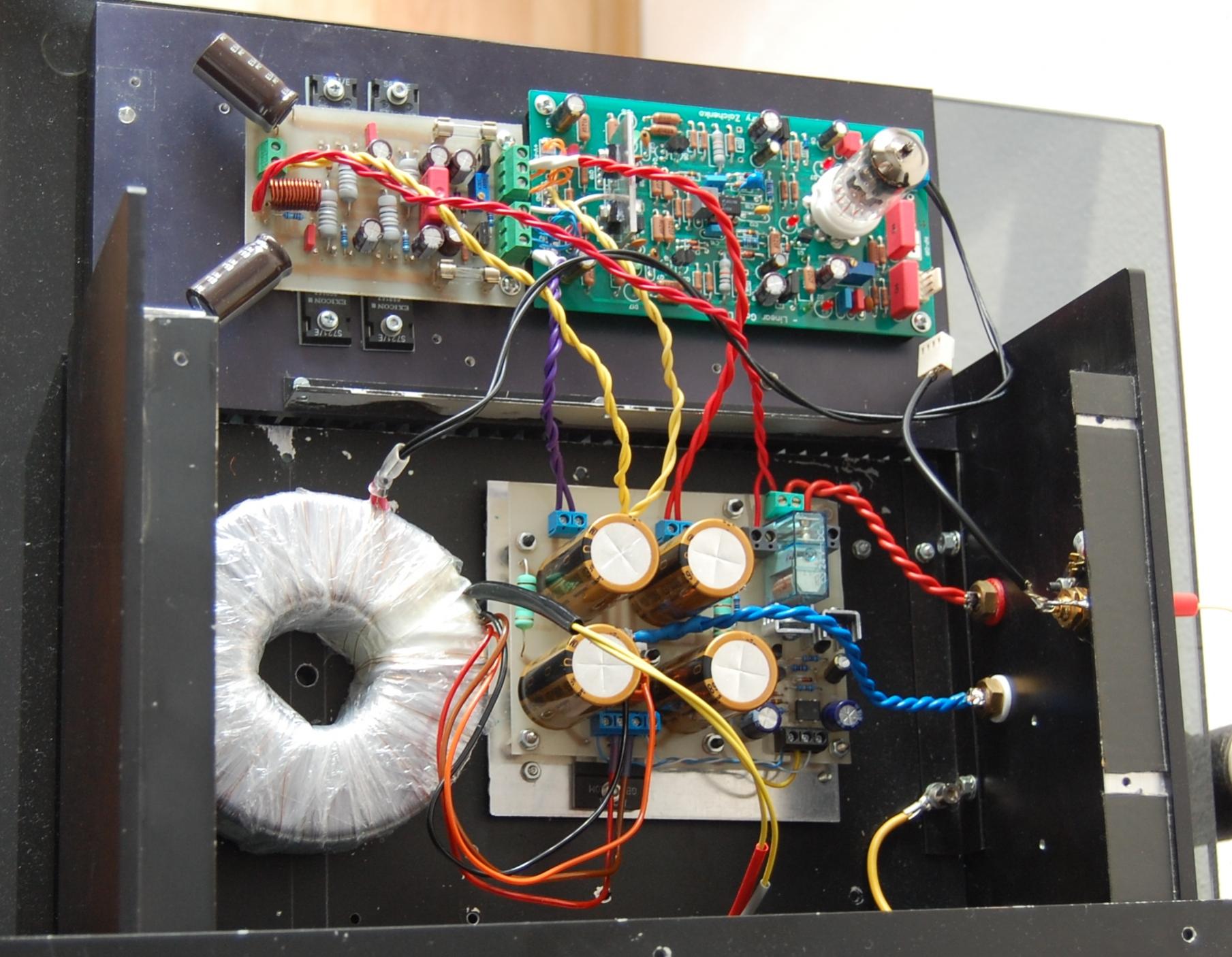

Some notes for possible diy-ers
To put TubSuMo into box is quite challenging issue. I used the box from my previous Lateral MOSFET project that did not satisfied my preferences. The dimensions inside are 30 x 34cm. I realized that I can not put there easily small transformer for heating of the tube. So I manualy made a few windings on power transformer. However in this case I can not power on heating separately.
My solution at present is prolonged connection of loadspeakers. I am using 1 meg resistor and 100uF capacitor for making time lag to switch on loadspeakers. See attached picture.
Other thing is size of output PCB from Valery. It is bigger than expecet 😕 So I had to make my own smaller one manually. Even in this case the capacitors at this OPS board are not in normal "standing position" - they are with bended leads. Otherwise it is in space conflict with power transformer.
I am still thinking about connecting heater wires via 100nF capacitor to the ground. At this moment I am thinking it directly to the box. Maybe it is not optimal solution if anyone think it should be connected to the star point let me know please. In this moment there are not any problems even without this capacitor.
The first attached picture is my power on circuit. the other one is illustration of my set up.
Ladislav

Yes - the box is relatively compact 🙄
The box I was thinking about, while designing the boards, was 435mm wide, 400mm deep and 5U tall 😀
100nF capacitors - on my prototype, they are connected to the main star ground close to PSU. They completely eliminated some minimal noise, coming from that AC wiring, making the amp dead quiet at idle. If you don't have any hum issues - you can leave it as is.
