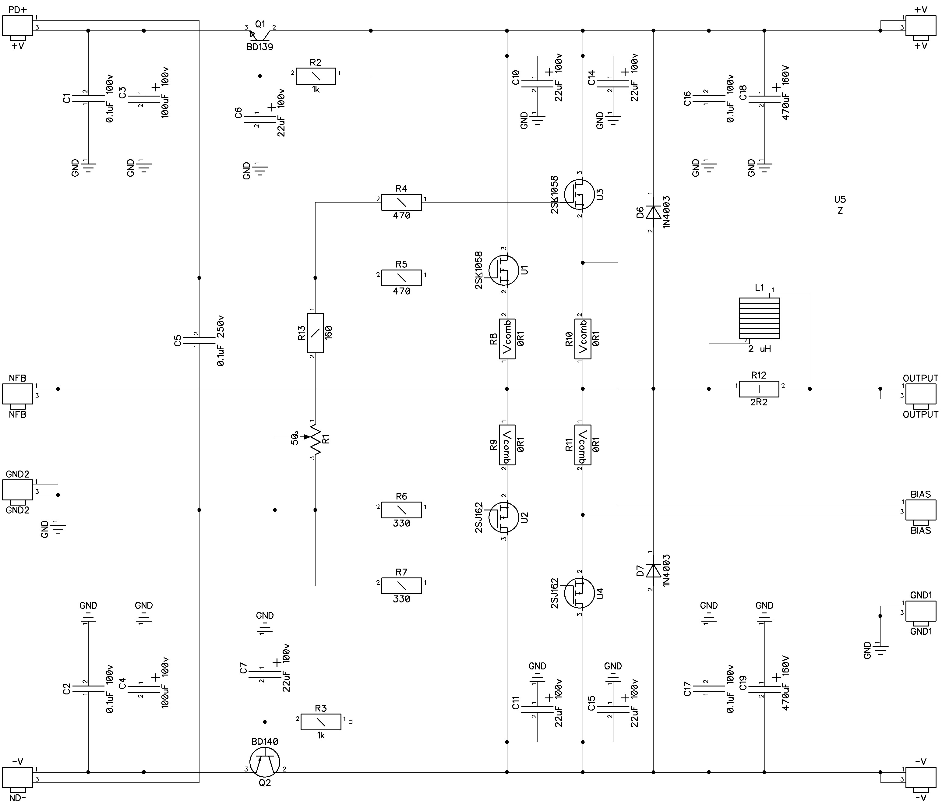

I am happy to report that I finished the FetSuMo IPS today and it works beautifully. Square waves look perfect and it sound lovely. I'm not sure if it sounds any different that the TubSuMo but it is very, very nice. I would still use speaker protection because it has a pretty big thump.
I used the schematic you posted in post #561
http://www.diyaudio.com/forums/atta...-rather-simple-hybrid-more-fetsumo-01-sch.jpg

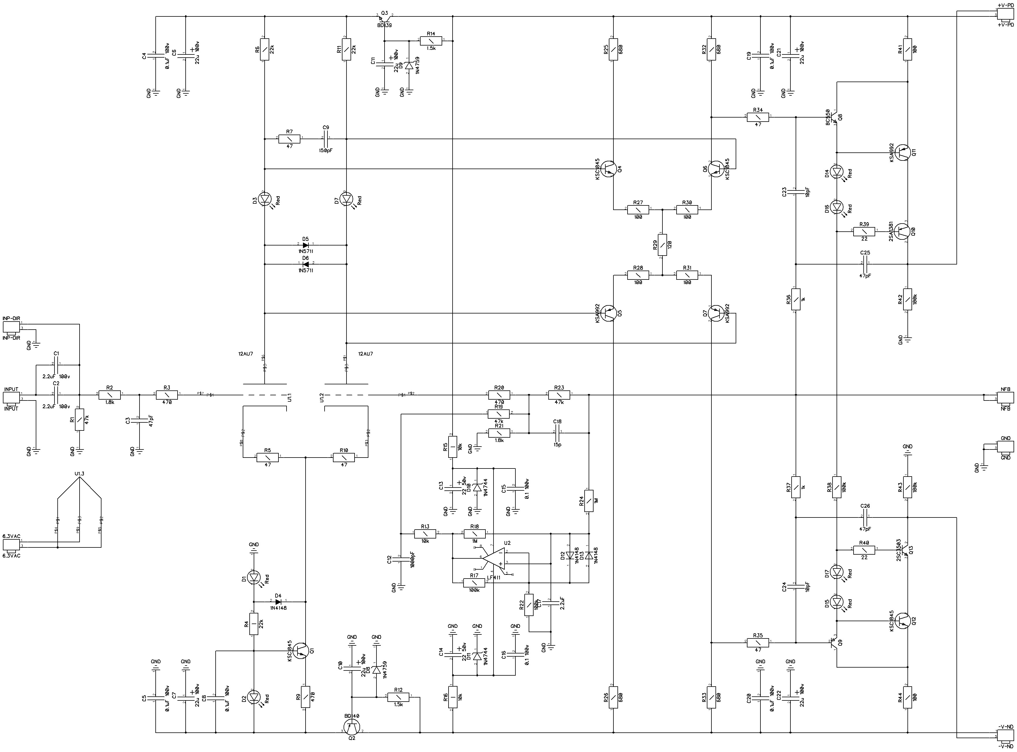

Dear Mr vzaichenko, I'm doing tubsumo 2014 version, please ask me for running voltage to + -70vdc. I have to change the resistor values do or I have to insert the correct value on the pcb
please help, thank you
Hi Diyminh,
I will publish the latest schematic with the values for +/-70V rails later today.
Valery
TubSuMo 2014 +/-70V rails FINAL
Here we go!
Please note - for the best noise performance, both 6.3V AC wires for the tube's heater must be connected to the main ground via 0.1uF capacitors (on PSU board or close to it).
Valery
Here we go!
Valery
