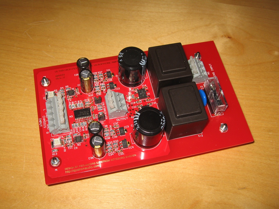

Received the Hahn transformers today. Hopefully I'll get round to testing it this weekend.
Some of the soldering on my PCB is really bad as for some reason I couldn't get the amount of solder small enough in many places. Still, for a first attempt I'm quite satisfied. The really thin solder I had was Multicore tin/silver which I couldn't use so I had to go with my usual 0.7 mm Multicore 60/40.
My QRV09 is tested and found to be working perfectly on BOTH channels so I'll get stereo (!). The bandwidth seems a bit lower than the specified 700 kHz with AD8610 but obviously far away from anything audible (I'd say around 550 kHz on mine). I'll do more testing as the frequency roll-off that interests me is in the low end.
Excellent job P-A, so far this is a success and I hope I won't be able to mess it up by putting it in a box...

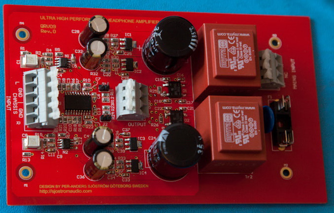

Finished mine off this afternoon. For it being my first soldering effort (other than a 10 component pin-based PCB kit from Maplin to practice) I must say that I've made a right mess of it (that was kinda the plan; ruin the first one and build two more that would actually work). 🙂
It took me a long while to figure out that I should wet the bit and hold the component in place with the tweezers to tack it down which is why my first few SMDs are such a mess (the flux boiling off would send them flying across the table).
Will test it on the weekend, when I've had the opportunity to buy a 2.5mm jack and connector (they're not on the BOM and it just never occurred to me) and a mains cable that I don't mind cutting the end off.
My back hurts, my eyes are crossed and I'm sure that I have lead poisoning from the solder but, hot damn, was that fun. 🙂
I can't wait to plug it in and find that it's not working and then debug it. 🙂
