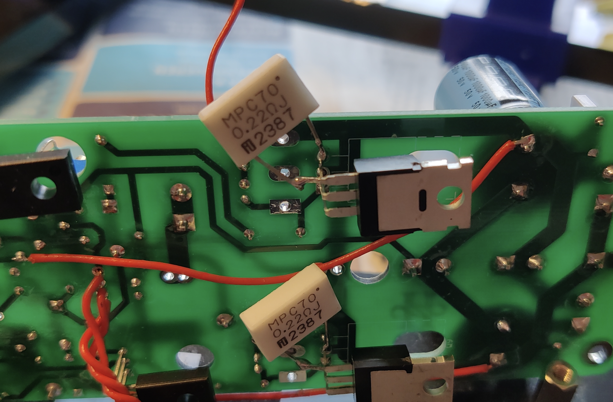

I have tried with source resistors of 0.22 Ohms in my setup today and the thermal runaway with the verticals was gone.
The BJT for bias compensation was still in place, no overcompensation at all, @AKSA. In this setup, the bias stayed at 130mA as I had set it, without signal and after running 500mV input for a while and then letting it rest again.
My board was not planned with room for source resistors, so I cut the source pin and soldered the resistor in for the test.

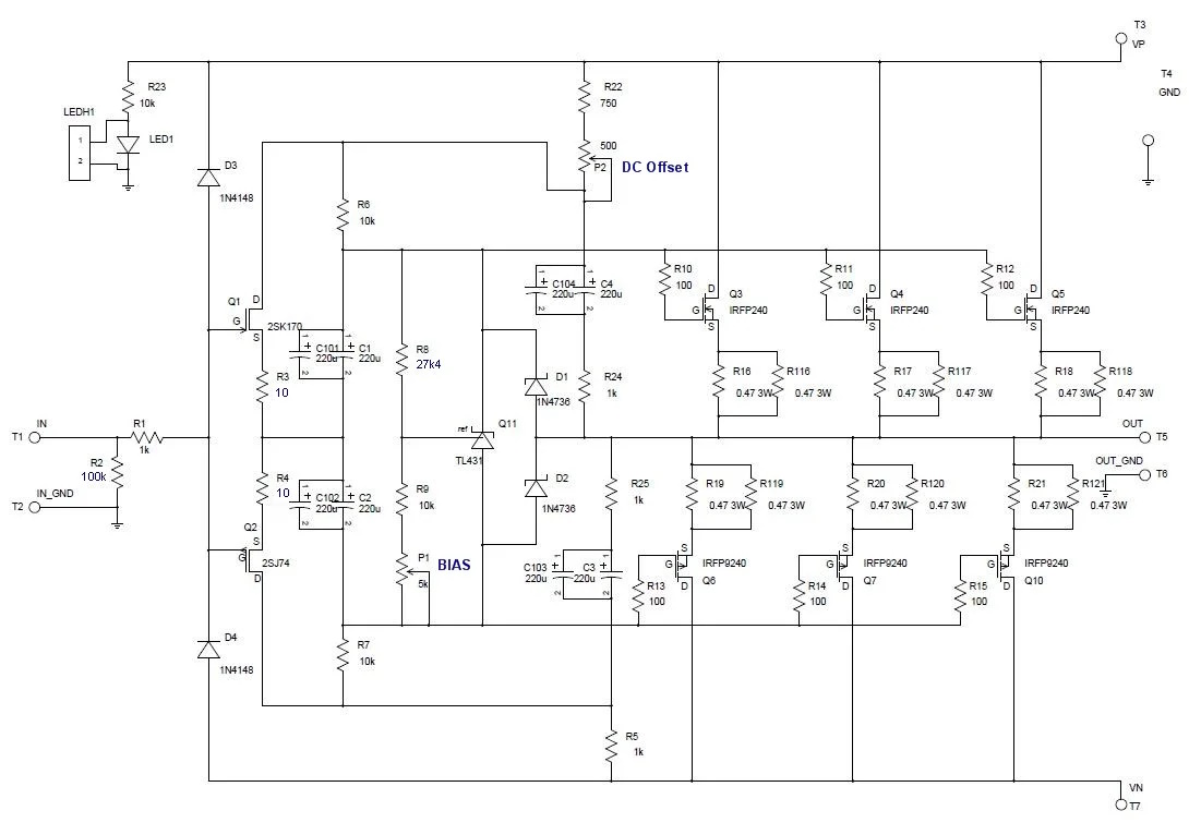

I never got any clear answers to why Pass F4 can use TL431 for bias control, while this amp supposedly can't. Is it because the F4 runs on a highe quiescent current? If thats the case, I guess I can do the same with my amp?
Pass F4:
Ultra HEXFET:

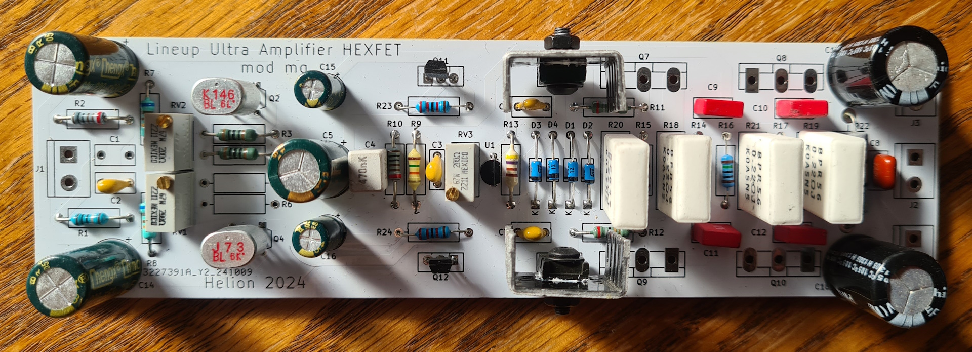

Time will show, because I am (very) slowly progressing with my project:
🙂 morten
TL431 could be noisy if used in the front stage.
The Vbe multiplier position is at the output stage. It seems to be fine for me. As it is not possible to thermal couple with TL431, you need a big heat sink.
You are limited by the voltage rating of the JFET, paralleling 2 mosfets is overkill.

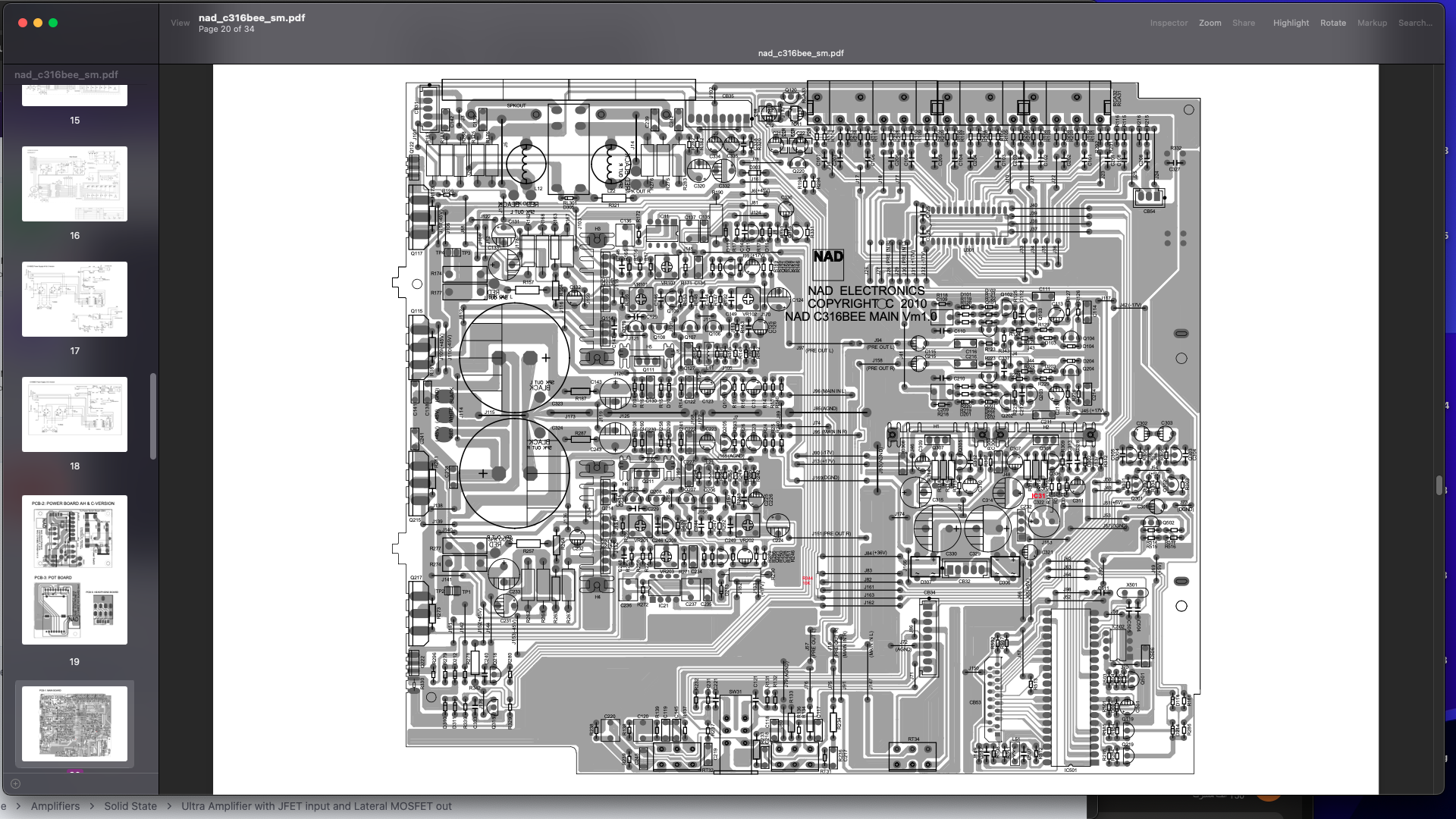

Hello, I am new to the forum.
I would like to upgrade my amplifier nad c316bee . An engineer advised me to changing the input buffer transistors from NPN to a
J-Fet (J112 or 2SK246). Is there a noticeable difference? Where is it located on the board?

Nobody is answering because your question is based on poor information. I could just say that you cannot simply replace a NPN with a JFET, but there is a possibility that it could be done if you modify other parts in the circuit. If this is the circuit
and you want to replace Q101 then simply dropping in a JFET would cause a bias shift that needs correcting. Diodes D101 and D102, Resistors R121 and R119 exist to bias an NPN transistor and would have to be altered, possibly to a ground connection. A JFET would cause an DC offset at C115 that may work with some loss of headroom. It's a bit like saying that you can replace a horse with a camel. Yes and No.
