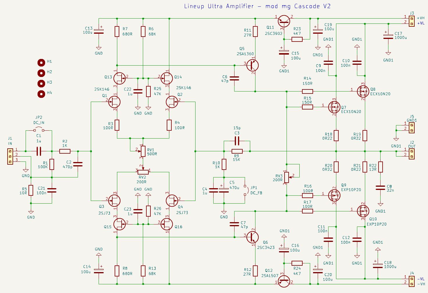

Just an FYI for other builders: when I tested with ECX10N20 and ECX10P20 and had the input of the amp open, the zobel resistor started smoking, indicating a high frequency oscillation. When I shorted the input, this did not happen, as well as when connecting a source.
This is a usual issue of amplifiers with fast MOSFET output stages. If this
https://www.diyaudio.com/community/attachments/ultra_cascode_v2_skjema-jpg.1365332/
is a current design schematics, I would have some comments:
- omit R5//C21 and short R1//C21 bottom nod to ground. Do not split the grounds with the 10R resistor, it only brings troubles.
- Q1 - Q4 might need gate stoppers resistors, like 47 - 100R.
- or put a resistor 47-100R between C2 and Q1/Q3 gate junction.
- C3 to be tuned according to step response measured on the real sample.
- output inductor should be used, something like 2uH//10R.
Always test the amplifier with open input like @mz543578854 did. During normal listening it may happen that the input cable is unintentionally pulled out and one has to prevent amplifier and speaker damage resulting from oscillations.
PMA: Thanks for your comments.
The schematics you refer to is a very unofficial one I made with good help from several clever people in this thread. I wanted to use some of my 2SJ73/2SK146 in this design, and that schematic was the result. Probably noone but me will build this... 🙂
But when I do, I will have your concerns in mind.
If it is only between amplifier signal ground and chassis/PE, then it is desirable. However, if the amplifier circuit has 2 grounds (signal and power) on the PCB, separated by 10R, then it is an issue as the ground current that flows from the signal source to the power GND via 10R creates voltage drop across this 10R which adds to the output signal, is amplified by amplifier gain and then is easily measurable in a spectrum as mains components rise. Take or leave, please, this is shared from long term experience with SE signal transfer. When possible, switch to balanced.

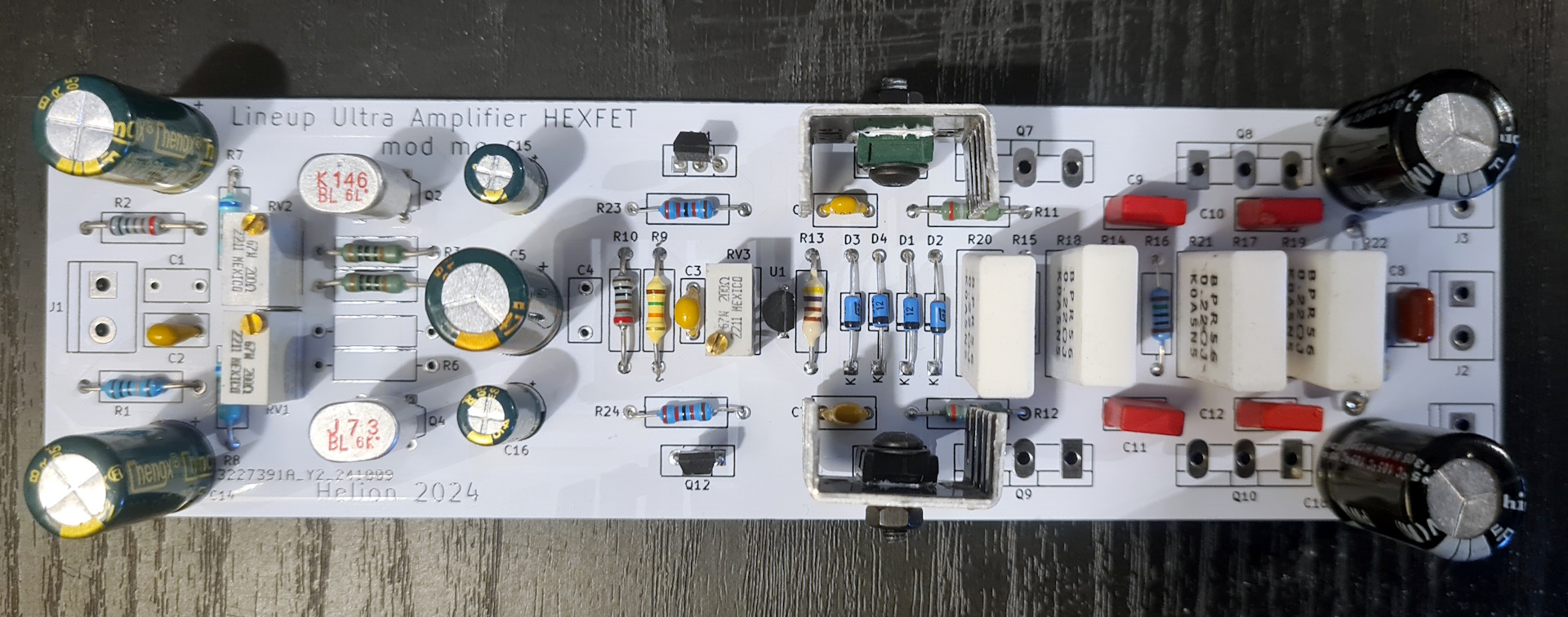

Hi all! At last I am starting to build this thing. First out is the HEXFET version withou cascode. Looks like this at the moment:
Do you have temperature compensation in your bias network? I had thermal runaway with HEXFETs, see somewhere above.First out is the HEXFET version withou cascode
No, I don't! Would it help putting the TL431 on the heat sink? (Hope not, it is already soldered...)
Enough for today. A little worried about the runaway... Have to get the 1u caps and terminal blocks. Box is empty.
