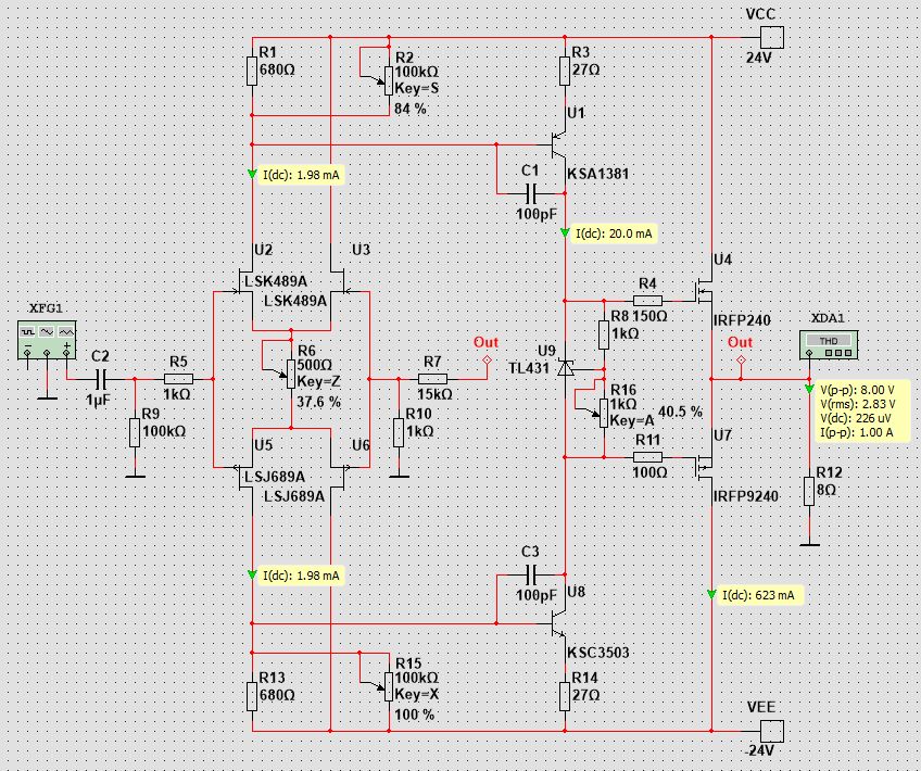

Any thoughts about using the TL431

I just did a search myself too, hehe. The TL431 occupies the same space as would a bias spread. That is why I thought it could be placed on the heatsink for some regulation.
The problem of thermal feedback biasing for the vertical MOSFETs has been "solved" by others here. look around for amplifier circuits by Ostripper or Damir that use those MOSFETs and just borrow one of those bias circuits. They've already been tested and known to work well....
And this is from the TL431 data sheet.
"In addition, low output drift versus temperature verifies good stability over the entire temperature range."
Definitely no means against this.

TL431, doesn’t drift as it heats up. Actually, it is a disadvantage that it prevents you to use it as thermal negative feedback.
For me, you could just use a Vbe multiplier with To-126 transistor that mounted on top of the mosfet.
This works well at least in LTSpice sim. :
I still have some circuit boards left over from my TO39-AMP project. They are designed from the outset so that they can be used for different amplifier versions in the "blameless topology". I have now considered whether it would be possible to build a MOSFET output stage with them. The circuit is largely predetermined by the existing circuit board, it is actually only possible to change the components or their values. I have also made up my mind not to use lateral MOSFETs. The circuit must therefore be designed in such a way that thermal runaway of the quiescent current of the...
So, could this be as simple as replacing the TL431 with an IRF840 (will a close cousin be ok? I do have the IRF540, 610 and 630 in the bin)... and maybe increase the resistor values for the bias?
Is it correct to assume that it is the ratio of the gate resistors that is important, not the actual values? I will be running this amp at +/- 24V at the most.

A constant bias generator output will see the output mosfets runaway as they warm up.
The best Vbe multiplier for this role uses a small mosfet, like an IRF510. The bias voltage will reduce as the output stage warms, keeping the quiescent constant, or at least close to constant.
There are other methods for mosfet bias but a TL431 is not the answer.

A bit of source resistance will work wonders with vertical mosfets. Then a TL431 can work. See Nelson’s F4. No doubt recommendations above will also work.
I do actually hope to run this amp in class A. And running in class A is perhaps the reason the HEXPETs behave better? How much quiescent curent do you think I need? My Rs is 0R22, practically the same as in F4. And supply is the same.
Quiescent current depends upon how big of a Class A envelope you want. Nelson has many articles on this. It is typically about twice the bias current into the output before the other device shuts off. You might also hit the voltage rails before you hit the current limit. Depends on the load. Practically, you would size the quiescent current based on the size of heatsink you plan to use. I’m sure the real experts here will correct me if I said something wrong.

But as I am just a builder, not a designer, I wonder if this amp could/would work as is, if I had for example 500mA bias per output pair? As ra7 pointed out, the F4 uses about the same bias scheme with success.
Depends on the sensitivity of your speaker. 500mA push-pull is good for 4W into 8 Ohm in class A. It should be able to cover 90% of the use cases at home.if I had for example 500mA bias per output pair?

But how about the issue of thermal runaway? What is an optimum bias for the IRFs to behave well?
1. Adding degerative resistors, (e.g. 0.22 Ohm), to the source of output mosfets.
2. Create a Vbe multiplier with BJT, mount it on the heat sink near the output mosfets for thermal negative feedback. I never tried with Vbe multipliers with MOSFET as someone mentioned. Not sure how a MOSFET Vbe mulitplier would behave.
3. Big heat sink. In theory, if you have a small enough thermal resistance, you don't need degenerative resistors or thermal feedback.

A Vbe multiplier using a bipolar transistor has a much higher temperature coefficient and will over compensate a mosfet output stage.
Use a small mosfet in place of the bipolar and your tempco will be precise.
