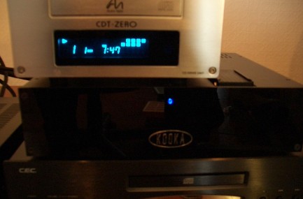

I just tested it for a few minutes, and it seems it sounds well, we'll see. Thanks for the comment about the look!
