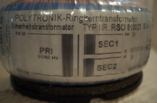

Yes quantran, I am sure.
The trafo did not come with the kit, and I have a toroidal like this (the colors are in german language).
So here it is:
1 primary
Black 0
Brown 230
2 secondaries
Black 0
Red 18
Violet 0
White 18
How do I connect in the 3 pins of the DAC?
So here it is:
1 primary
Black 0
Brown 230
2 secondaries
Black 0
Red 18
Violet 0
White 18

Hi Ronald,
Black and brown are primaries, they go to mains, not to the dac... maybe you could revise your suggestion... Thanks in advance.
I re-post the colors scheme and the pic.
1 primary
Black 0
Brown 230
2 secondaries
Black 0
Red 18
Violet 0
White 18
Kooka
You can try as follows:
Connect red to violet and measure AC voltage between black and white. If you get 36VAC then you can connect to the DAC boad as follows.
Red and violet together into the middle pin
Black and white each into the side pins
If you don't get 36VAC between black and white then I don't know. Do not connect it to the DAC board in that case.

Thanks quantran, that is what I thought.
Actually I get 41VAC (instead of 36) between black and white... would you connect or not?
tingtong5 said:Hi Kooka,
Sorry about that, must have been the hangover I had this morning from celebrating new year
Quantran is right connect red to violet and use black and white. A little higher voltage is no reason for concern.
