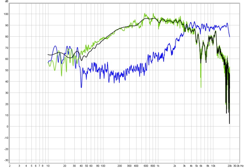

That is a really interesting driver. It kinda looks too good to be true, and makes me wonder what I'm missing. I can't find a distortion graph for it, so maybe there's some issue there? If not, why isn't everyone using this driver for their 8" applications? I have read that pro audio drivers sometimes don't sound as good at lower volumes; is that true?
I pulled my 12s out of storage, tested them in several orientations / mic distances. The spec sheet's FR plot seems real: the 3-5dB bump at 2.5kHz is their only flaw. Distortion was flat and low, all <0.5% from 300-several kHz, which is about as well as anything can test in my conditions (noisy PC etc).
Attached is a dodgy, no-baffle, in-room plot done with the driver pointing straight up. Green = raw, black = reflections suppressed. Blue = a very cheap tweeter, for illustrative purposes.

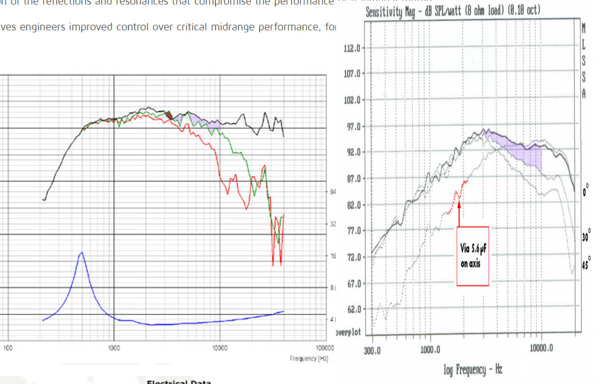

The Morel is still more directional. Attached are the plots, re-sized to the same scale, with the 3-10kHz range highlighted. The Morel's waveguide means the directivity goes a lot more low and consistent.
