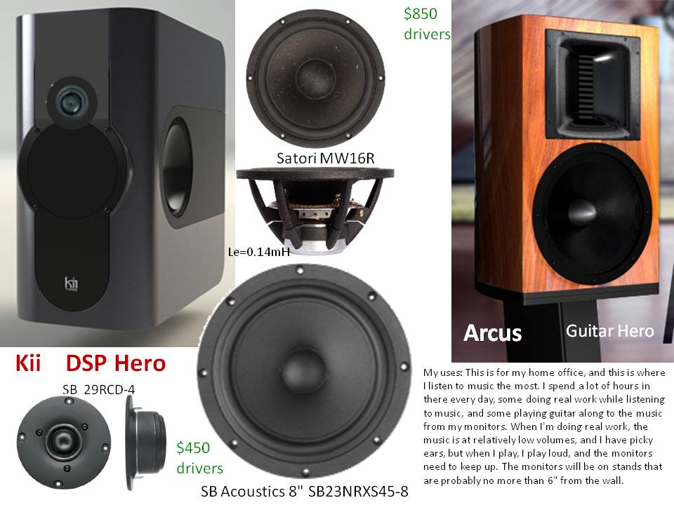

New Tech:
If you decide to put extensive effort into DSP+amps, you could follow the genius team that developed Kii. A Kii style speaker with about $450/Kii in drivers can cover the full 20-20K range. The Kii cabinet style has large front round-overs for low diffraction, plus side-side 8" woofers for equalized stand-alone bass. The Kii also has a rear woofer which is DSP'ed to manage rear wall bass effects, which is probably "over the top" in DSP for your goals. You could wrap a sheet of sticky-vinyl around the front+sides to avoid wood finishing.
SBAcoustics 1" SB29RCD-tweet + two 8" SB23NRXS45-8 woofs + Satori MW16R-8 mid.
Old School:
Efficiency + Dynamics for music and Guitar Hero can be achieved with TD10M + TPL150H about $850/speak in drivers. The TD10M - TPL150H physical time alignment is very close (~8mm) and can be handled in the baffle bevel if a passive crossover circuit is used.
