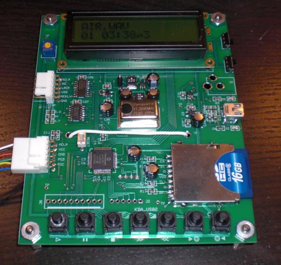

Working so far. I will do LCD string modification and some testing.
4x5 inch, 155g(with battery)
A couple of questions if I may :
a) What are you using for U7 & U8 ? I presume Clock Fan Out & D Flip Flop ?
b) What are the pruposes of SW1 & SW9 ?
c) If I were to use VFD display, what level shifter would you suggest to interface with 5V TTL ? Maxim level shifter ICs ?
And a suggestion for 2x16 Display :
1st Line "D01 Discname T02"
2nd Line "Filename S 00:00"
D01 = Disc (CD, Directory) no. 01
T02 = Track no. 02
Filename = Song title
00:00 = Time played
S = space (so that it shows up as 3x spaces in DIYA), or status (play, FF, RW, Pause, ....)
Probably one character short for proper status display.
What do you think ?

Another question if I may :
What is the play sequence within one CD ?
Does it play according to alphanumeric order, or according to the order the wave files are copied onto the SD card ?
Also, do I have to store all wav filenames as abcdefgh.wav (8+3) or it will just ignore the rest beyond the first 8 letters ?
Thanks,
