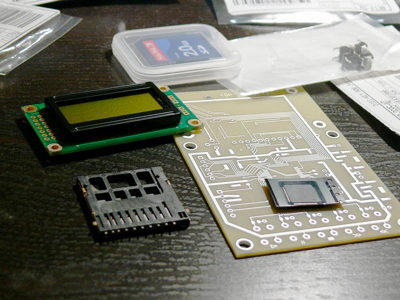

Board arrived.
...I hope it will work🙂

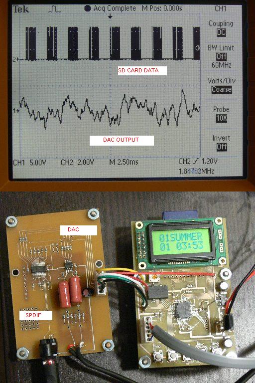

Photos.. (please wait for source. now cleaning.)
Upper image is Oscilloscope.
SD card reading is 2.9ms cycle, and it takes 1.4ms.
Then data copied to DMA memory, transfered into DCI/I2S.
Lower wave is DAC output.
Lower image is boards,
Right: "Ultimate Source" board. SanDisk 2GB SD is used.
Left: Test board, CS4334 and CS8406.
I2S, 44.1kHz,16bit,64bits/Flame, 11.2896MHz master clock is supplied.
Power supply current is 60mA (no DAC/SPDIF) to 100mA (with DAC/SPDIF).
This board works based on 11.2896MHz master clock, so nothing to think about 44.1/48 issues. Hardware is absolutely simple, I can delete nothing. Power consumption is very small, and there are no motors / no AC which creates noize.
Bad: very few sample / knowledges about dsPIC33 on the web. I had to think deep. expensive ICD2 programmer / debugger.
If you love ARM, please use AT91SAM7S256 etc.
improvement:
power supply for Clock, CPU, SD card should be separated to lower the voltage modulation.

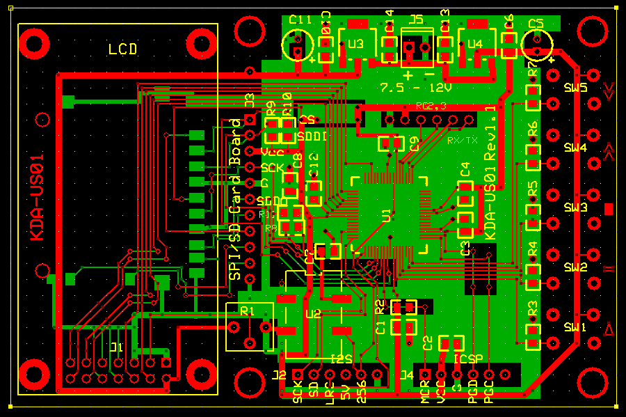

Thank you,
Here is board image. (by ExpressPCB)
Summary:
Minimum hardware from SD Memory to I2S signal
Accurate 11.2896MHz based, no SRC
Static operation
Many limitations:
44.1/16 WAV only, no MP3/WMA
no support for folder, long file name, up to 32 musics
2GB FAT16 Sandisk SD media only, I will not test/guarantee other
can not play too much flagmented file
not thinking portable/mobile use, needs 9V battery
no minutes:second display at playing

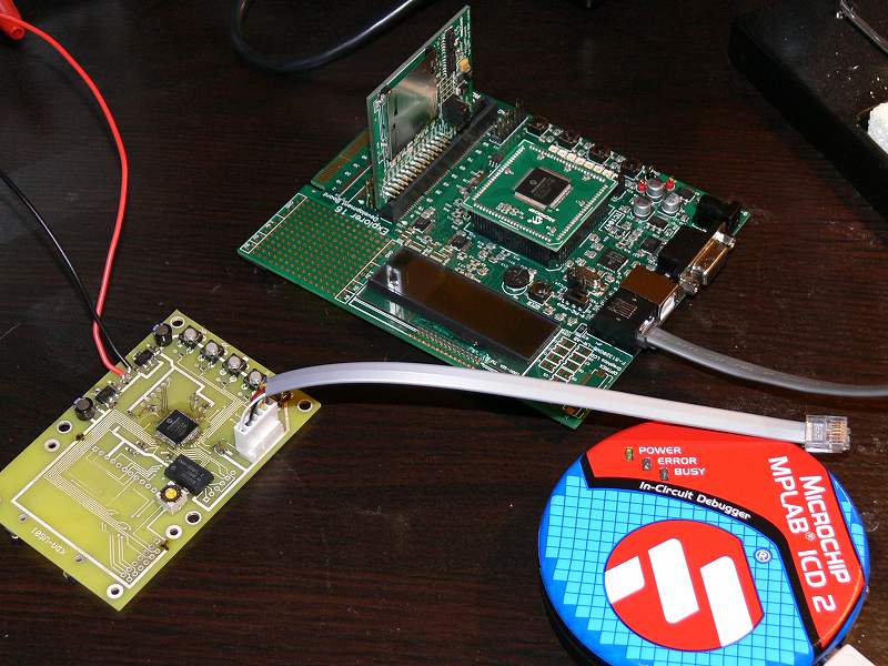

Q. How to replicate?
A. any dsPIC33 board like Microchip Explorer16 + SparkFun SD breakout + Microchip ICD2 will be reliable tools.

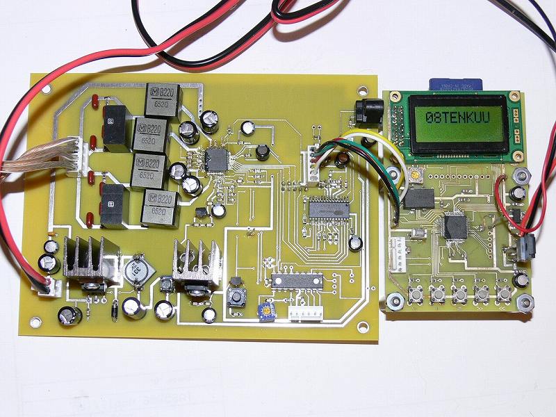

Hi, I made matching amplifier for "Ultimate Source"😉
(for hi-res pics, please see my web.)
Right: Ultimate Source. dsPIC33, SD card direct(SPI), LCD, power/reset/11.2896MHz, I2S output from dsPIC DCI module.
Left: TAS5706 full digital amplifier. CS8416(not used now, no jumper you see) , TAS5706, PIC18F for volume, etc I2C control. (there are thread at Class-D forum)
Sound?
I have no right to evaluate because it's tooooo fun for me.
Now I can play WAV file in SD card, through only 2 IC, direct I2S.
