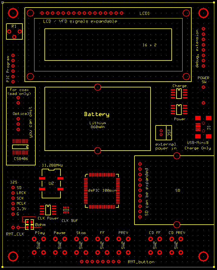

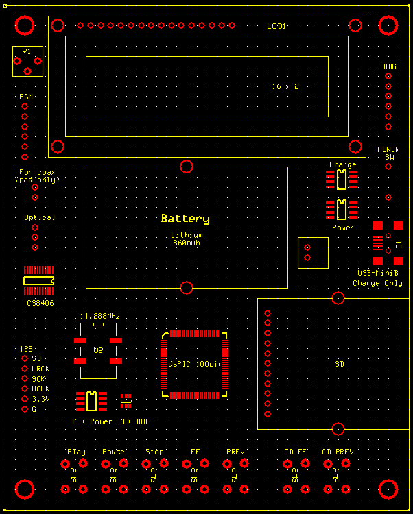

Hi Patrick,
I'm waiting 32GB SDHC card from Amazon....
an interval I'm thinking about next board, after FAT32 implementation.
4in x 5in 4 layer (ExpressPCB 4 layer ProtoPro spec)
http://www.expresspcb.com/ExpressPCBHtm/Specs4LayerProtoPro.htm
16x2 display, 3.3V
Lithium Battery 860mAh for portability
USB-miniB for CHARGE ONLY (note)
SD card holder, dsPIC 100pin (30KB memory)
11.288MHz, dedicated regulator, MCLK buffer
I2S output
Toslink SPDIF optical output
pad for COAX SPDIF output
Play/Pause/Stop/FF/PREV CD(folder)FF / Prev keys
Note: There are no USB2.0 - SDHC writer chip on sale at Digikey etc,
so I will not try USB file management at this version.
Just pull SDHC - and use PC's SD slot or SD reader.

Koon,
Firstly I am very happy that you are giving this excellent solution a update for SDHC. I was planning to build the original version anyhow, but now I can look forward to a more modern version.
Many of the new features you planned can also be found here :
http://www.qlshifi.com/en/wzcapi/qa550.htm
And they even have remote.
BUT, for audiophile use, small size and portability is less important. Performance is the only criterion.
So here was what I had in mind (for my own implementation and probably own PCB) :
1. Only WAV and SD, only I2S out, nothing else, not even SPDIF.
2. "Remote" (>50mm distance) clock11.2896MHz placed close to the DAC.
3. Push buttons on separate PCB via flat cable (for a full size player).
4. Remote control by parallel shunting the push buttons using optocouplers driven by a separate uP.
5. VFD 2x16 linked to WAV player by flat cable (much better than LCD).
6. Everything has its own regulated power supply powered by separate batteries.
This is of course not for everyone, so in the end I might just end up using your source codes and main circuit architecture.
Looking forward to your further progress,
Patrick

Hi ,
oh it's great! almost what I want is here.
so, you want "can be portable and also full sized ready"?
1. of course you can omit CS8406 SPDIF
2. remote clock like this kit? nice.
http://www.diykits.com.hk/OPA.htm
I added rmt_clk input pad, around clocks.
3.4. remote button pad on the bottom
5. VFD for front display?
16 pads on the top has D0-3, RS, E, R/W signals.
6. If you extend and give dedicated power to LCD, SD, button, clk, and omit these parts on the board.... there will be only PIC and 3.3V regulator for PIC, and some 0.1uF on main board 🙂
65/35, 100mil pads can be expanded very easy.
We bought 2. Will report whether it is any good.
Are planning to put an AK4396 next to it.
You want portable, I want fill size. 🙂
No. A modifed version of the Hagclock / Kwakclock7.
http://www.hagtech.com/hagclock.html
Great service.
Plus the SD socket, and lots of connectors.
Thx,
Patrick

yes I want portable, 0.5 inch thin. 🙂
SD is also extendable, you need to place SD slot at front panel.
I'm thinking to use this SD breakout.
http://www.sparkfun.com/commerce/product_info.php?products_id=204
It can be placed on the board or extended to front panel,
Or you can use other SD slot. anyway SD connection is also 65/35 100mil pads.
