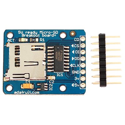

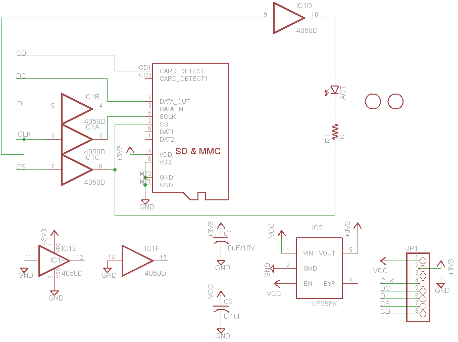

I found a microSD breakout board with an activity LED, which I think it would be neat to have such an LED. Attached is a picture and a schematic.
