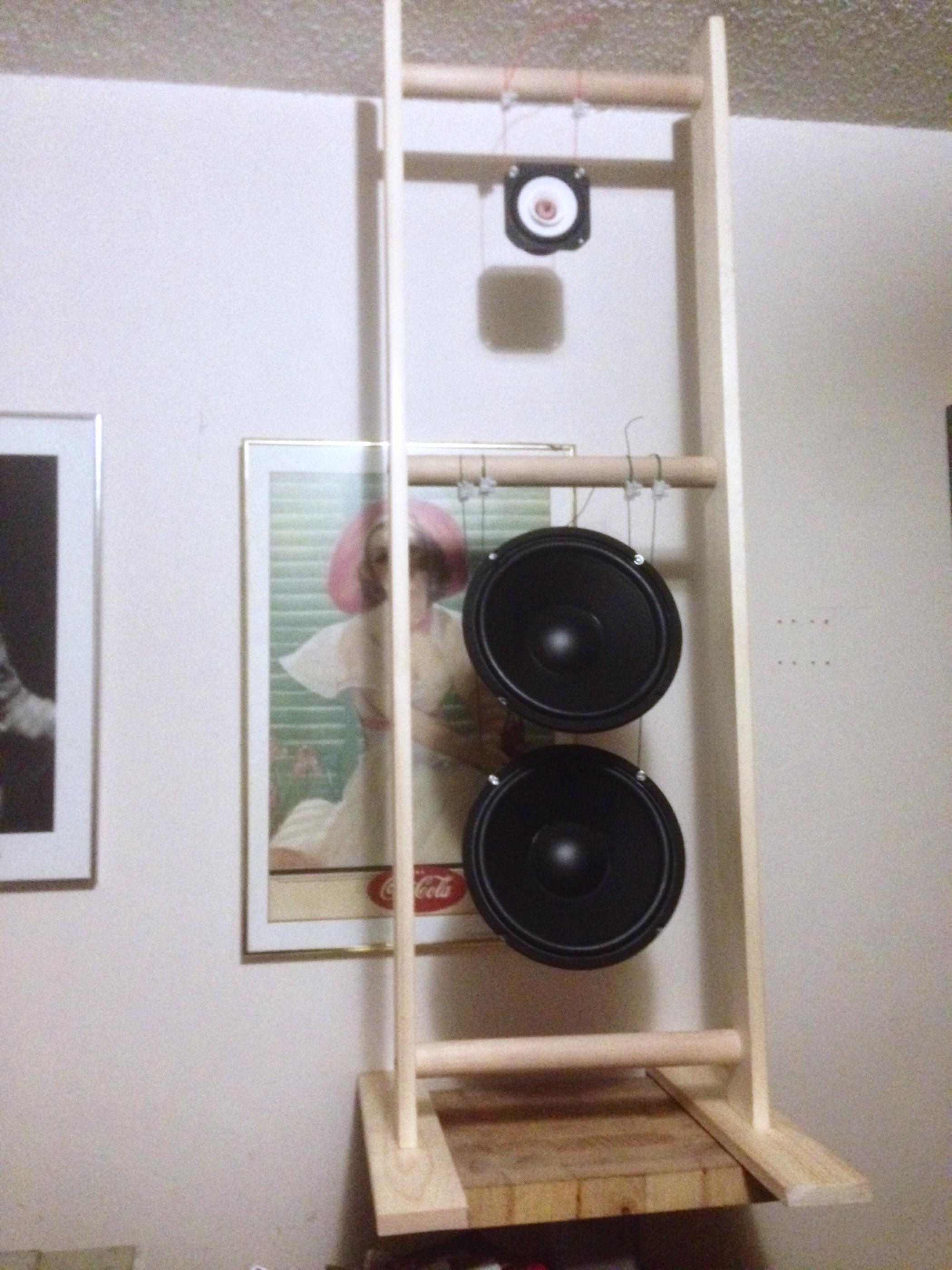

Try rubber bands
And use some also on wf's magnet to align them
Put felt on the back and around the mid-tw
Of course the bands holding the woofers would need much more elongation
Try rubber bands
I did consider rubber bands, but have none at hand, and the couch grabbed me.
I was only considering the rubber bands for the Aucharm, and may just apply a little sorbothane pad between the woofers' hangers and the dowel they are wired to.
Is the felt to dampen reflections, or to damp vibrations?
I've been thinking just now a similar frame with more rungs would be good to hang end of the roll carpet, or maybe soft foam on/through, with varying length of folds to help damp front wall reflections behing the speakers.
As for the woofer alignment, it just needs longer bolts to reach the balance point.
Thought of this last night, about 25 minutes before the lumber store closed last night- I guessed wrong about the depth of balance point.
Can't anchor a magnet lifter far enough back to lift the woofer dead plumb, it just de tensions the current hangers.
I will for sure try rubber bands on the mid/tweeter, thanks .

The solution is...Can't anchor a magnet lifter far enough back to lift the woofer dead plumb, it just de tensions the current hangers.

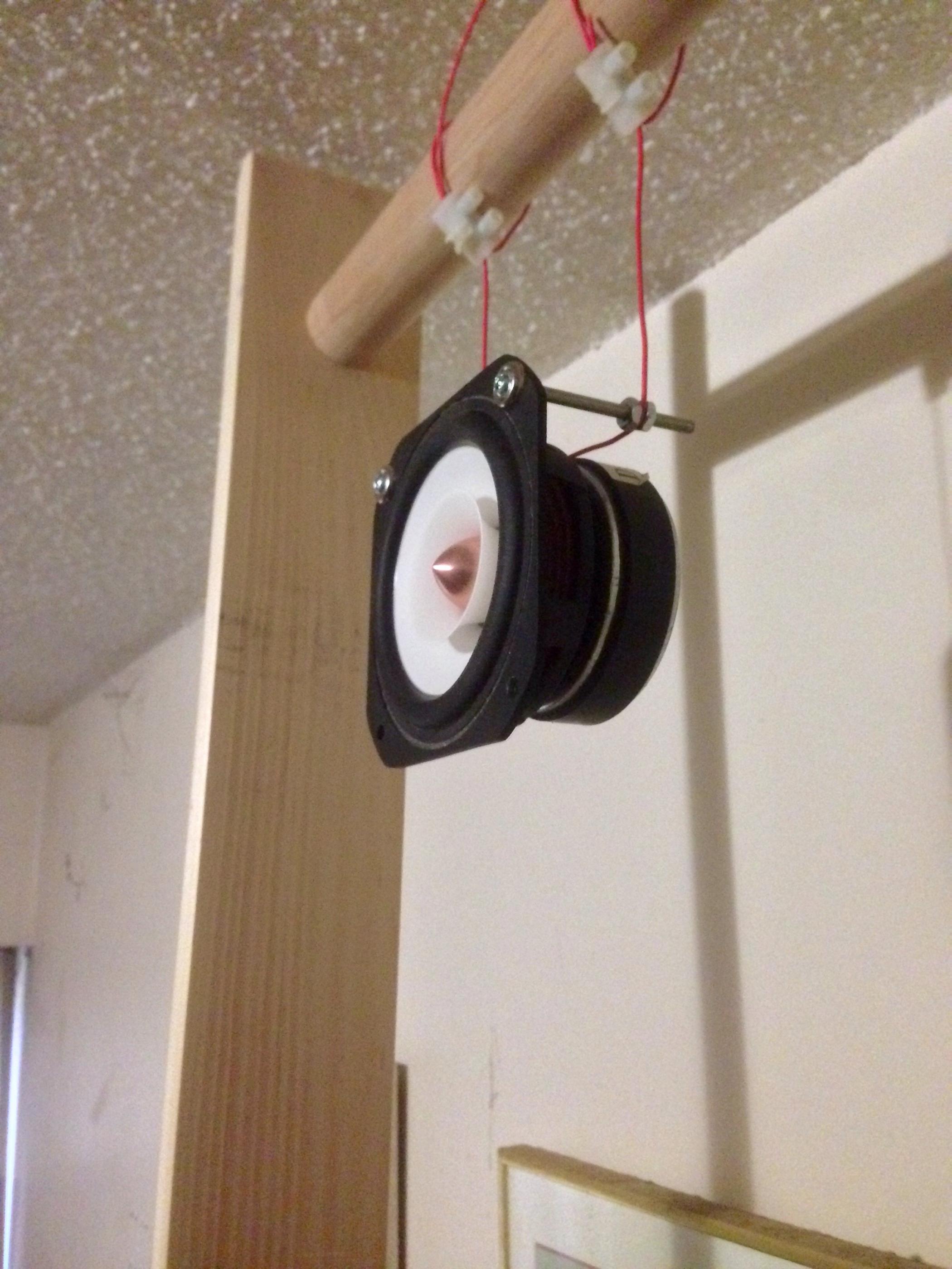

Like you did on the mid-tw unit, just hang it a centimeter or more from the front ( you can try also metal L's )
And about the de-tension...well, you know...rubber 🙄
But the point is to make the drivers "bouncing" i.e. oscillating at subsonic frequency, so much more lenght is required
Thanks, I will use a longer bolt to hang far enough to balance the driver.
Do you mean the pendulum length is critical, or the de coupling of a springy driver hanger?
Or, perhaps, both?
Thanks for the pointers🙉
Yes, a spring! Look ar " Linear elasticity" at Wiki page Elasticity (physics) - Wikipedia, the free encyclopedia
So just choose the right diameter of elastic ( strains ..) related to the load.

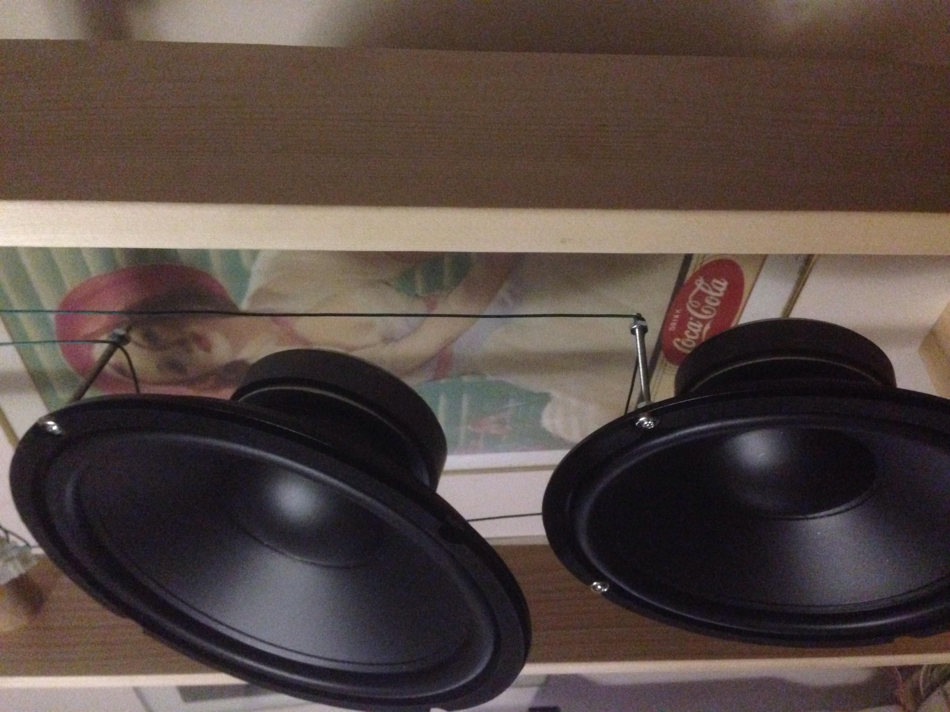

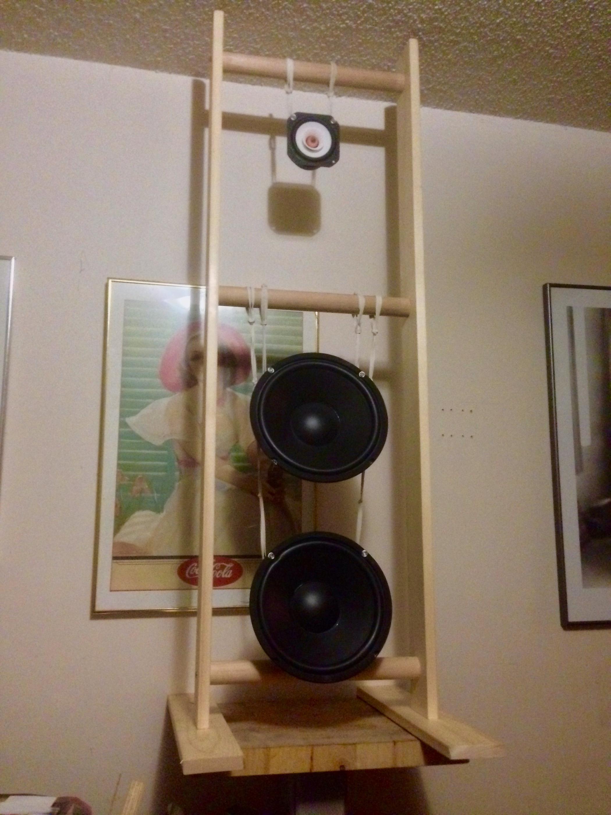

Rerigged it per your suggestion with elastic bands.
After plumbing the woofers vertically, I put them back , tilted up 4 or 5 degrees. This seems to have less floor bounce to mess up bass and lower voice.
Can't say I hear an improvement with elastic over copper, but it's always a comfort knowing one has attended more details.
And these drivers have almost no time on them as yet, so who knows?

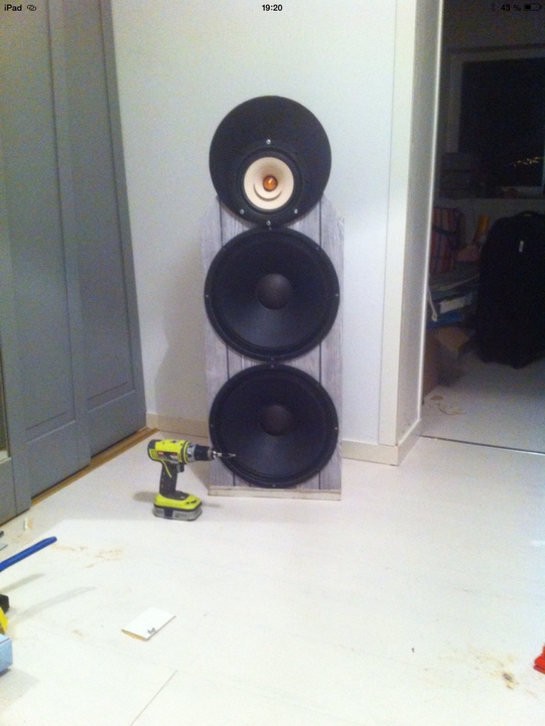

Twin 12's, flat honeycomb neodimium driver and a neodimium ribbon driver.
Hand made pretty slowly, but now operational and they sing just beautiful.

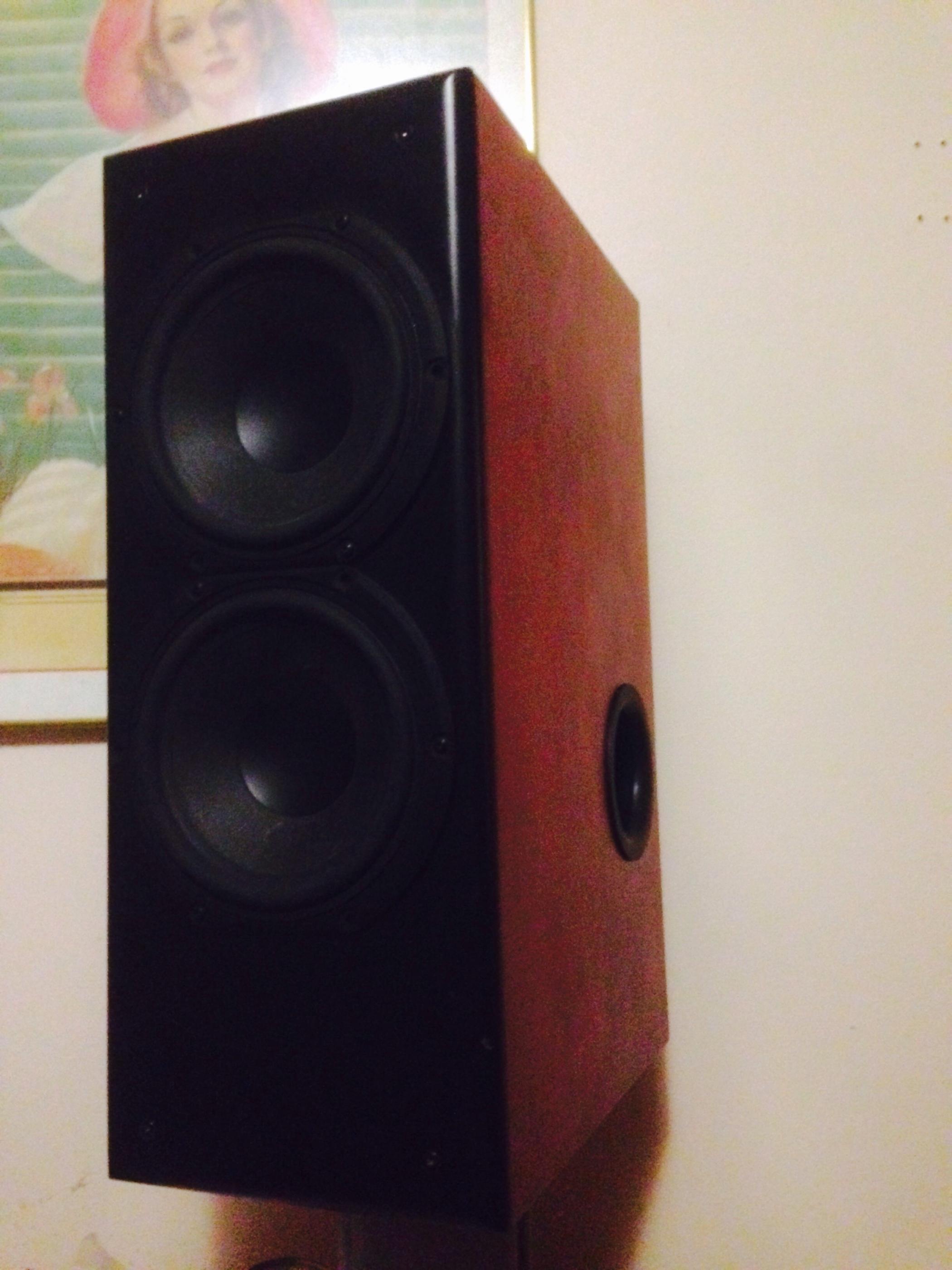

Will be supported by a 16 Hz fs, 20 Hz fb bass reflex cabinets.
I wasn't gong to listen to them without the bass cabinets, but my curiosity was too big... They actually reach 30 Hz effortlessly, only the peak spl is somewhat limited with the 12's working this low, but there is enough headroom for enjoing music like this.
Designed with MJK's Mathcad 3 drivers acive sheet.
