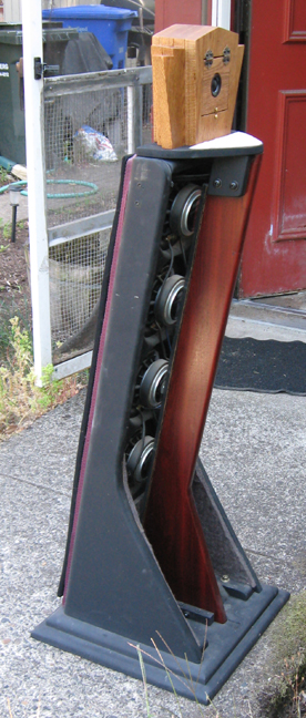

Thats pretty exotic
I also like to know about the two tweeters, it does look good...
it's for stereo...🙂
I tried one Neo 3 and while it sounded very good I preferred the greater output of two. With their rear covers removed they radiate to the rear.
Are you using the "3", or the 3 "pdrw"?
I'm still trying to get the best out of the "3" paired with a Neo 10, backless.
It doesn't seem to keep up with the 10, in spite of similar efficiency ratings...

Yes I removed the the back covers. They pop right off with a knife. Tried them firing in opposite directions but found no advantage.
One of each type.
I tri-amped with an Ashly crossover. Don't recall the settings as I sold the Tang Bands after buying the Lowthers.

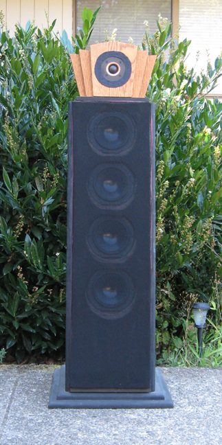

My system is triamp'd 4th order and has active EQ. There's a separate woofer box on each side. The rear facing tweeter only does above 13kHZ. X = 100HZ and 1.4kHZ. I'm using the XXLS Peerless 12 inch woofs, Peerless 5 inch mids, and the Seas Milenium 1 inch dome tweeter. The rear tweeter is a Dayton 3/4 inch. The electronics is all OPA2134 opamps, polyprop caps, 1% metal film R's, etc etc. Hafler DH220 poweramps on bass and mid, and a 30 watt tube amp I designed and built on the tweeters.
For those who don't know, OB speakers must be out from any walls by at least 3 feet or there's bad psycho-acoustic effects.

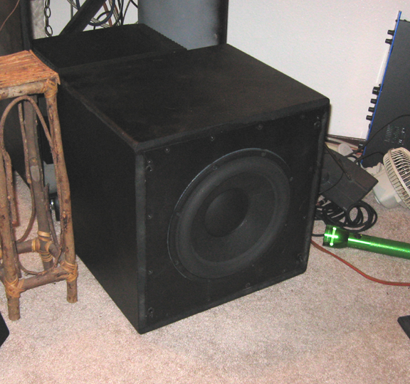

Lowther DX3 powered by 2a3 Bottleheads
Alpha 15A's in parallel powered by Yung class D plate amp
Ashly active crossover
