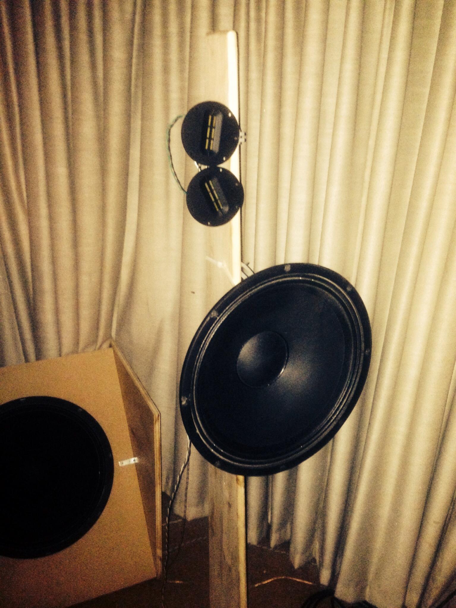

Two 4" Monopole AMT tweeters, paralleled for a 4 ohm load,should be 94db/watt, but seem louder, stacked to limit vertical dispersion, a little tilt to tweak that a little.
1 15" Trace Elliot (by Celestion) midwoofer, 98db/watt, 8 ohms nominal.
61" tall, 5" deep on top, 9.5" deep on bottom mast, laminated pine- routered notch to carry magnet of woofer and time align tweeters with the woofer.
These are actively crossed over at 2500 hertz, and 250 hertz to a now corner loaded, diagonally firing 18" subwoofer in a roughly 2' cube/ tilted H Frame, which sounds better with no top.
As a postscript, these really came together with some 22 gauge Clairvoyant occ gold plated speaker wire I made, simple twisted pairs, and interconnects I made with the same wire, also twisted pairs.
The fancy wire is unnecessary on the woofers, I couldn't hear a difference there.
Good thing my inexpensive active crossovers came with "Maximizer" tone controls.
This system is voiced for tone controls bypassed for vinyl, a boost at high and low frequencies for cinema and TV, and the treble needs to be cut a little on CD.
It's that revealing now.
I know these aren't open baffles, but they're close enough, and will likely be the last main speakers I make for my own use.
I'll never go back to monkey coffins.

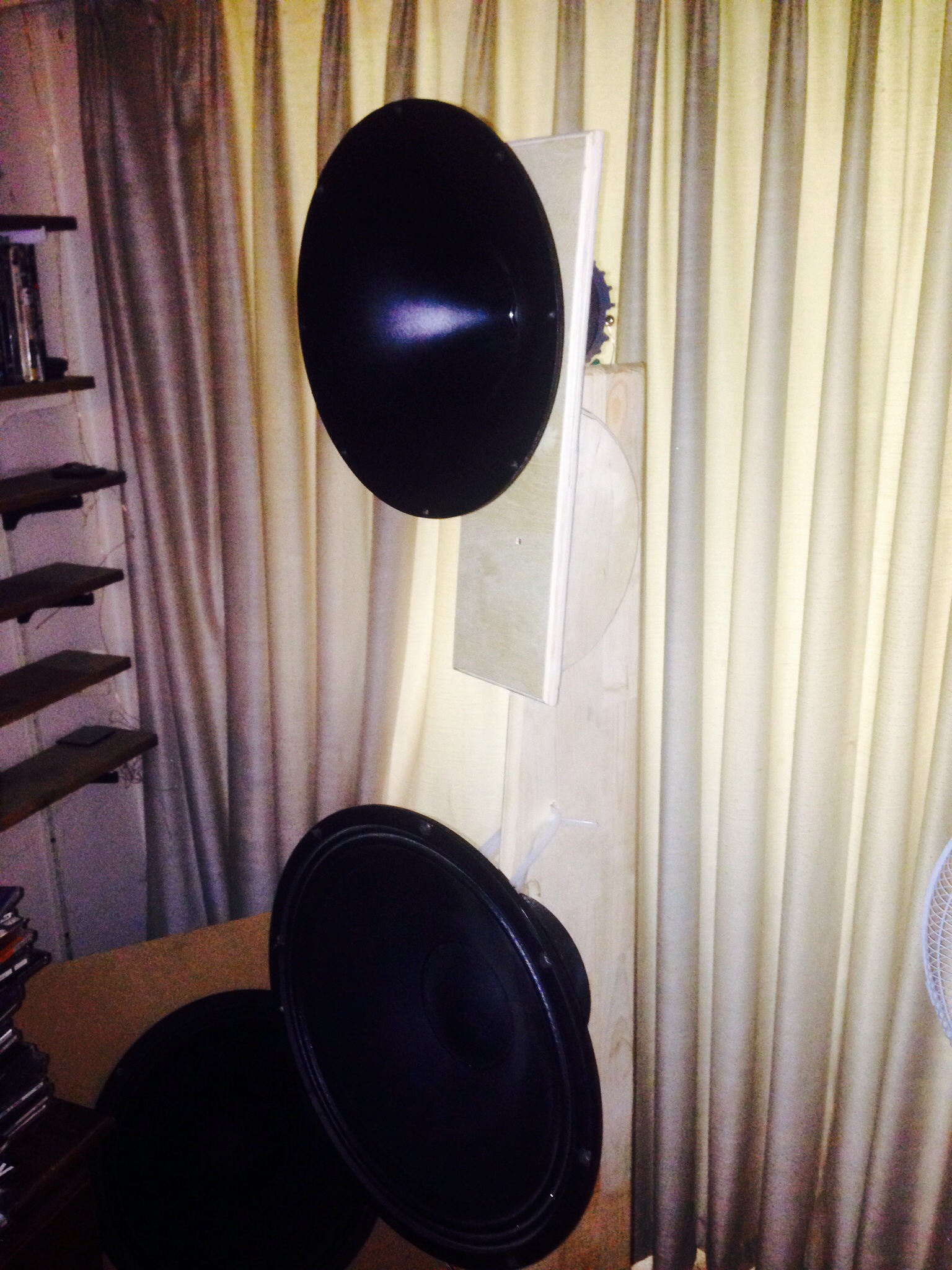

I have some 12" waveguides from a dismantled build, tried these, as I really like constant directivity treble combined with the ambience of dipole mids.
The Fane compression drivers are smooth, and handle the 2500hertz crossover point better than the AMT's, which are really at their best from 5000 hz and up.

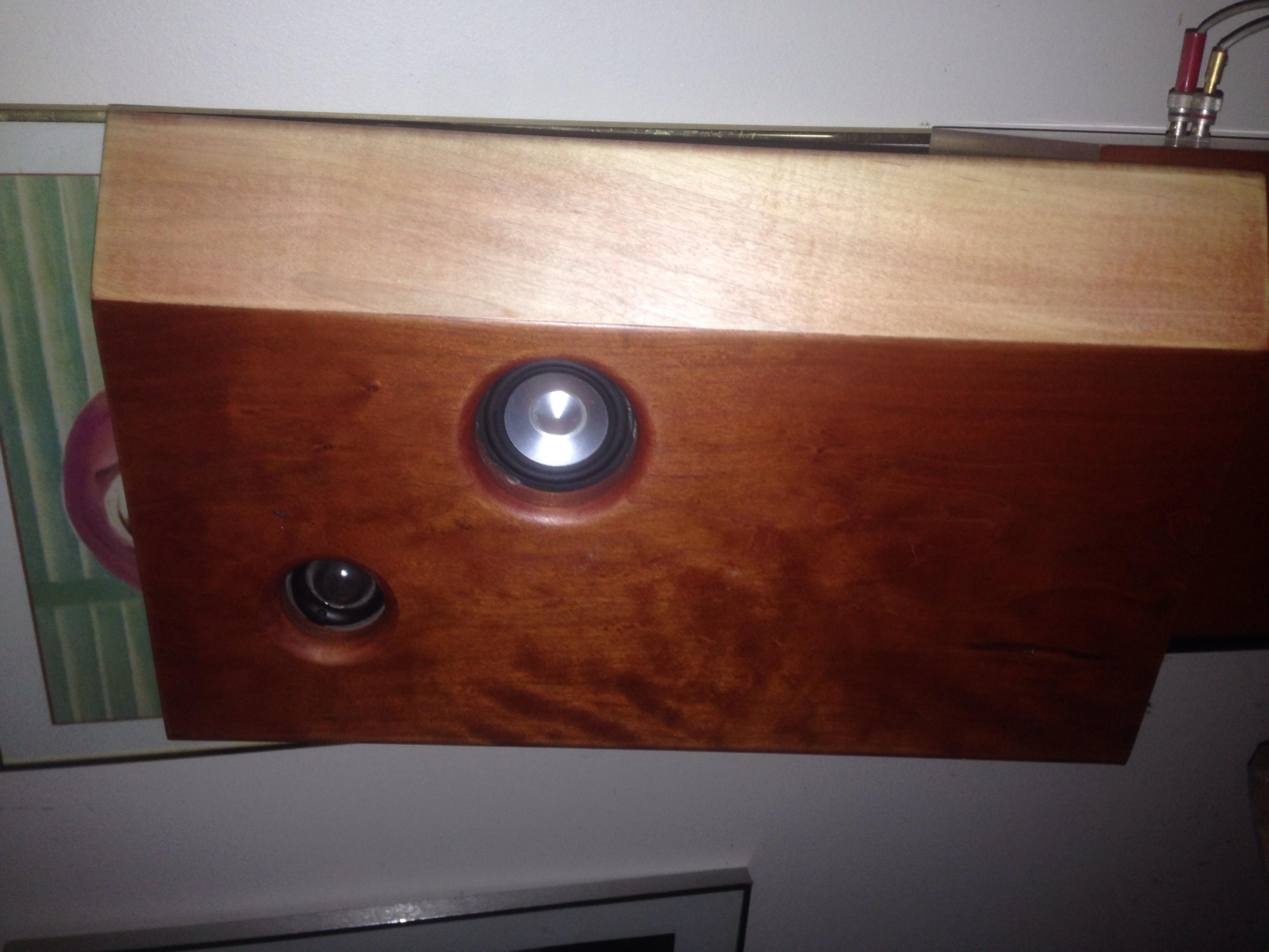

These are CAT 408's, Morel, with 2" EJ Jordan .
Solid cherry and maple, with tung oil finish.
Not quite efficient enough for 6 watt amps, but nice sound.
The Jordans almost don't need a tweeter; if your listening nearly on axis, they don't .
