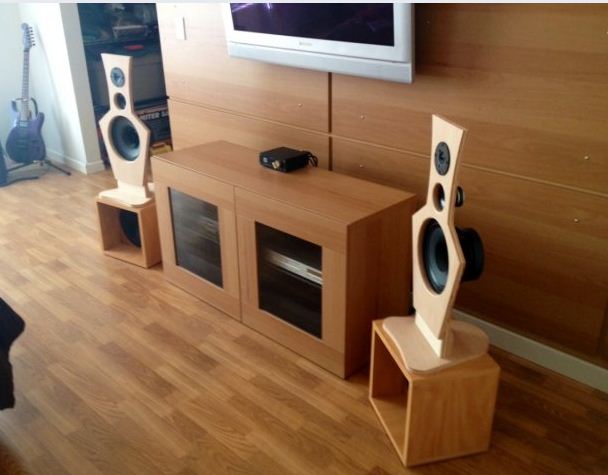

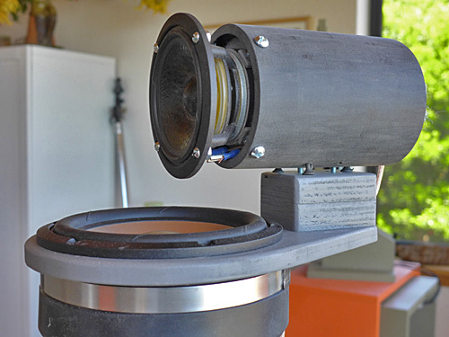

Converted complicated resonance generator to plain open baffle .
I will be making the topless h frame's finish match these.
With an active crossover , these (neo 10, neo 3) sound pretty good on bad recordings , and stunning on good recordings.

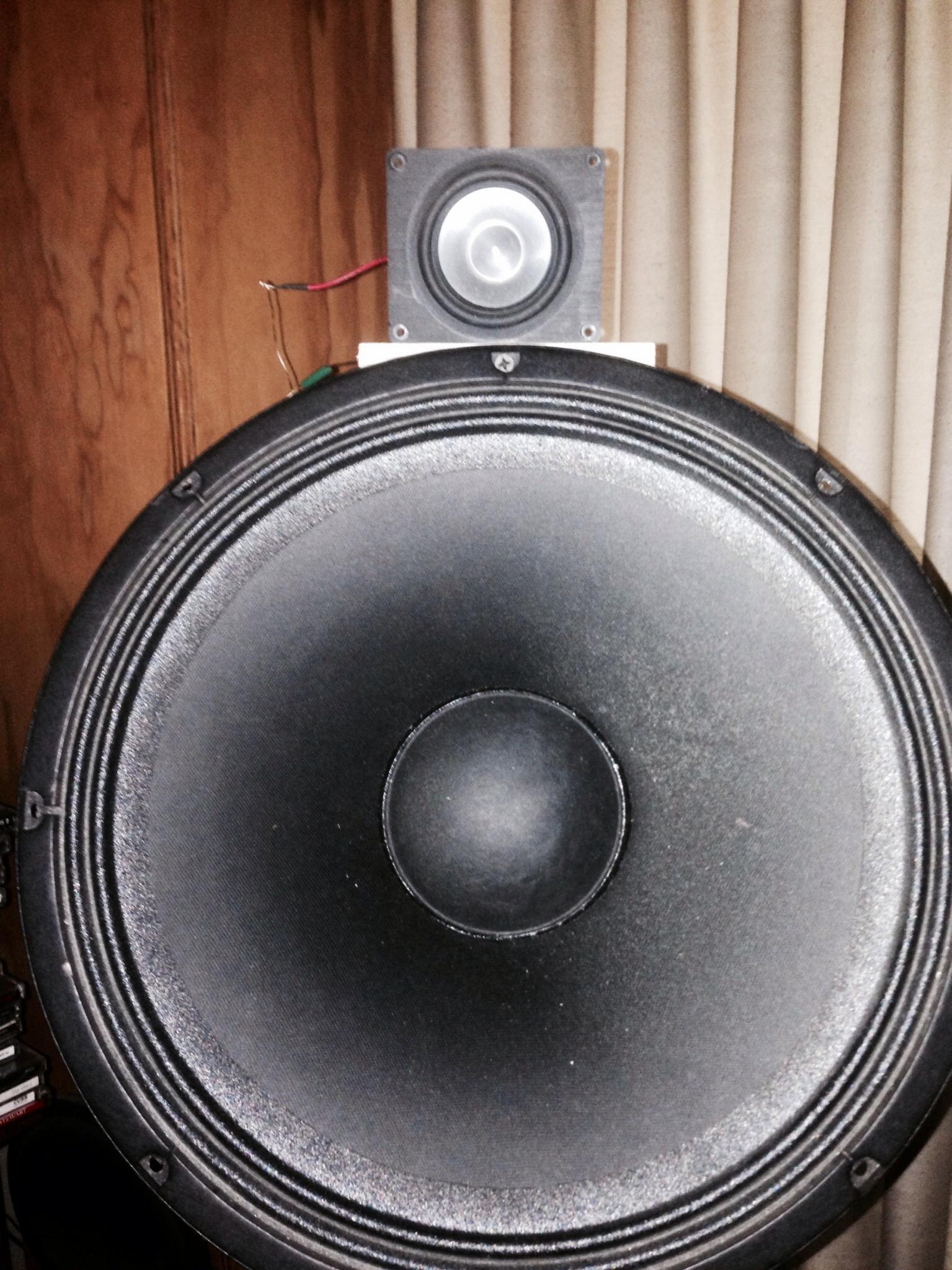

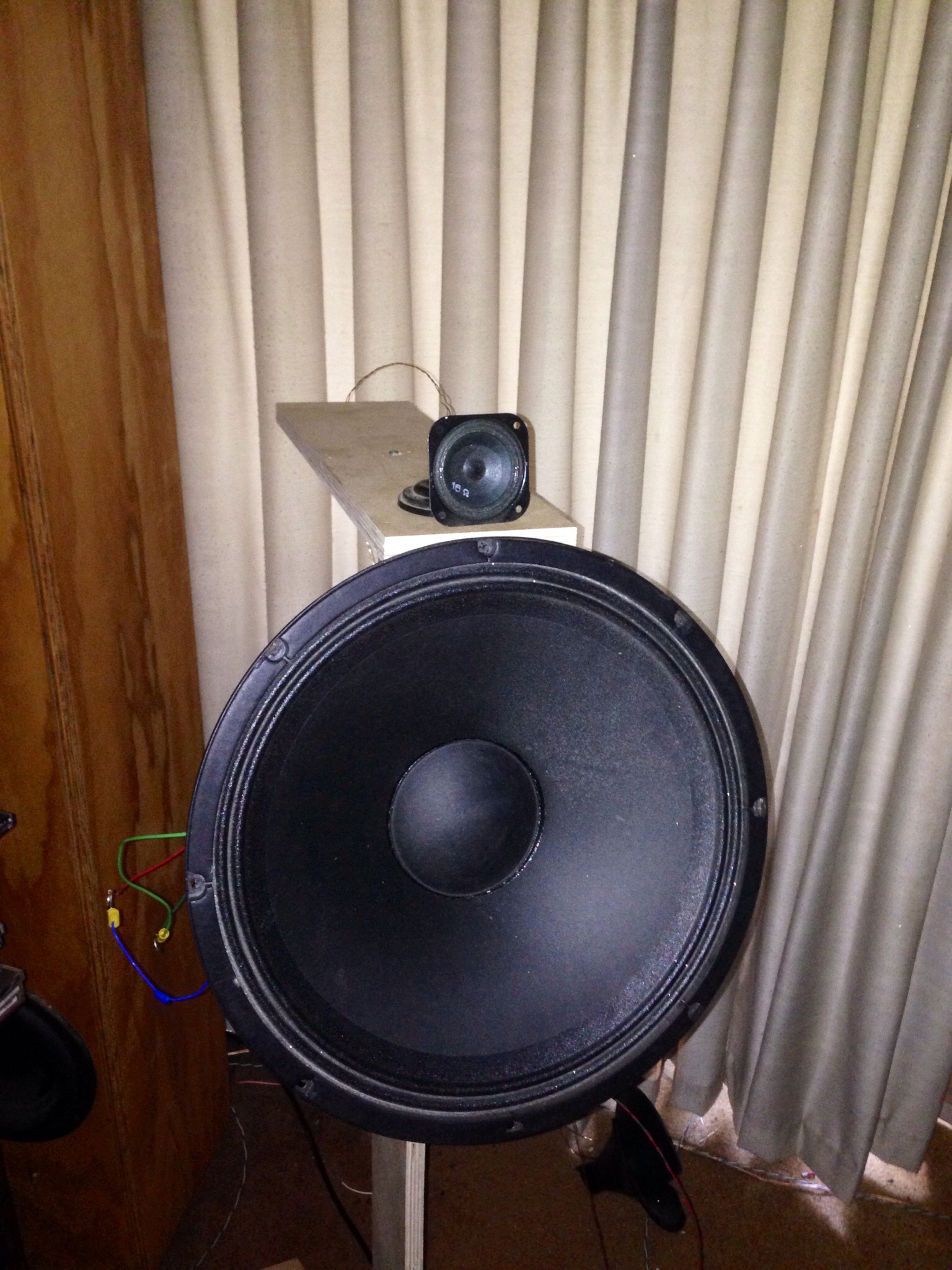

Too much time on my hands...
Same skeleton/ mast idea, tried already with Seas 21tv, now with Peerless 2" vintage paper alnico 16 ohm tweeters.
Slam is fantastic once the crossover point is dialed in between the 15" Celestions and the 18" Podium with the plate amplifier.
Will be swapping out the Peerless for a AMT Heli pair from Taiwan this weekend; the Peerless sound good, but better matched with the similar vintage Seas.
Any ideas on how to make these look more palatable?
I'm pretty sure this ( baffleless) is my future road.

It seems you have many drivers around. Why not make some arrays? It helps a lot in the lower range and dynamics.
A while ago, I made an updated version of M&K S1C's, and ever since then, I've preferred the ease of building satellites with no deep bass shaking either a cabinet or baffle around.
This no baffle stuff I tried as a lark, for something easy to to do one evening, but it seems worthwhile.
I'm just messing about with different combos and rough builds until I find which I will pursue for real.
So far it's like choosing between ice cream flavours- they're all enjoyable.
Thanks, CLS

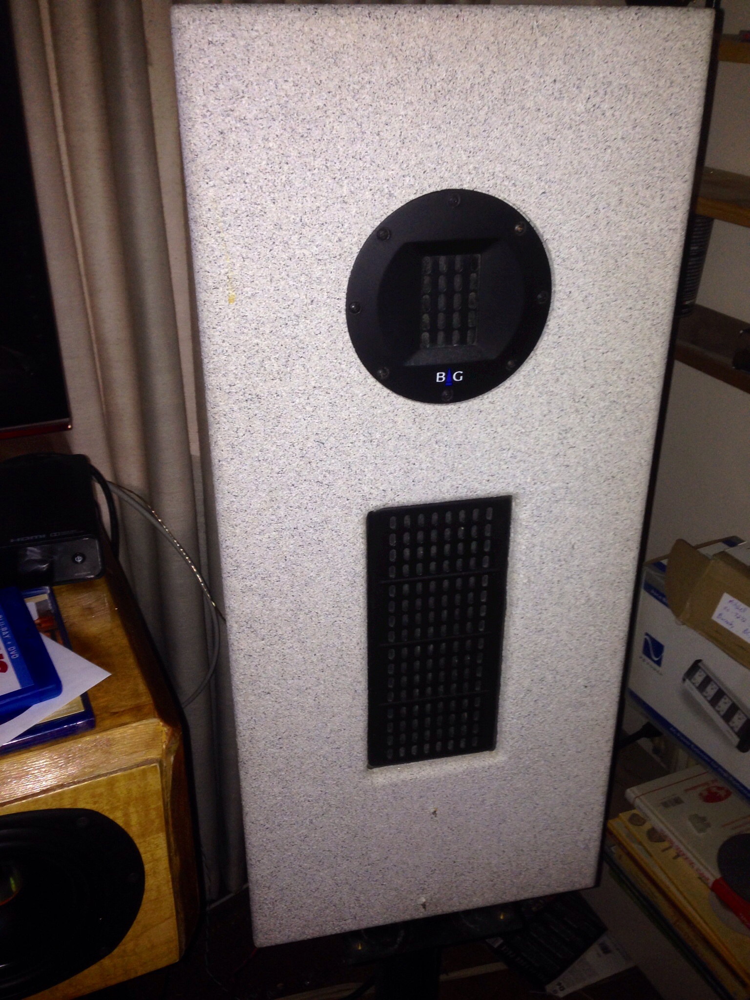

Very cool. I will be trying something similar (cutout for the magnet within the mast). Read your related post: I forgot I still have a pair of 2" EJ Jordan speakers with a good qts., I think I've found the right tweeters .
Surprisingly, as tweeters from 2500 hz up, they play loud enough to keep up with the much more efficient 15", and 18" drivers.
And are wonderfully smooth and detailed, possibly because their filtered point is 25 times higher than their free air resonance.

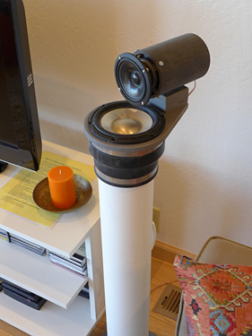

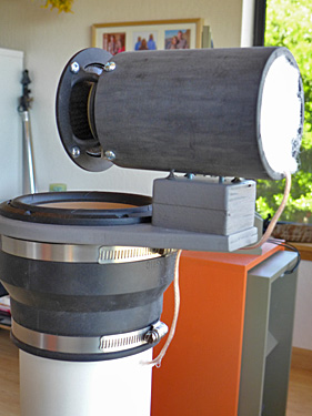

Helmholtz dipole?
The most curious OB from a genius designer.
linkwitzlab.com/LXmini/Introduction.htm
Really cool looking. I would consider this to be a quasi dipole.
It does have back radiation to a degree; modified by a little cavity resonance to enhance output at the crossover region, with less excursion.
I saw something similar with "side" radiation from Gradient years ago. Their slots were designed to radiate out of phase sound from behind the cabinet's baffle, said to enhance imaging.
I have nothing to scale against- my best guess is that bass tube elbows to the smaller one, resulting in a sealed transmission line quarter waved to about 45 hz?
Looks like a smart design, and ought to image like well, with minimal room interaction through the vocals up...
