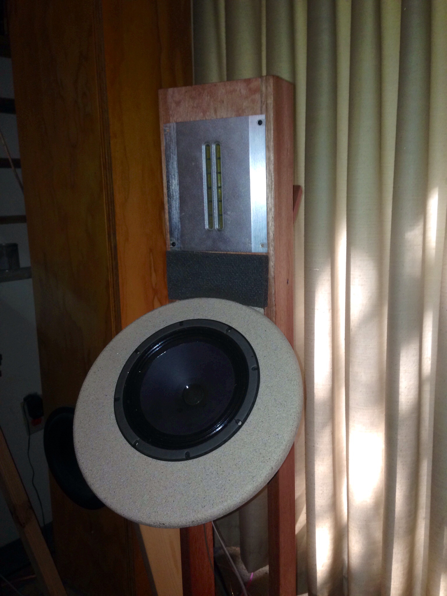

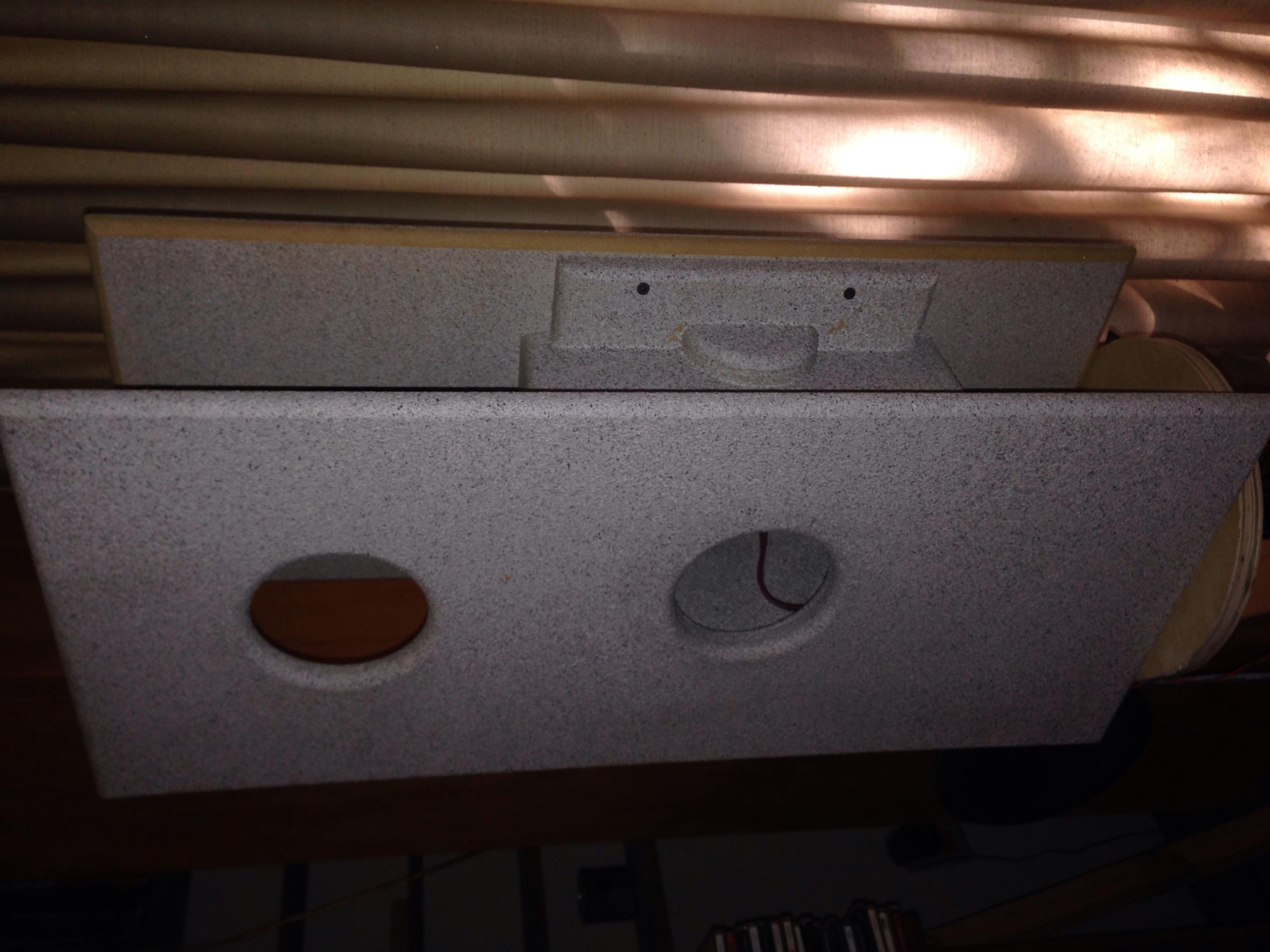

First shot at open baffle, near miss , I guess. The port opening is 4", directly behind the neo 10, tuned to act as a 300 hz Helmholtz resonator, AND act as a quarterwave transmission line to fluff up the neo 10, which is weak from 800 to 150 hz on a plain open baffle.
The tweeter is a neo 3 , with the cup removed, and a 4" hole behind it in the rear baffle.
These are actively crossed over, 4th order, at 175hz, and 3000hz.
I'm currently using a tuned to 25 hz transmission line sub, but am wondering if a smaller, sealed isobaric sub might be better suited to match these(no box resonances through the isobaric loading?), as I've already got two nice 10" sub drivers and a decent plate amp.

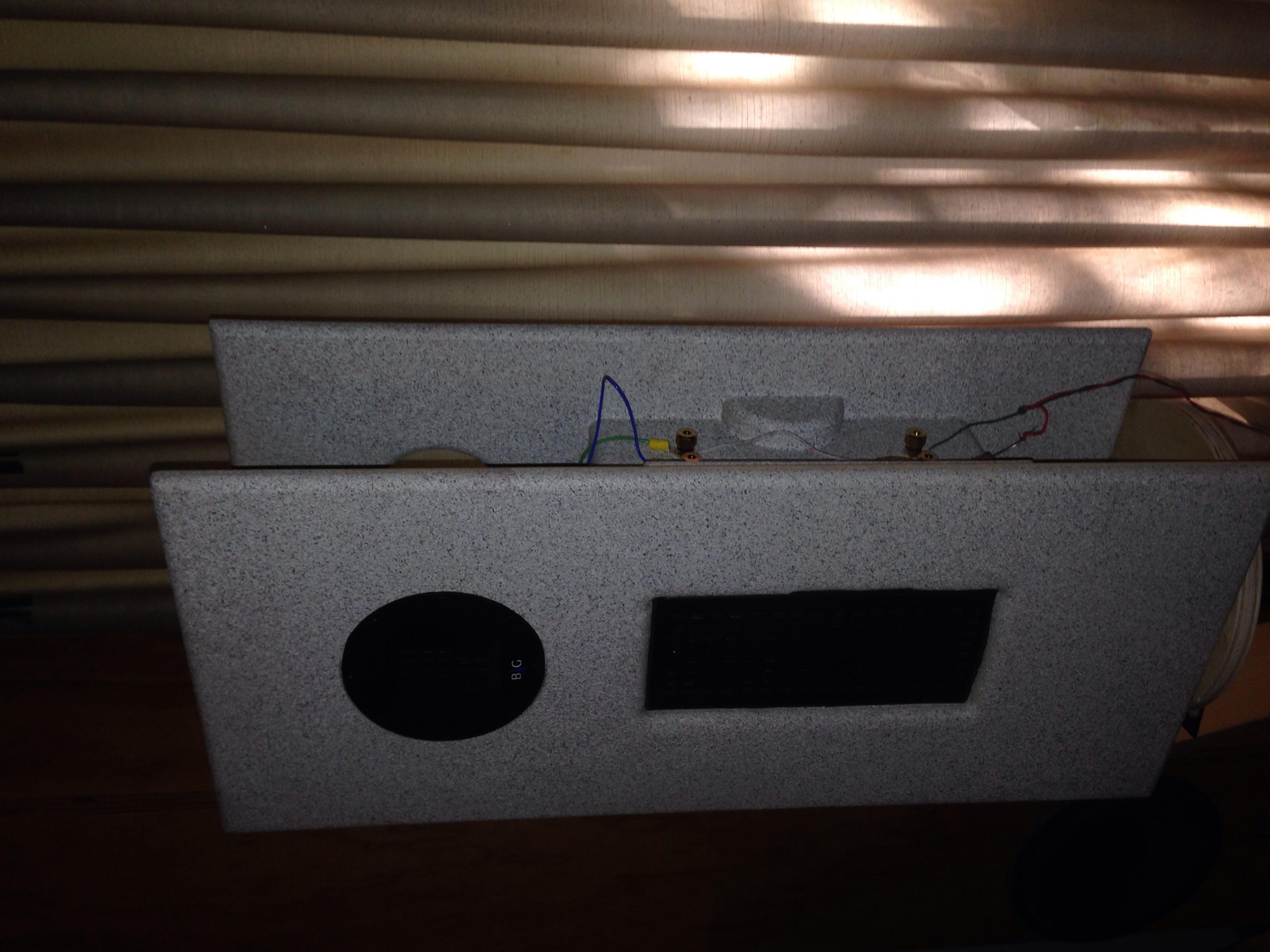

Second shot, much easier build.
These are some isodynamic ribbons I got on clearance pricing a couple years back, paired up with some 1970's vintage Seas tv 21 woofers, as open baffle as I could make them. They list at 96 db/watt, 3.5 dcr, and a qts of 0.707.
They sound wonderful, crossed over at 150 hz, and 2500 hz.
Awaiting some vintage alnico Peerless 16 ohm paper tweeters, possibly a more suitable match.
I recently tried some $3.66 dynavox phenolic ring radiators ( the cone is paper) and was amazed at how good these sound!
Won't turn up my nose at paper tweeters without a listen ever again.
Very little eq'ing required to get great sound out of those.
