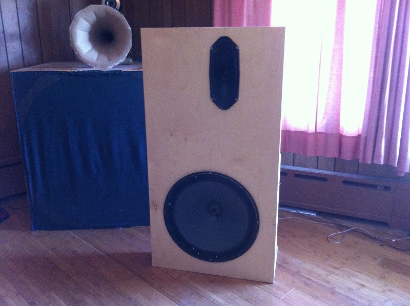

I was inspired by a similar AK thread and used a pair of these unique Morel Integra-300 coaxial drivers on a piece of leftover OBX. I was amazed at how much I liked what I heard!
I've decided to take the OB concept further and build some baffles out of hardwood plywood. I'm still very confused about how to manipulate the bass frequency response for the best effect. If anyone can explain that in "street language" that would be great!
First question, should I center-mount the drivers on the baffle about 32" A.F.F. O/C from the floor? Or should I "mirror" the drivers to one side or the other?
THANKS!
For a crossover, I am using a very rudimentary "filter and choke". All drivers are left unattenuated for now. Once I get the baffle figured out, it will be time to tweak the crossover.

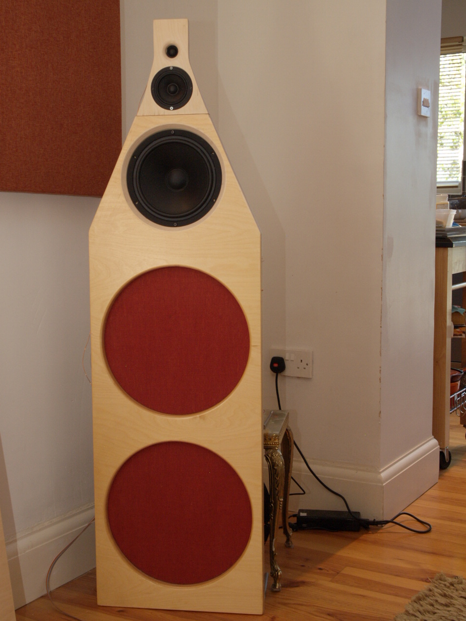

My old OBs were always a bit of a prototype and a compromise, I wanted to do it properly designed from scratch with new drivers. Eminence Beta15a with a 1st order 250hz low pass. wide range mids are a Celestian 5" buyout, super flat to 5kHz and subsequently have a band pass from 250hz to 5kHz. The highs are handled by a Dayton Audio PT2C-8 Planar Tweeter which for the money cannot be beat and outperforms ribbons 3 times its price. 2nd order 5kHz highpass on the PT2C-8. last photo is a shot of the old being replaced by the new.
Did you use countertop from IKEA? I thought of that too for mine, but figured I'd try with plywood first. NICE!

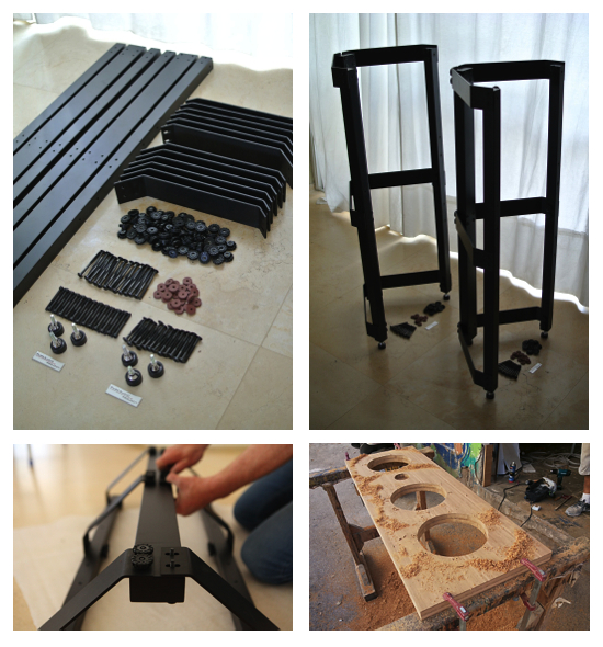

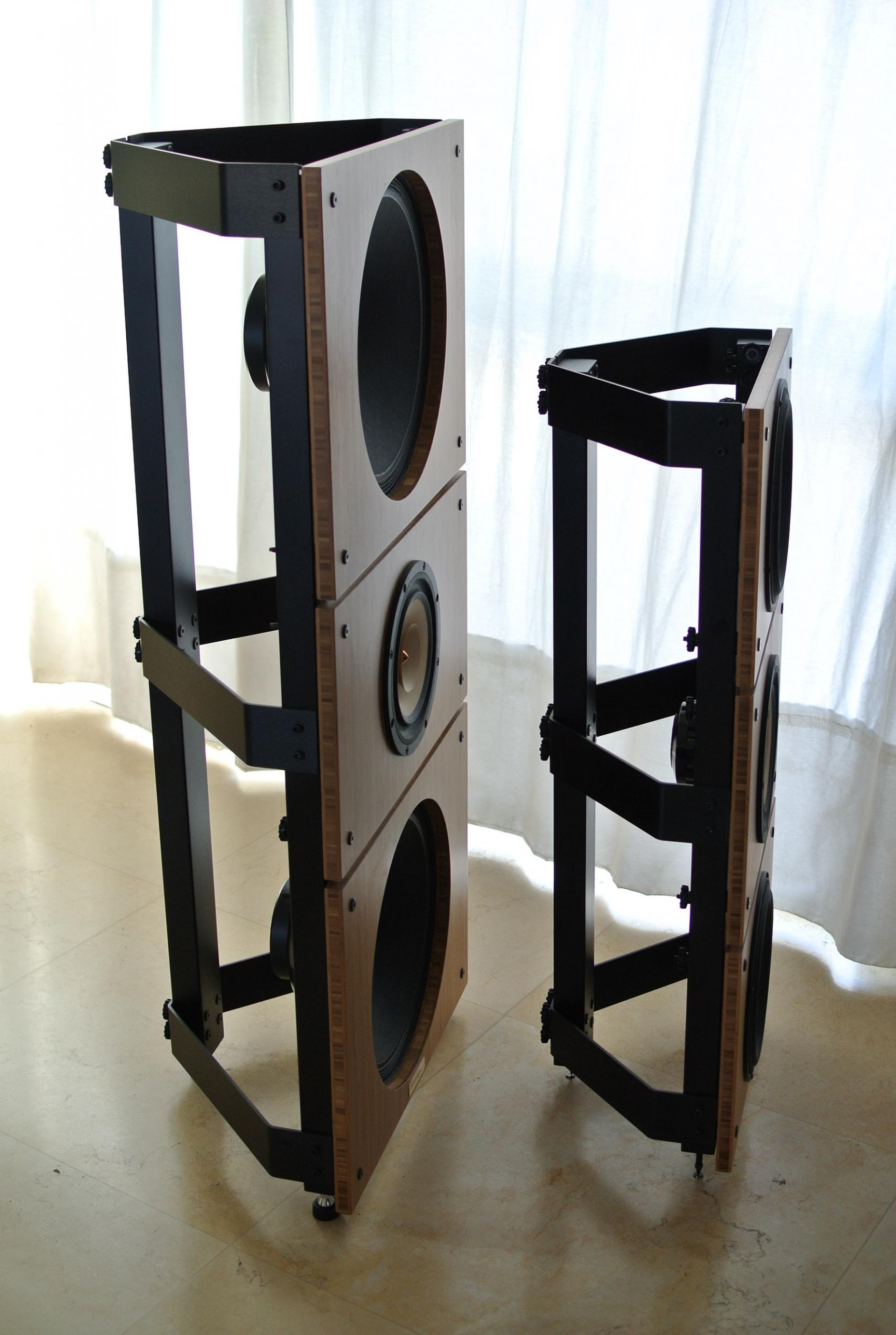

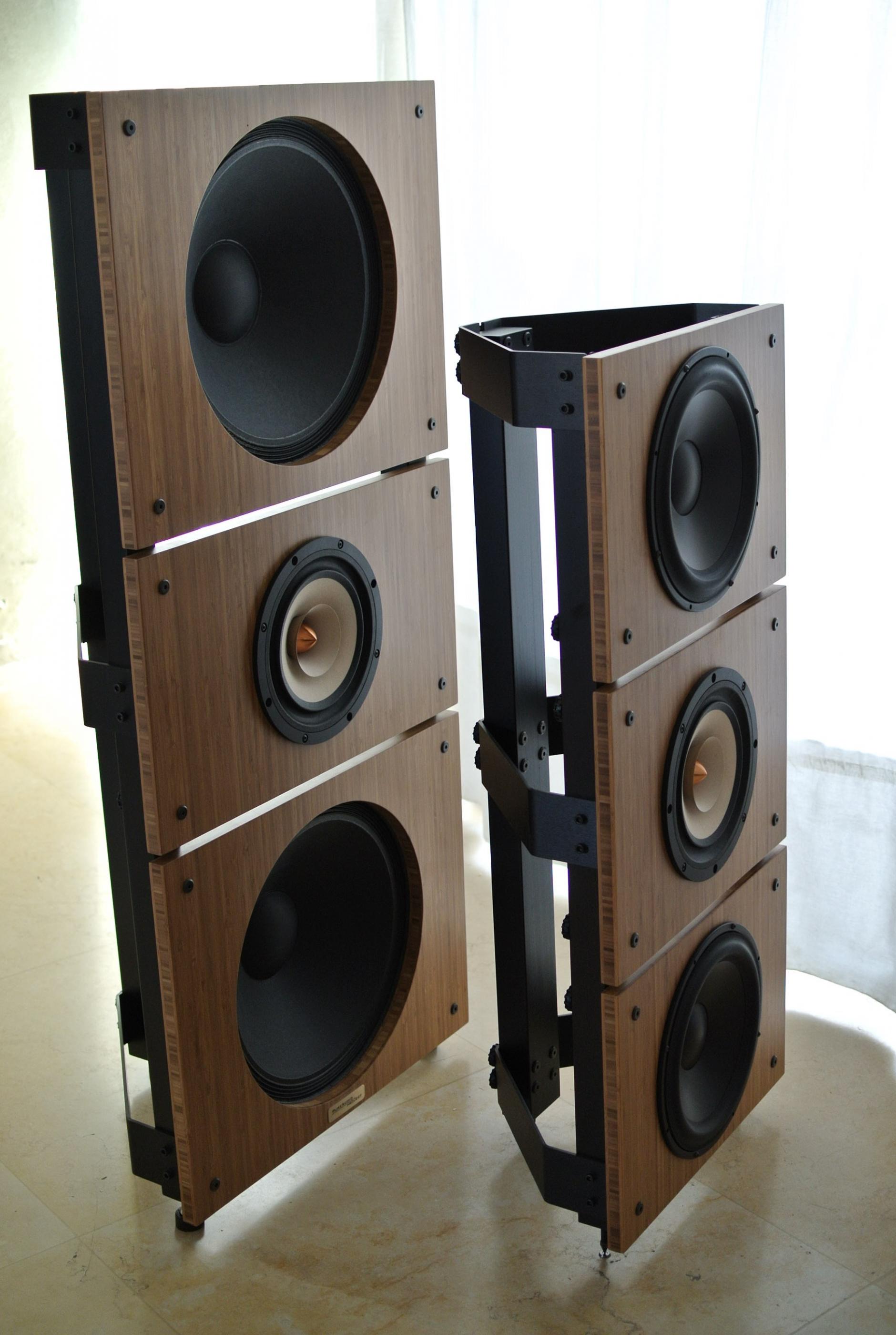

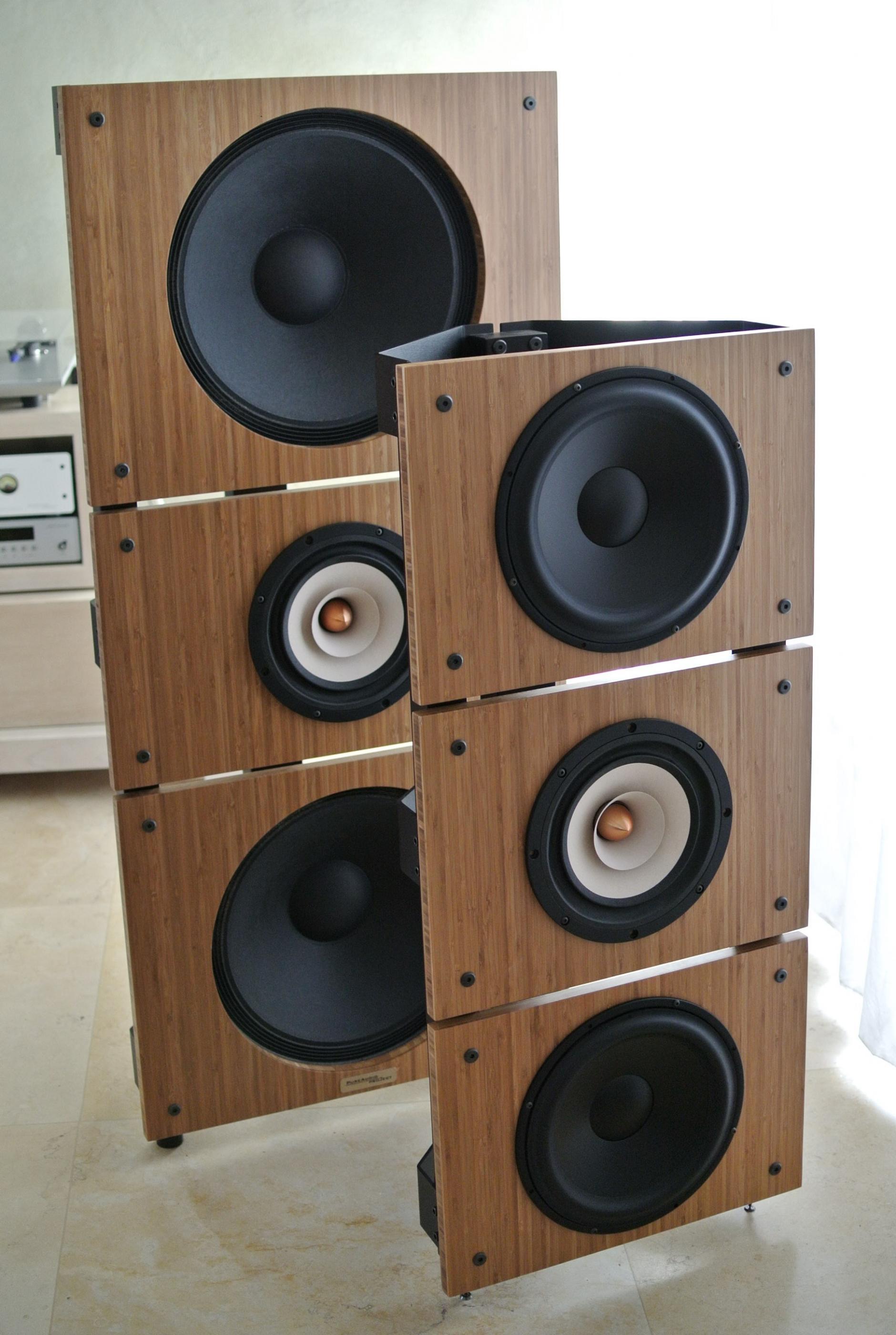

Open Baffle HW KITS form a robust platform for almost any desired OB DIY project. Assembly is tool-less, breeze simple and fun
Plan your OB project, cut and finish your desired baffles and simply mount them (and the drivers) on your HW Kit.
Two models:
- Tower15 HW KIT is designed for drivers up to 15"
- Tower10 HW KIT is designed for drivers up to 10"
Wood feet come in standard length (92cm and 114cm) or cut and drilled to match any custom baffles configuration !

and the 10" uses custom tooled Morel MW-1075 drivers.

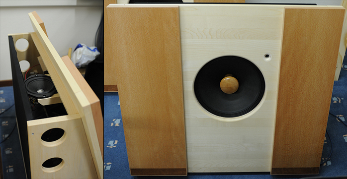

Musical Affairs demonstrated their loudspeaker designs based on French EMS Fertin field-coil widebanders ...
... the EMS field-coil based open baffle loudspeakers called the Mini. In addition to the 30cm woofer a midband driver is on duty under the top cover. The treble is handled by a small tweeter in the baffle. Musical Affair’s Hans Kortenbach claims inspiration for this design by Wharfedale’s Gilbert Briggs.

More pictures of these beautiful dipoles from here
http://www.musicalaffairs.com/home-fieldcoil/
"Mini Baffle"
Notice the speciality of ceiling firing small midrange, the essential part of the original Briggs SFB.

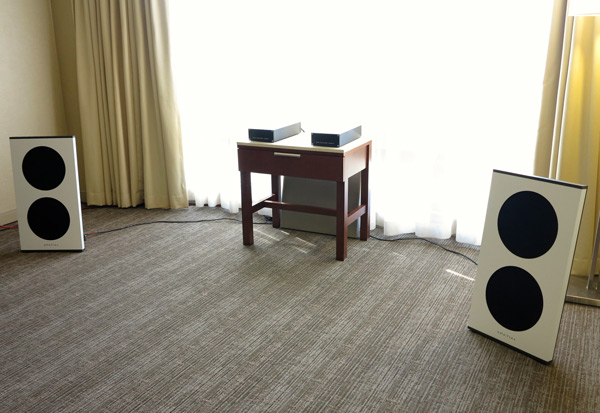

Nice Briggs clones:
6moons industry features: X-Fi 2012 with Marja & Henk
Quote and image from above link.
AudioRoundTable.com: LSAF => LSAF 2008 Show Report
I think these have very elegant outlook.
Hawthorne Audio Duet Dipole-Open Baffle Speakers using the Silver Iris 15" Coaxial Driver and 15" Augie Bass Driver
