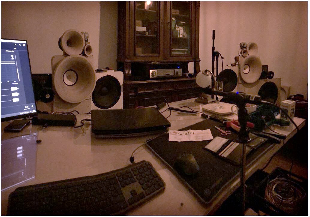

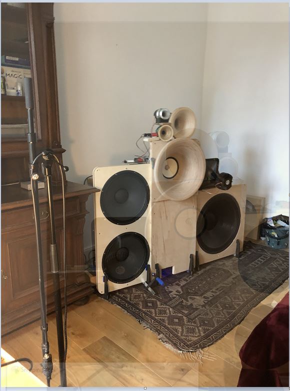

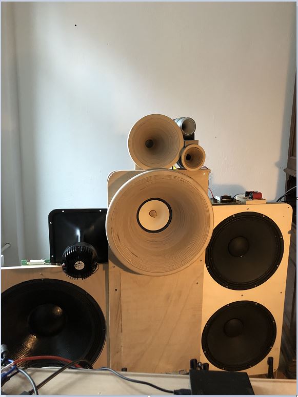

Hi all,
here my last stereo setup in a quite normal room where i work in my home office
inspired of a huge horn setup - the Goto drive units cathedral
i tried to combine in my small room a multi horn setup with an open baffle approach
7 way each side:
subwoofer - lower bass - upper bass - lower midrange horn - upper midrange horn - tweeter horn - back firing horn for dipole effect in the range of the front firing horns
given the fact that the listening distance is quite short i am surprised that it works not too bad
i spent hours and hours in a couple of days in taking measurements again and again (Clio pocket) until all 7 ways fits more or less together

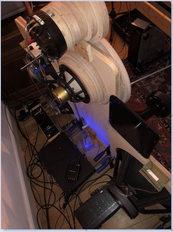

Hi there,
the POC for the Goto horns and drive units cathedral sound disaster remediation has gone to the next level with a super tweeter for frequencies > 9 kHz
i was convinced that this will never work with the 150 cm left speaker 350 cm right speaker asymmetrical listening position at my desk in my quite small home office room
fiddled around a lot with nearfield measurements with CLIO for the drive units as such and the crossover between them, tedious work
thought this will never work
attached my latest purchase miniDSP Flex 8 DL for Dirac room correction and ...
it works far better that expected, Dirac has made my day
So far, so good, Stefano
P.S.: it is 5 way + subs and 1 separate way for the backfiring horn (18sound XR1496 old aluminium version with 18sound NSD1480N compression driver) for the dipole effect
the Visaton TL16H, the 12cm LMH wood horn with the 18sound NSD1095N and the 22cm LMH wood horn with the B&C DCM414-16 are driven with the FA123 plate amp, all other stuff is too noisy for the high efficiency compression drivers
the rest is driven with a miniDSP 2 X4 HD in 1 X 4 layout one for the left and one for the right channel with Crown XLi 800 and Behringer A800 amps for the Sonido SFR200A custom with the 46cm LMH wood horn, the 2 X 15 inch kick bass in series to 16 ohm and the 21 inch woofer sub where Dirac tells me that with the 3.50 meters X 5.50 meters room under 36 Hz there is nothing correctable anymore
the Flex 8 DL is working only for Dirac room correction at time, i think i can swap to the Flex 8 DL 3 of the 4 channels of the miniDSP 2 X 4 HD units, but i need to get rid of all the NF cables that i need to switch for this, not today anymore...

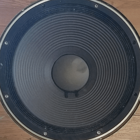

A makeup option: You could try to suck out the dented dustcap with a vacuum cleaner. It may work by carefully (!) applying the cleaner's tube directly over the affected aera of the dustcap, of by fitting a small cup/can to apply the vacuum onto the whole dustcap including a bit of the surrounding speaker's membrane. This technique can work very well, also for dented tweeter/midrange domes.
Caution: You will have to increasingly adjust the vacuum cleaner's rpm for a pleasant result without damaging the driver. It happened to me once that I sucked the whole dustcap away. Therefore my explicit disclaimer: You proceed at your own risk.
If you succeed, this will not change anything about the acoustics behavior of the driver. As mentionned by the word "makeup" above, it's only for aesthetics sake.

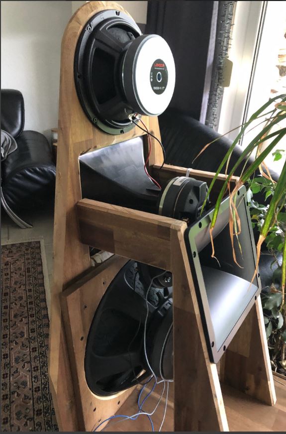

Hi there,
my listening experience has improved a lot with a backfire horn in addition, but you need either an L-Pad for passive or a separate amp for active crossover
here a construction example not mine taken from a german forum
hope it helps, Stefano
