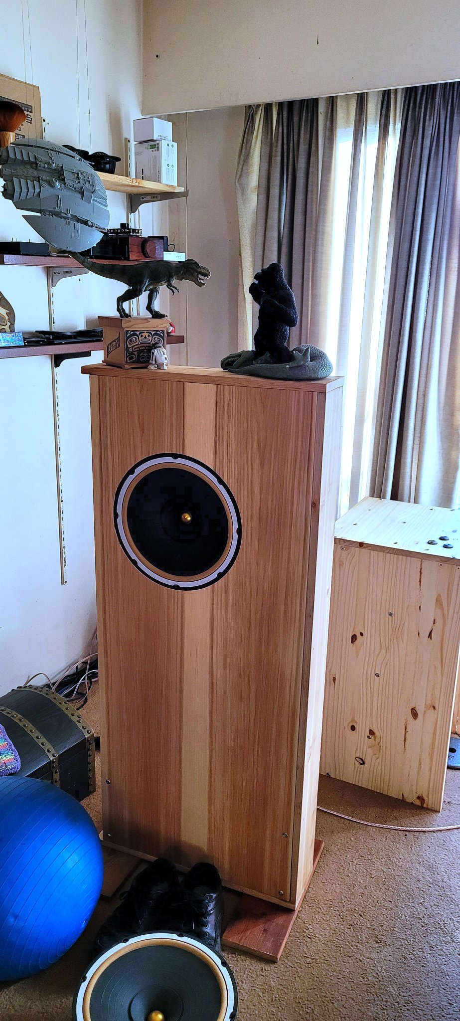

Sized to recall square number ratio 1:4 :9, and my best guess for the dipole peak to hit where the open baffle bass roll off is, to extend a little deeper than a smaller design earlier.
It turned out okay, with JUST enough bass for the musics I listen to.

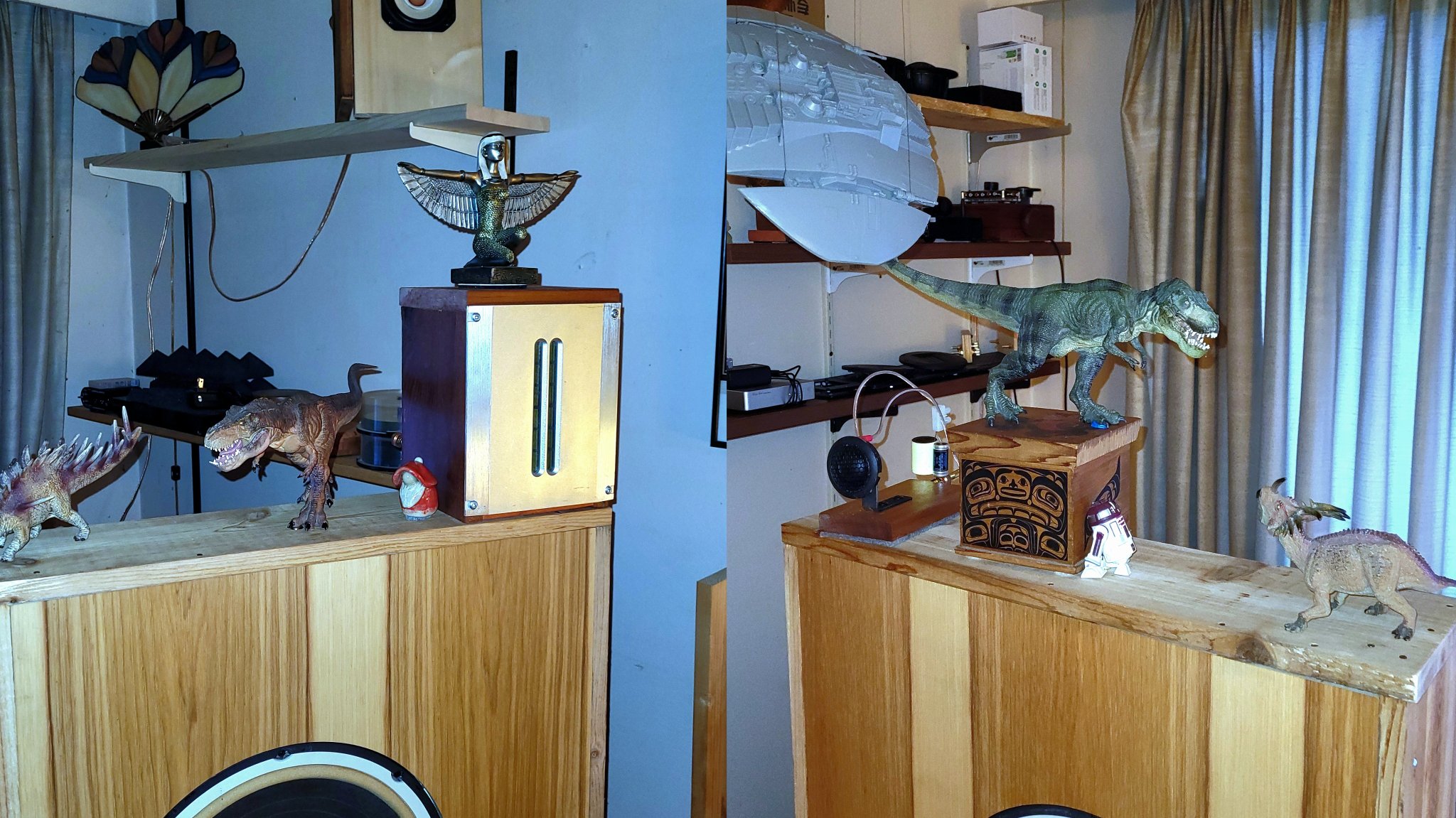

A cylon ship, 2 T-Rex’s, King Kong, and R2D2 - what’s not to like? 😎

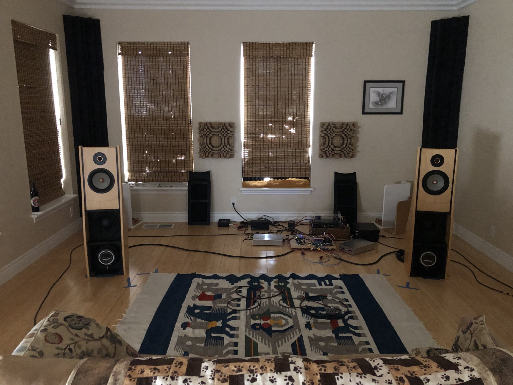

Listen, no analog, just digital from pc through mediocre dac with grey cheapest LAN cable 🙂

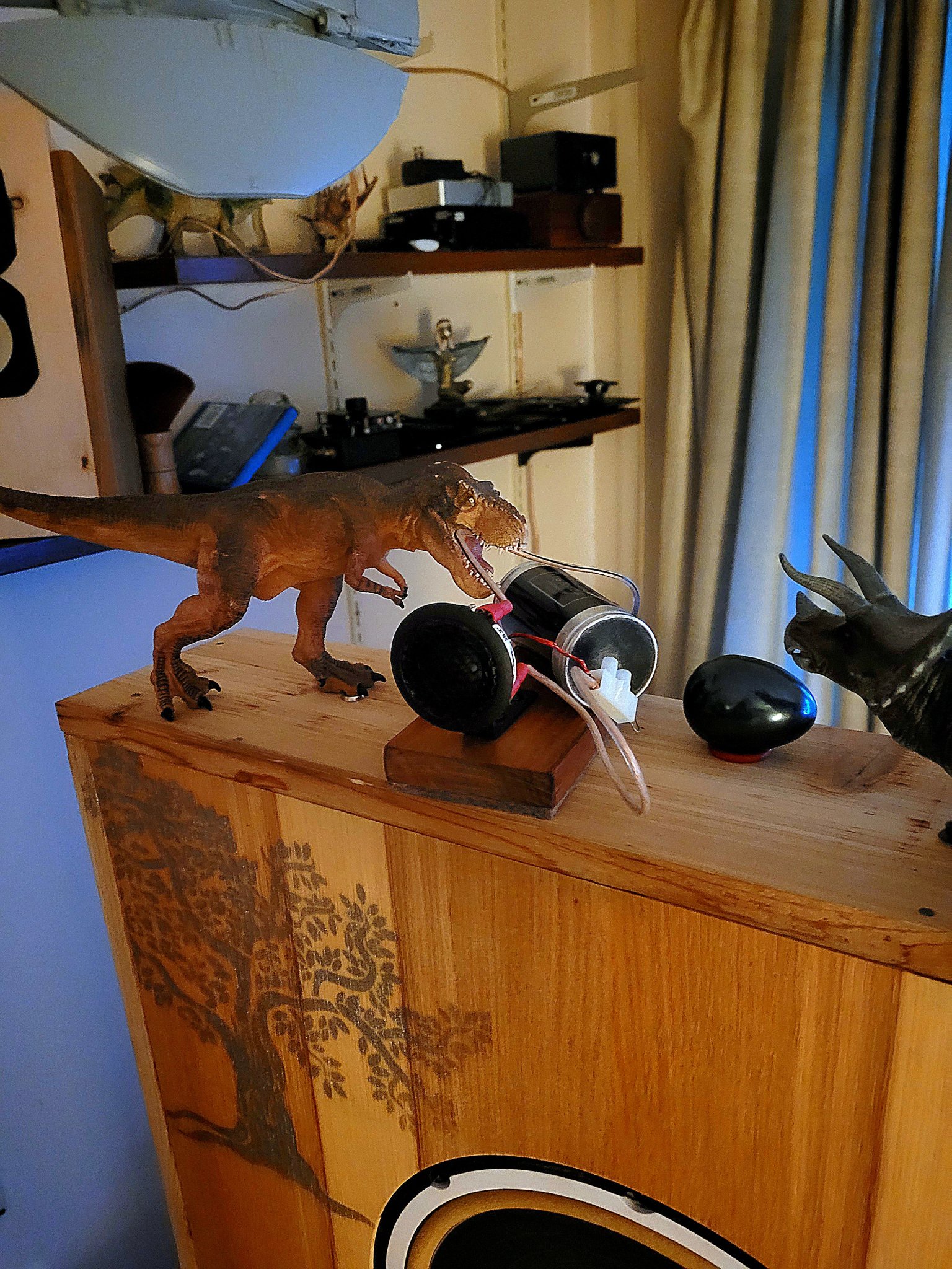

A small change for my speakers. I was trying out some leftover helper planar tweeters, but they were made for some stand mounted speakers, and sit too high for the vertical dispersion I want.
I'm liking these little Seas fabric domes. Wider dispersion and not fixed to the open baffles, they let me angle the main baffles and their reflections away from me.
This drops the pretty directional treble from a lot. The tweeters are highpassed first order for a -3db point of about 15000hz, and are -db at 7500 hz where their diameter stops supporting output.
It's a snap to aim them independently where I listen from.
Having my wide tall baffles with a lot less bad stuff.
My speakers are shared between an AVR and music only DAC and turntable.
With the angling this allows, the phantom centre is actually far superior using my centre speaker, and in stereo last night and this morning, I've double checked a few times to make sure the receiver isn't even on when thinking I heard instruments behind me.

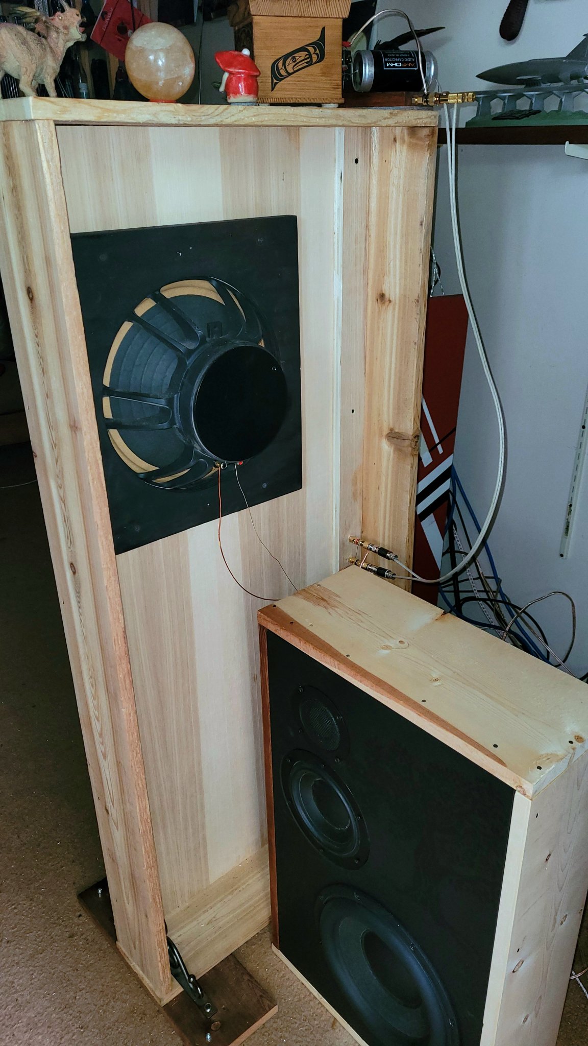

Settled on using the subwoofer drivers in a previous folded open baffle pair for distributed mono bass with the big OB panels.
90° sideways needs just a little more gain than exposed and forward firing, but I much prefer it to either box sub I have, here used for AV.
I got the idea from a Gradient open baffle I read about years ago. From what I recall, success was very much room dependant, and I lucked out.

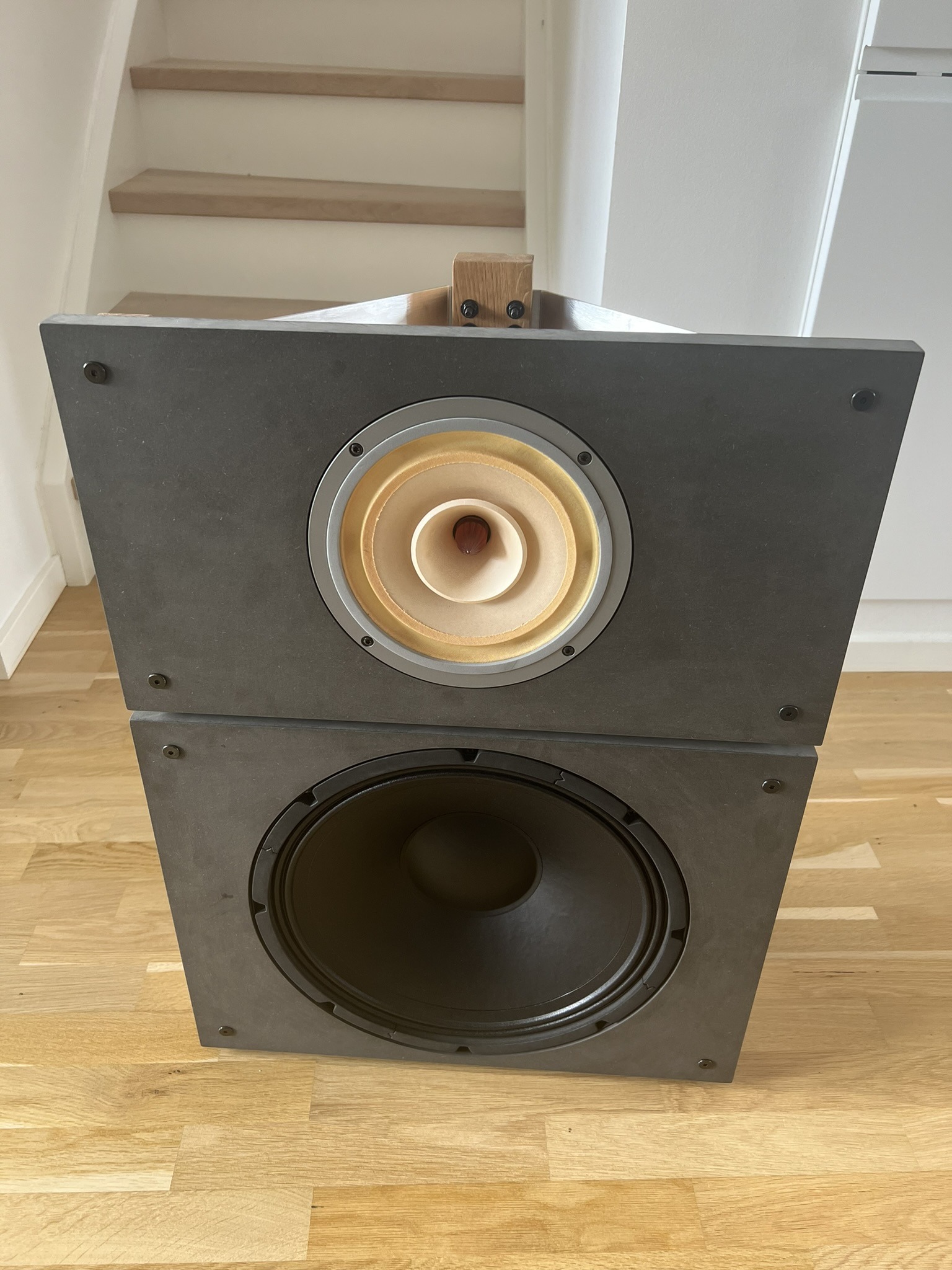

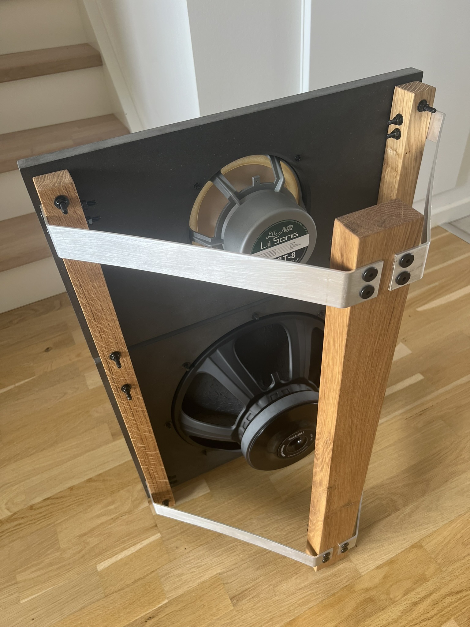

My PAP style OB - Now i just need to decide on the which finish the baffles and bracket should have (and perhaps redo the brackets to get the bend angle perfect 🙂 )
that's beautiful work. Have you considered adding a spar from the rear mast to reinforce the woofer?
Thanks, i haven't thought of it - do you mean to support the weight of the magnet downwards or?
There is a dampener between, where the baffles are mounted on the front masts, to prevent vibrations causing rattling. There is about 5 mm between the front mast and the baffle.
My thoughts were towards bracing the magnet against fore and aft vibrations, sort of a push-pull between the baffle and the driver basket. Just a stick against the magnet, yes.
Thanks, I am using the Biamp6-24 active crossover with an FR EQ from the store, initially, the crossover is 12 dB/Oct and with a -6 dB point at 160-170 Hz.Nice speaker, BrianGasberg!
What crossover point you have between the drivers please?
I just finished them, so I will spend a lot of time the coming months; simulating, tuning, measuring and eksperimenting with, both the EQ and the crossover.
The drivers are a Lii Fast-8 and an 15OB350 bass.
When the Tangband W8-1808 come back in stock at soundimports I might change the Fast-8 to this one.
