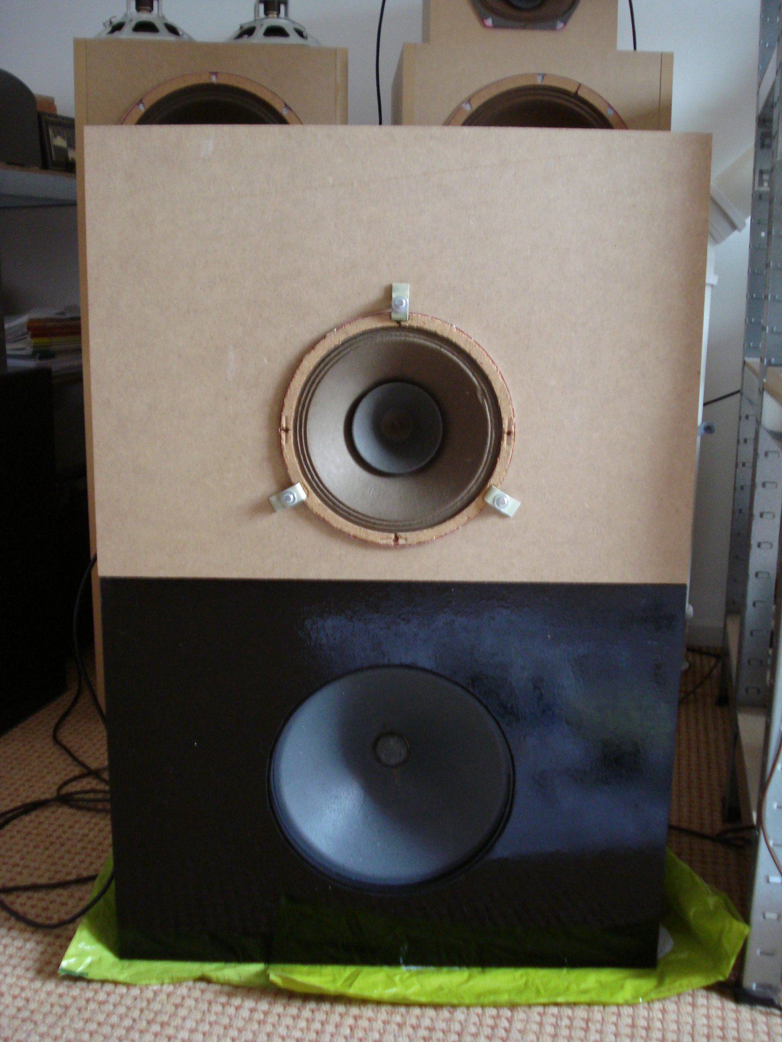

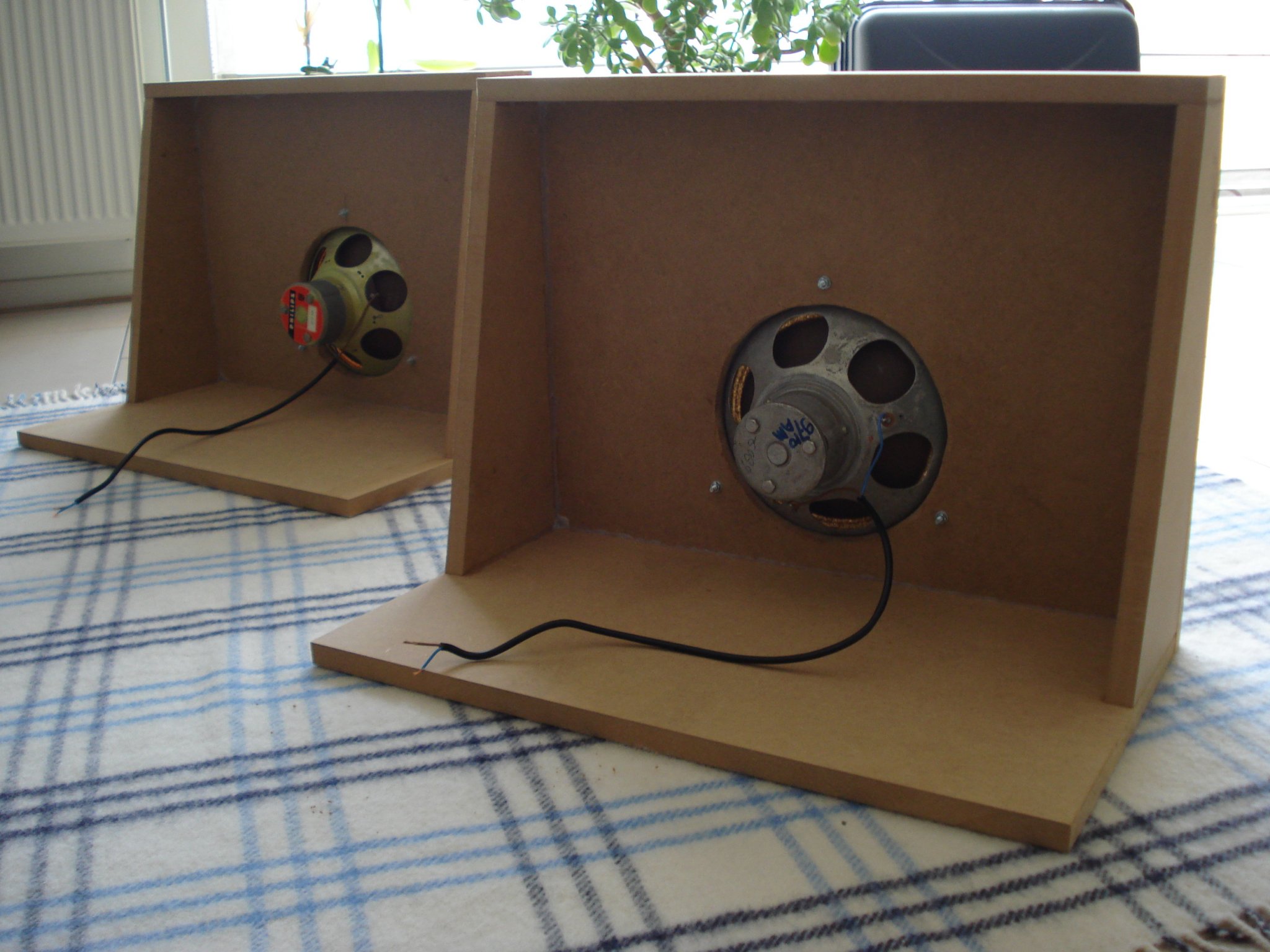

My take at open baffles with the Philips 9710AM/01 (the Philips AD5201A "Bombardon" woofer sits in a sealed enclosure). In practice I stuff a pillow at the back of the open baffle.
The loudspeakers have 800 Ohm impedance, so are meant for OTL tube amplifiers. I use them with bi-amping and an active tube crossover (400 Hz/18 dB per octave).

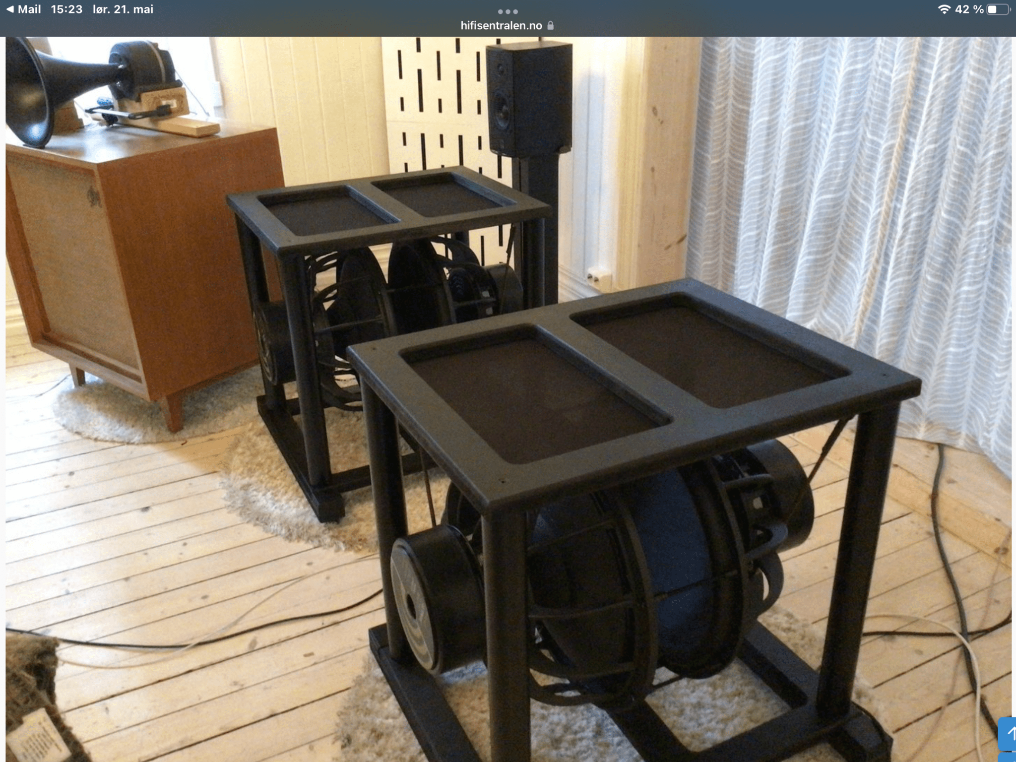

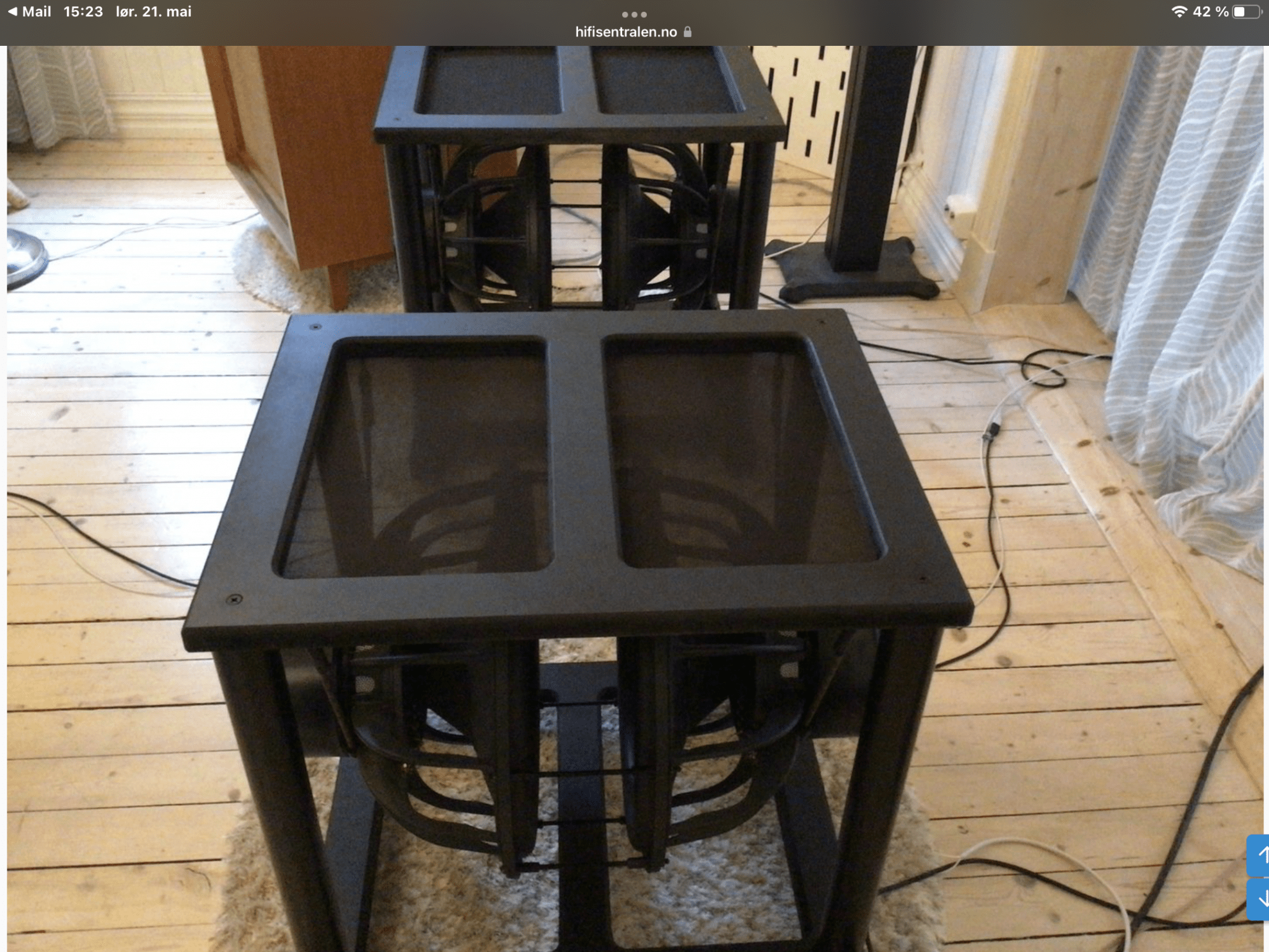

I tried 4 pcs 18 dayton umax without baffle sub, measuredly it is a killer and it plays loud, but it is not the dipole sound I like, not the weightless quick sound
have tried 3-4 solutions with 18 inches, always fall back to 15´ as the best choice for dipole bass

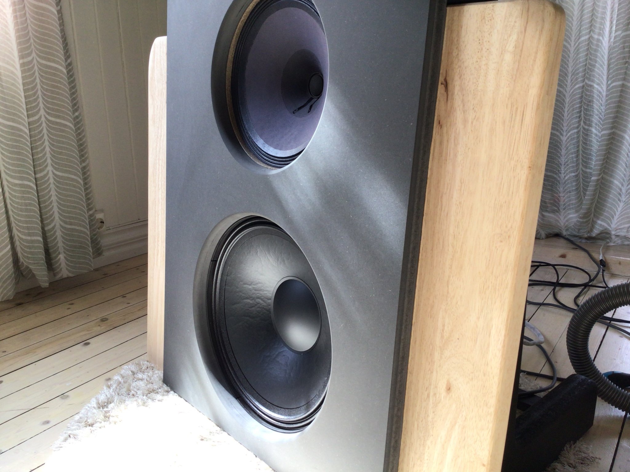

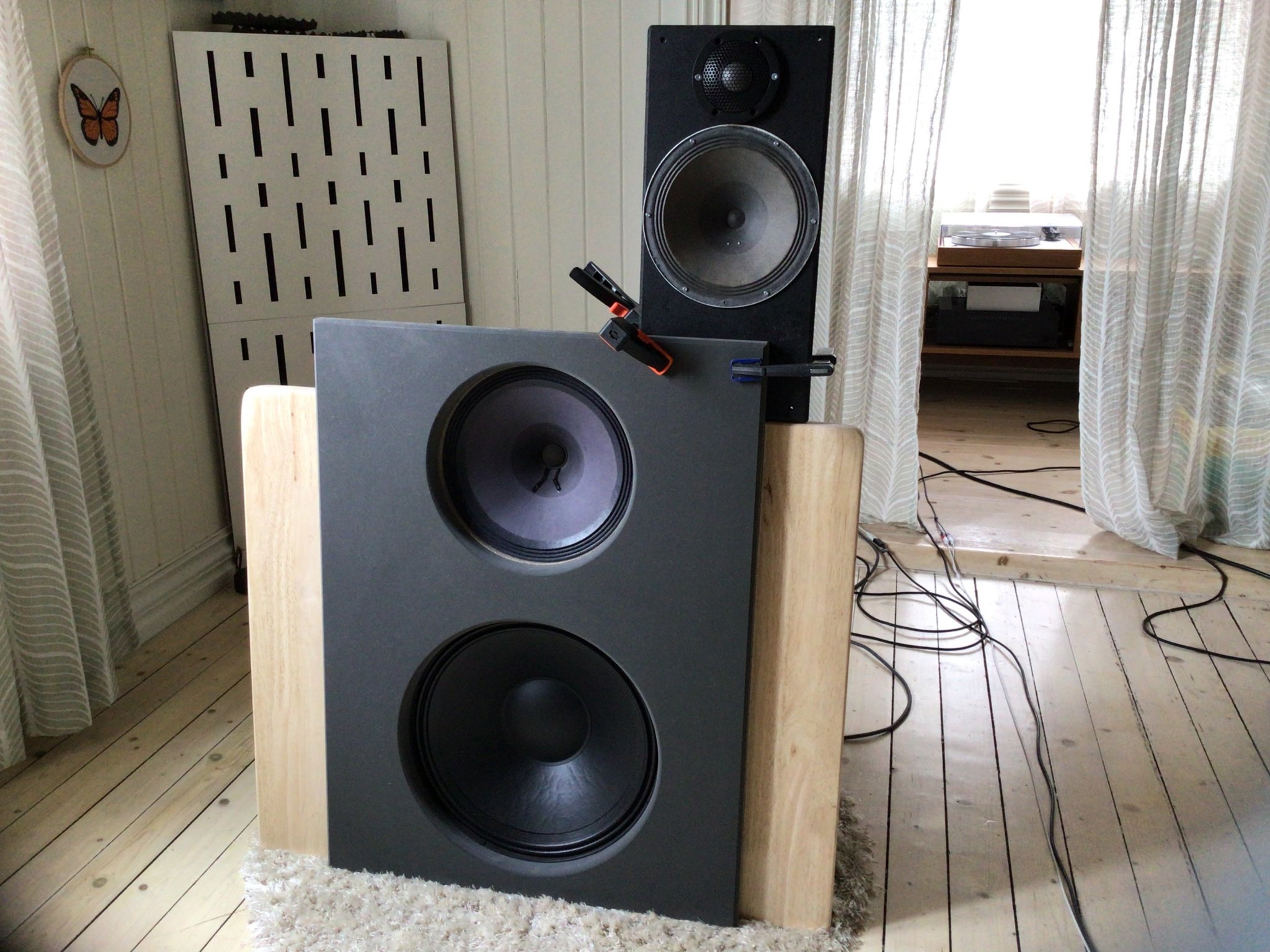

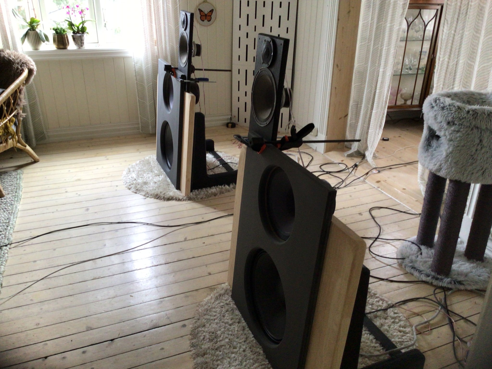

With all your experience with dipole bass, which driver and in what configuration have you enjoyed bass the most?

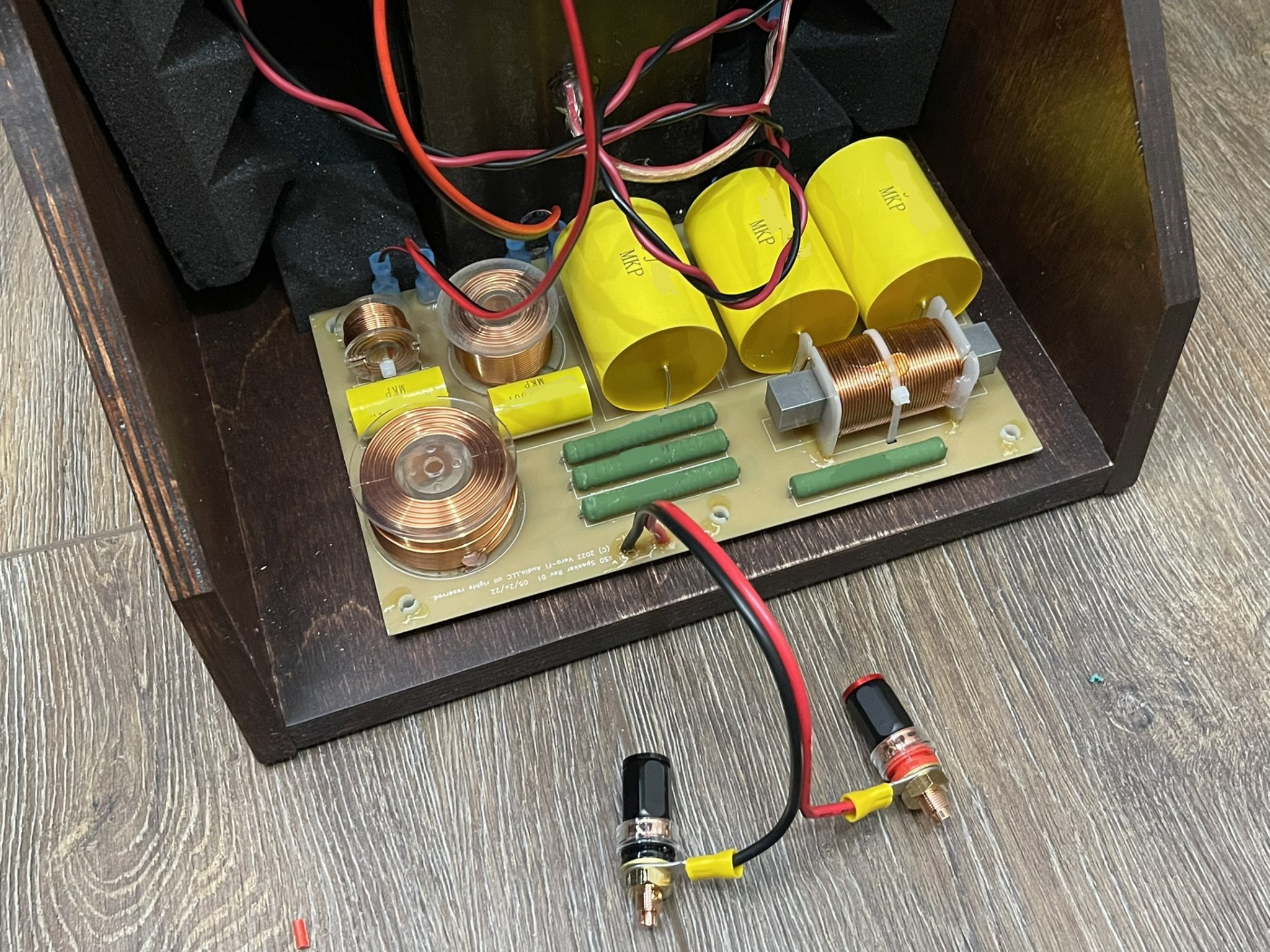

The SLOB dipoles (XSDs) just got some real crossovers on PCBs. They sound fantastic. All film MKP caps. Probably imagining things but it seems the PCB mounted crossovers sound better than the P2P wired ones?

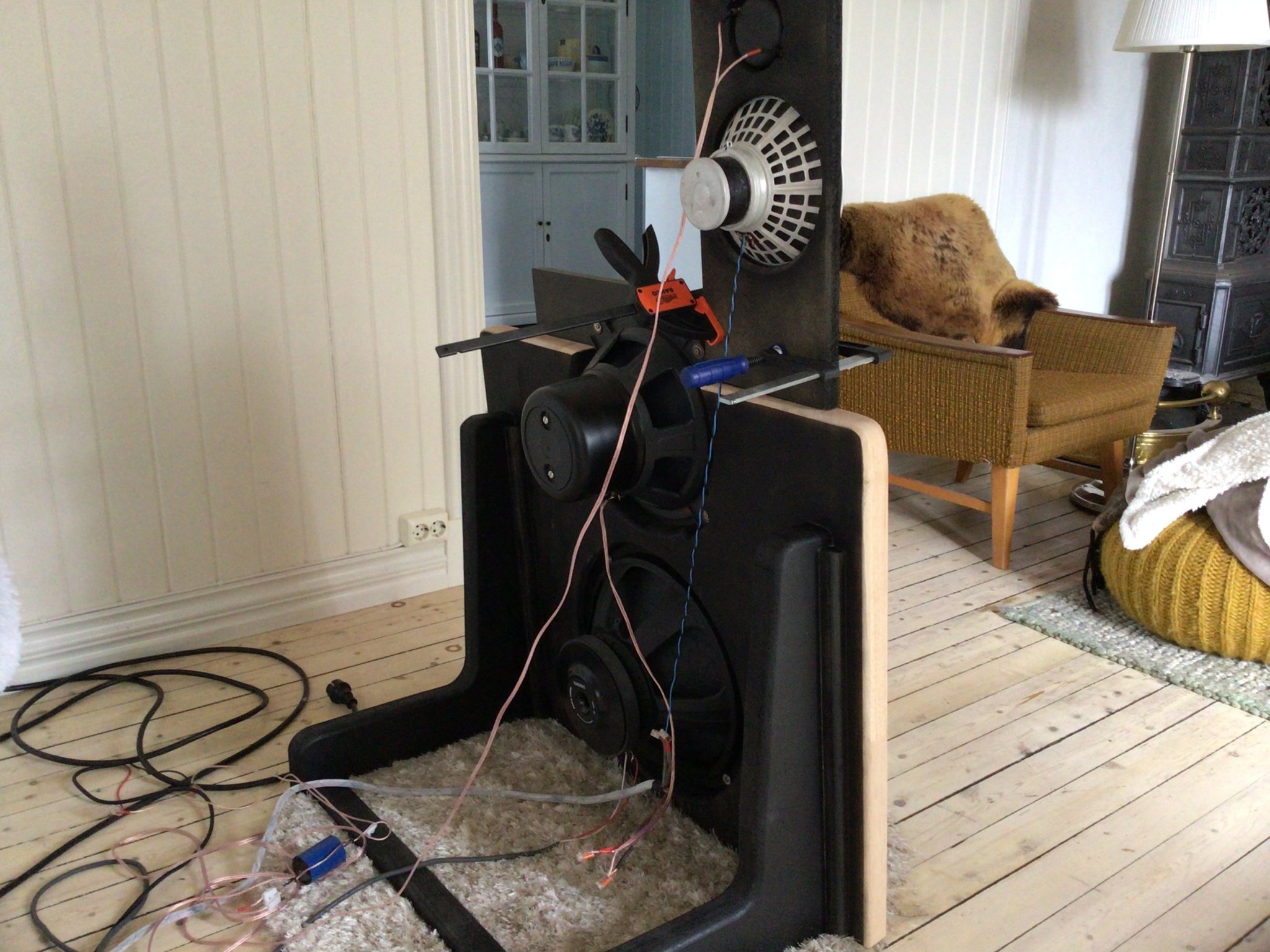

I use something similar, but woofers facing out with magnets inside. I put cover over sides and top. Kind of like SL did with his H shaped baffles. It is still dipole but limits cancellation to some digree, and definitely helps. Bass exactly i want. So i would not give up on those, perhaps experiment with modifications.I tried 4 pcs 18 dayton umax without baffle sub, measuredly it is a killer and it plays loud, but it is not the dipole sound I like, not the weightless quick sound
what do we really want with an´open baffle´ bass?I use something similar, but woofers facing out with magnets inside. I put cover over sides and top. Kind of like SL did with his H shaped baffles. It is still dipole but limits cancellation to some digree, and definitely helps. Bass exactly i want. So i would not give up on those, perhaps experiment with modifications.
we cil free ourselves from box resonances, and the delays it gives in the rhyme,
we have to choose elements, easily driven, they are fast, if you can not do with 1 or 2 then you have to buy 4 pieces, it will sound much faster, better and more punchy than 4 pcs heavy freckle 18 incheswhat do we really want with an´open baffle´ bass?
