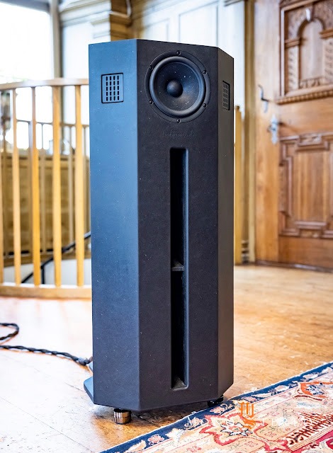

I assume the sloat is to produce a compression and focus the bass flow by a narrow open chamber in front of the listener... Make me think a lot of the aperiodic bass cabinet while not working the same.
I don’t think the W has much cone loading or front jet acceleration to give directional gain like a SLOB. I did not try without side walls yet but know from physics that the bass would be much higher cutoff. Nelson Pass’ SLOB had no side walls but a much wider baffle so same effect I think.
Speaking of Z frame dipole, I made the KaZBa design and CLS had a beautiful implementation with dual 18in woofers.

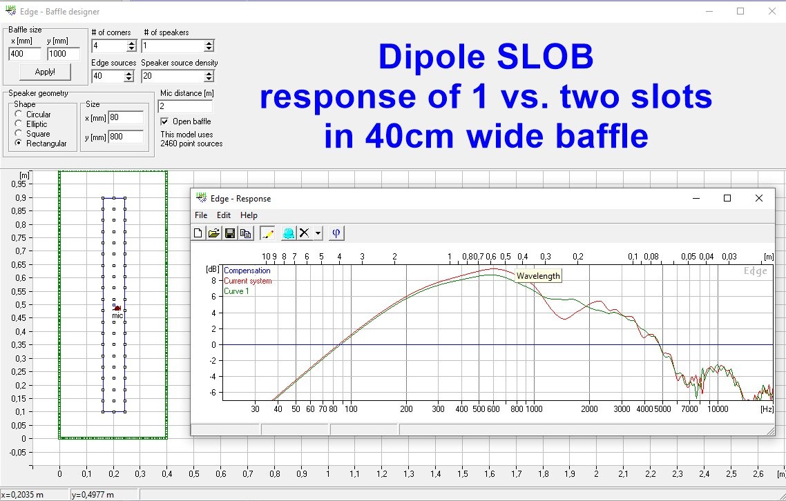

Actually a slot "loads" only in extreme nearfield. At practical listening distance and regarding dipole pattern formation, it is irrelevant, and easily has nasty cavity- and mechanical resonances in upper register. And I have never seen 180deg polars of eg. Nelson Pass SLOB woofer... my impression is that they gave no thinking at all to dipole pattern and just made it as a funny excercise. I fail to see any benefits in it.
The slot itself does nothing to directivity in bass frequencies. Please consider wavelengths!

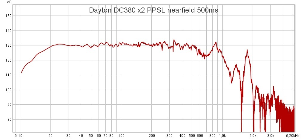

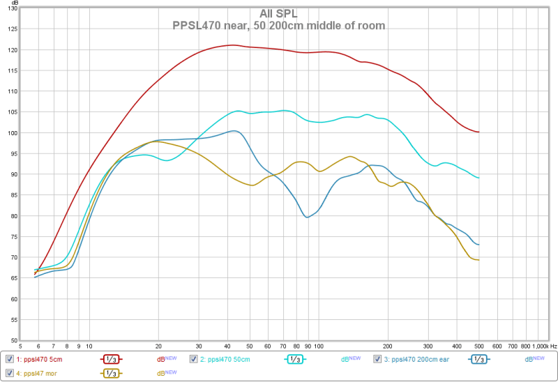

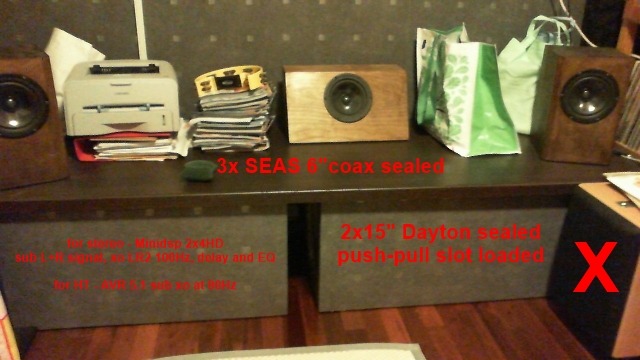

I have also made a 2x15" closed box slot loaded push-pull subwoofer, and measured it in 2013, for my HT room. The closed end of the slot is stuffed with a pillow

I do notice that the SLOB has much more uniform bass in the room vs traditional monopole speakers. Much less distinctive peaks and nulls in sub 100Hz bass when walking around. The slot actually filters out some of the woofer’s own natural high frequency breakup and if the electrical low pass is made to coincide with the acoustic low pass, we get a steep higher order filter for the price of a lower order electrical. This is predominantly determined by the slot depth.^ Yes quite many "if"s... And a room has it's Schröder Fs, below which we humans will hear only the room response (regarding spl).

? I have never made even a proto of SLOB. I made a PPSL subwoofer, where each driver has huge closed box

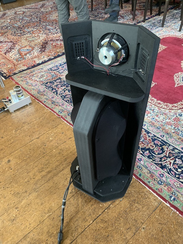

New paint job on the baffle and a new name as “SLOB” wasn’t so sexy. The XSD speaker now has its own dedicated thread here.

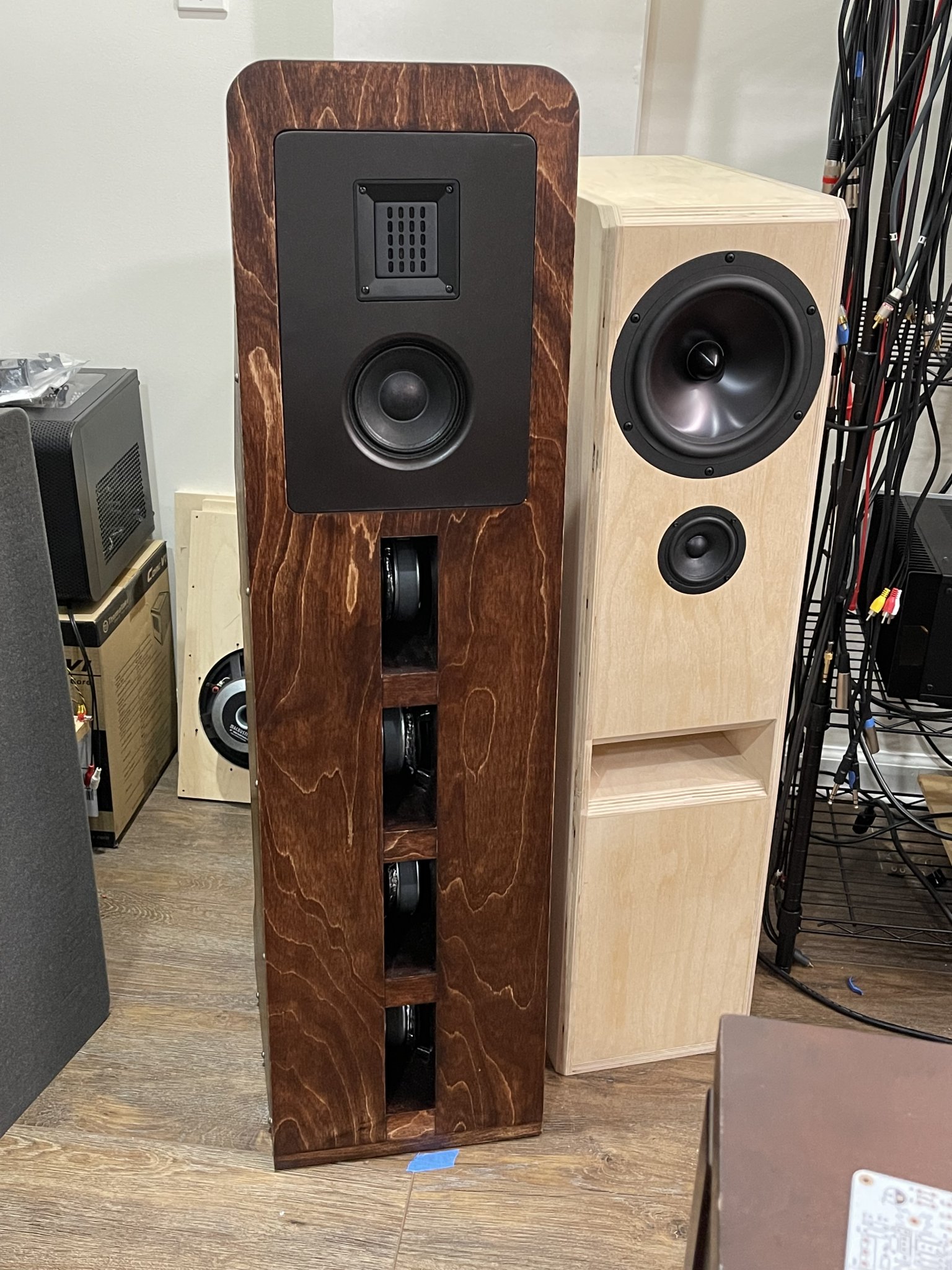

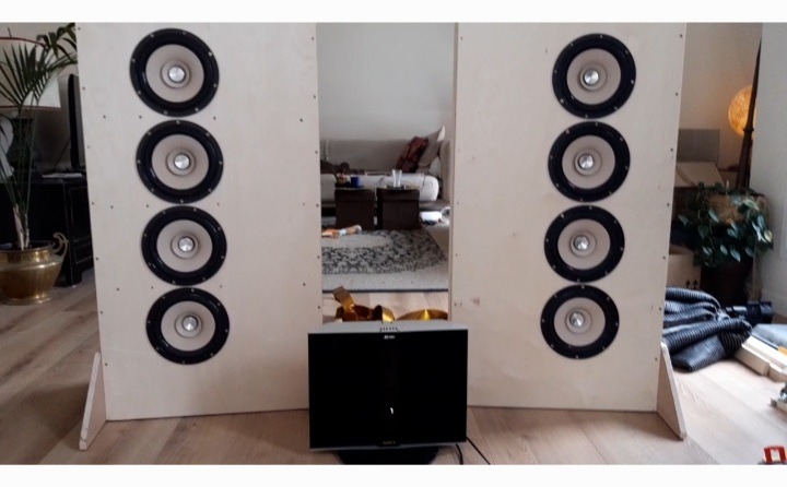

Open baffle consisting of 4 TangBand w8-2145 in parallel. Build based on ECdesigns' specifications.
Sound is very natural, high resolution. Bass is solid.
