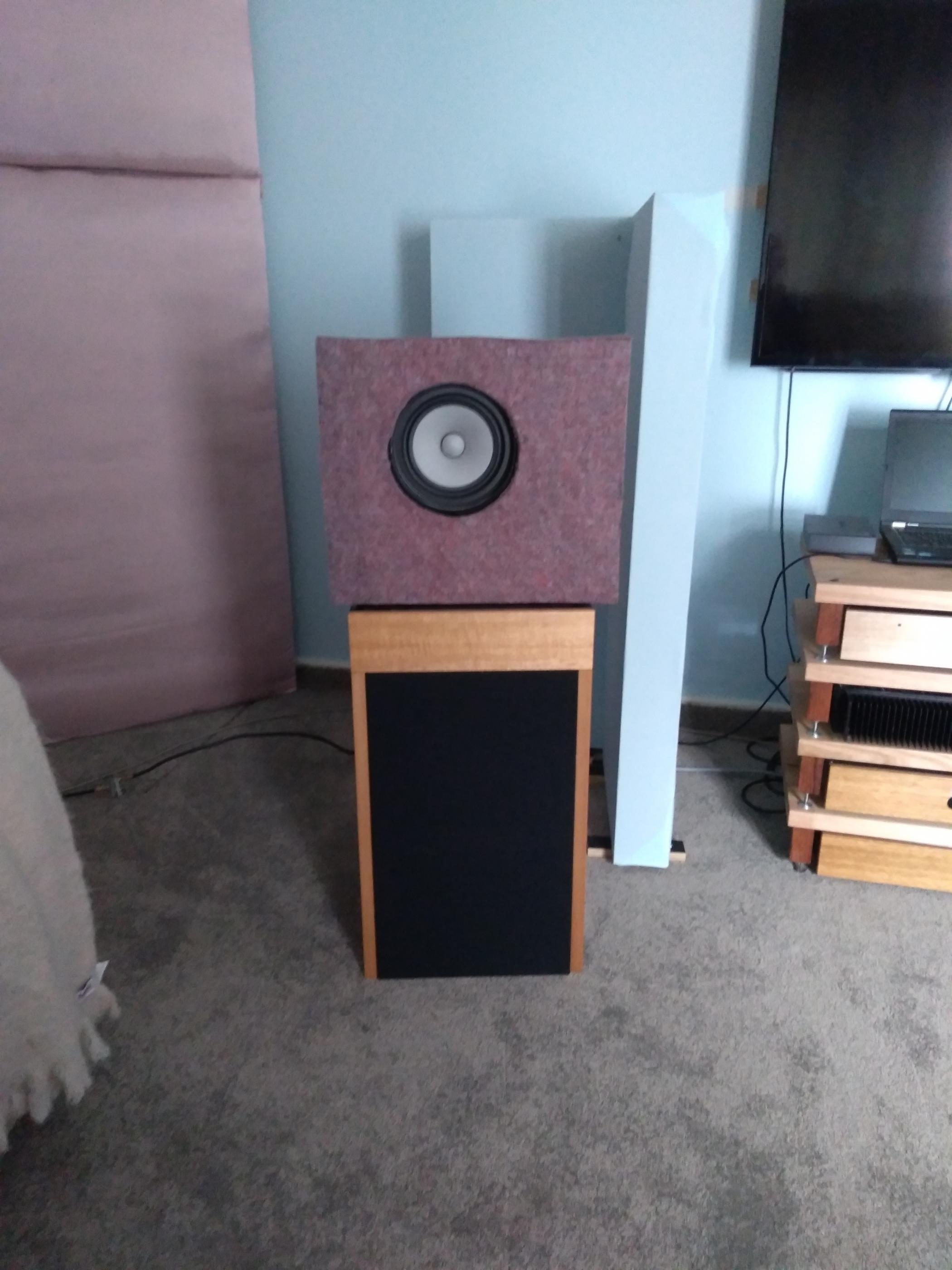

MarkAudio U Frame

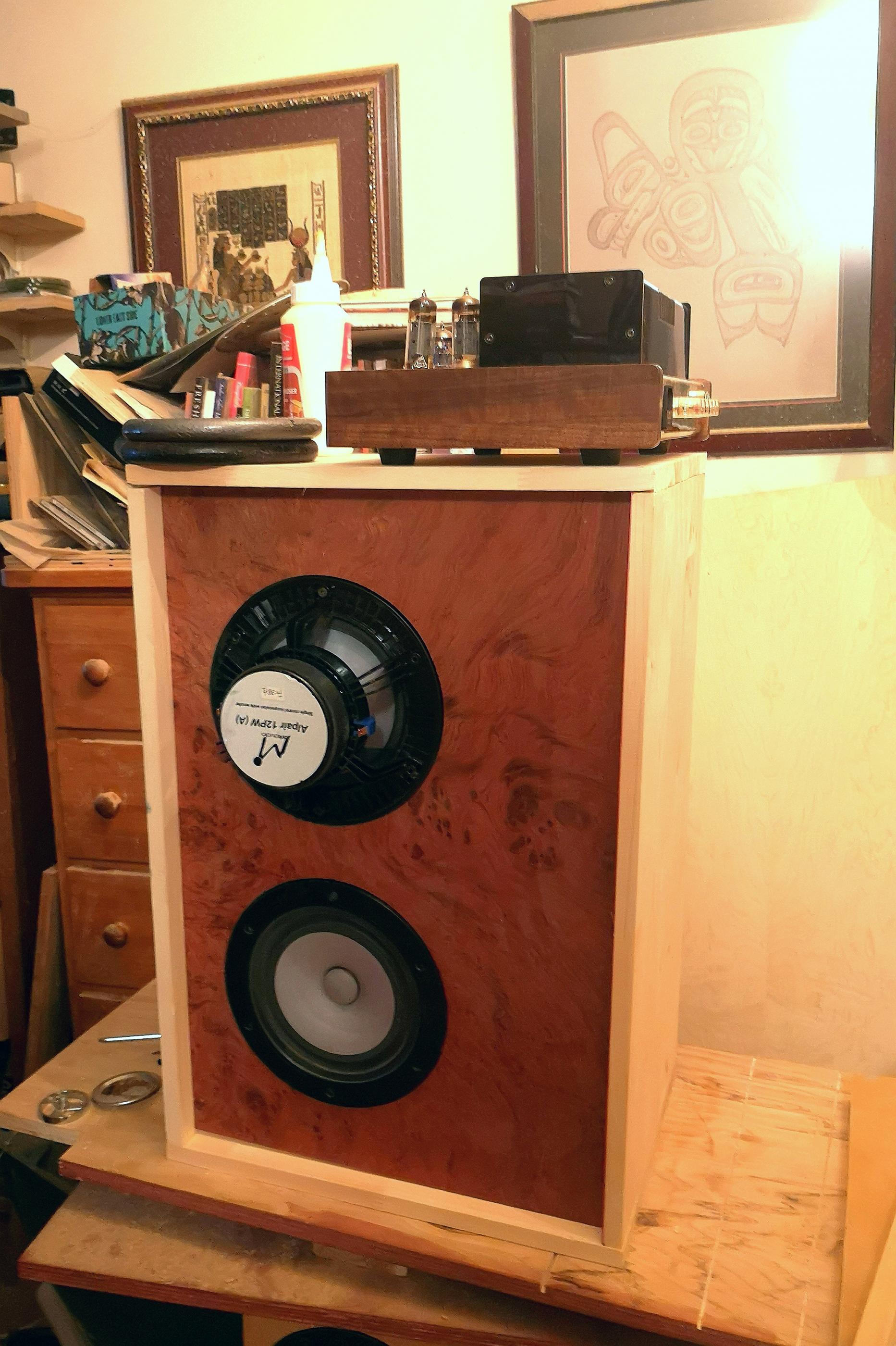

Starting a build similar in principle to the LX521 .
Mine are intended as satellites with a slot loaded open baffle sub I already have.
I want plenty of power response from 120 to 1000 hertz or so, and I figure this will do that, as well as cleaning up already good bass, up to 300 hertz or so.
On top , I'll use a tilted towards ceiling 12P, relying on beaming to filter the highs.
I've done this before, with some nice but fragile Seas Alnico 21TV drivers.
It eliminates a lot of back wall reflection issues.
Since I don't mind the focus a little beaming brings, I'll be using a 7P for treble, pointing straight ahead, at least to start with.
The 12P and 7P will share a head unit, which can pivot independent of the lower U Frame.
Hoping to get most of one channel going tonight. I guess ideally, these drivers will already be good enough on midbass to make push pull moot.
I do like the utilitarian look of it, though.

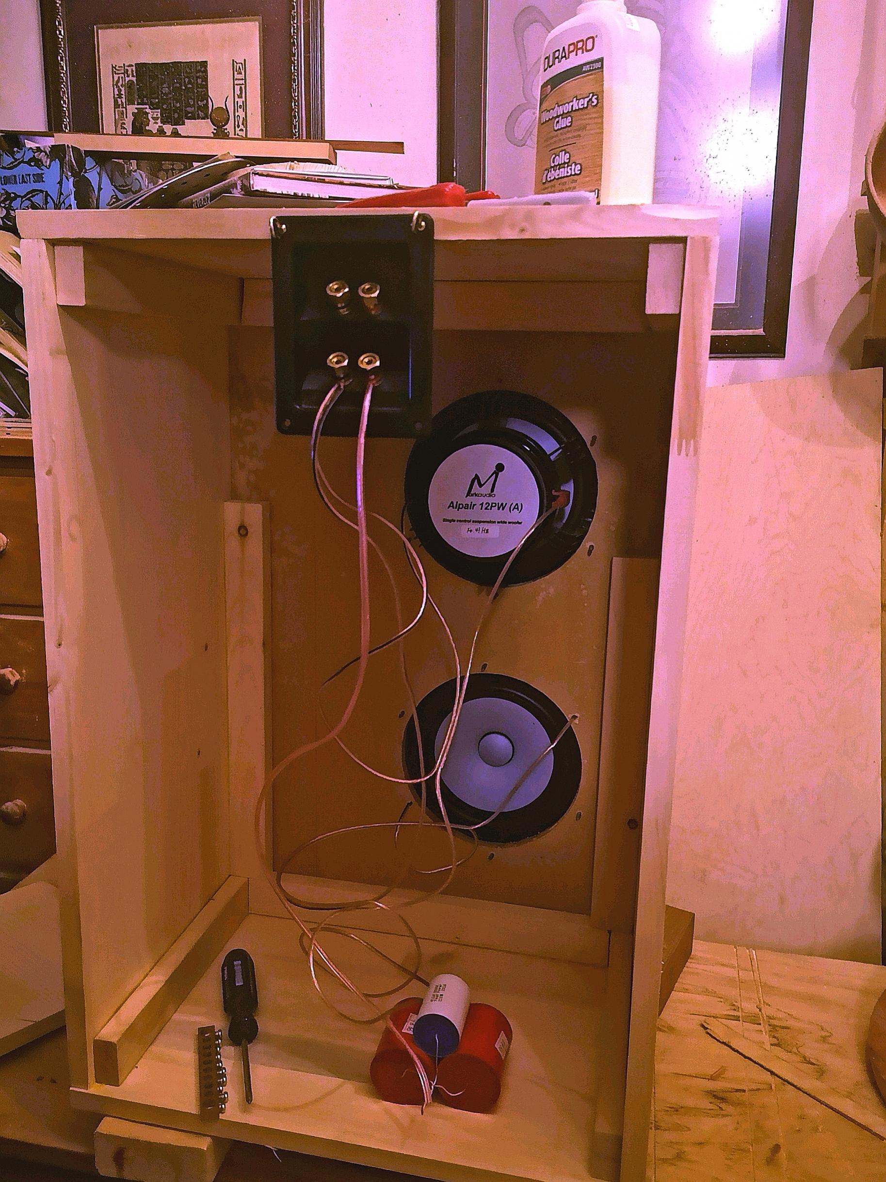

Less and more?
As hoped, the relative to driver width deeper than normal U-Frame has some audible resonances in male vocals.
A 1 slope filter at 110 hertz or so eliminates this, in addition to the already present 4 Slope digital filter from my preamp, set for 120 hertz.
Got my new cheap wire in today, so rewired things more neatly. ( The previous was mix and mismatched scraps).
I noticed right away, the 16 gauge Amazon Basics isn't. At least on both sides: after stripping the insulation, the black insulated wire twists up much thicker pre crimping the connectors on, than the clear insulated side.
I'm not sure if they are following the Eichmann Ratio thing, but thought it may be of interest to any cable disciples looking for a good deal.
Got a fifty foot roll for $11 Canadian funds with free delivery, it being part of a larger order.
Easy to use, and seems annealed.

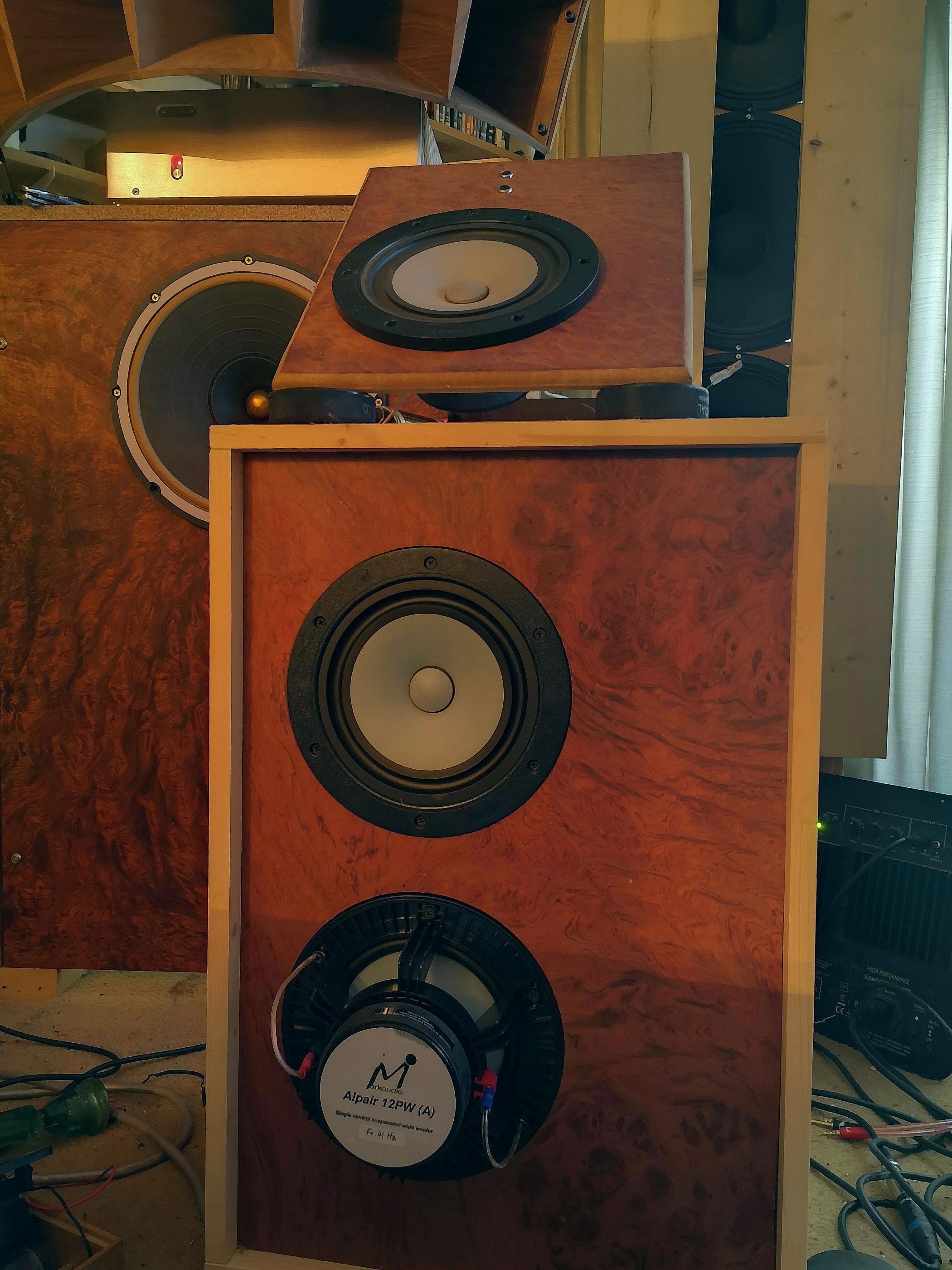

Different but done
No need for the planned Alpair 7P to be included. Plenty of extended sound from the angled open baffle 12P. Without the tilt, this driver seemed slightly harsh to me in open baffle.
I guess off axis reduced the harshness as planned, but I'm surprised there's enough presence and treble like this. The 7P will await another project.
The 12P sports just a 2.2uF Ampohm papering wax tinfoil cap.
No more active crossovers here, it sounds more pleasant just passively filtered.

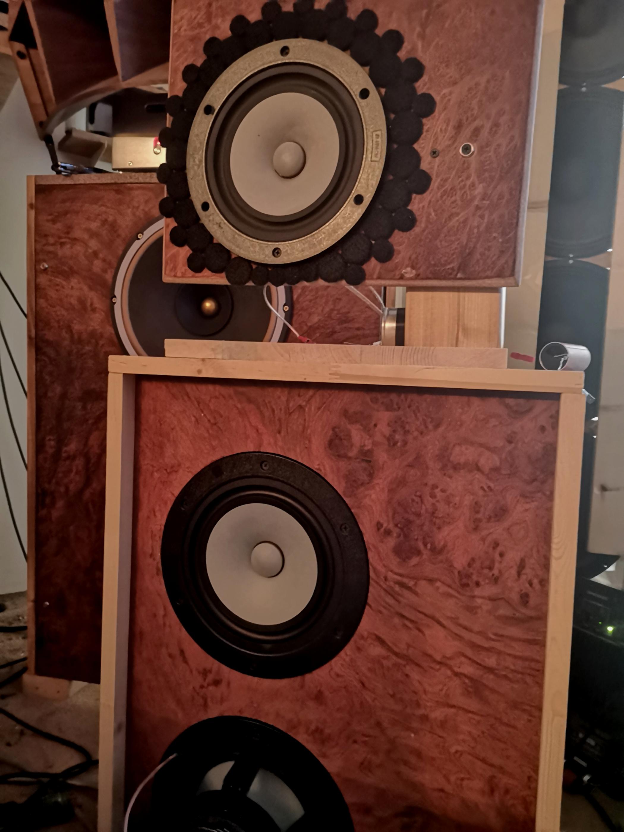

Baffle Treatment
I reorientated the top baffle vertically, to hear if the 12P sounds better in a conventional mounting.
It may, with a LPad, but I don't want one in circuit.
I also tried a quick experiment to hear if a patterned non reflective felt treatment around the driver, matching its non flush mounted rise would help things out, and it does, but not enough for me.
Back to the tilt.

For me the felt covered baffle provided a huge improvement in detail with the 12P's, I have the felt cover the whole baffle to attenuate reflections from the edge. I covered them in speaker fabric so you can't see the felt now. I would like to have the baffle the same width as the woofer but they sound so good I'm hesitant to make any changes.
I tried this after seeing you had done it...same thing, a big detail improvement with the tangband w8-1808.
I understand the discussion is about open baffle and not necessarily dipoles exactly, but I'm wondering if using felt effects the radiation reaching the baffle edge such that the cancellation is compromised?
Yeah, I don’t know precisely why it makes such a difference in my case, but it does.
I think about a pressure wave attempting to propagate to baffle edge...weakened as it travels (but not the back wave). By baffle edge, the effect is much reduced.
3” of rock wool insulation is effective down to 200 hz. So Ikm imagining a curved fullrange baffle that looks from the front to be flat because the void is filled with rockwool. A perfectly dead, non resonant baffle.
Gotta try that. Soon.
