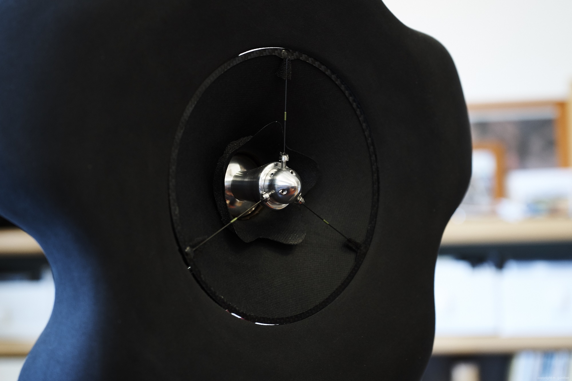

Fertin 38EX FC 15" - various Fostex 8" wide band versions - RAAL Lazy.
Hi Pengesluk,
sorry, just noticed your post right now.
If you intend to use a Fertin38ex and a Raal, I can´t help but imaging that a Fertin or EMS fullrange for the mids would be a better match. Compared several 8 inch drivers on my journey and have finally chosen the Fertin 21M8EX as main driver.
A modular approach is a good idea to try several drivers, but of course each driver will need its own alignments.
All the best
Mattes

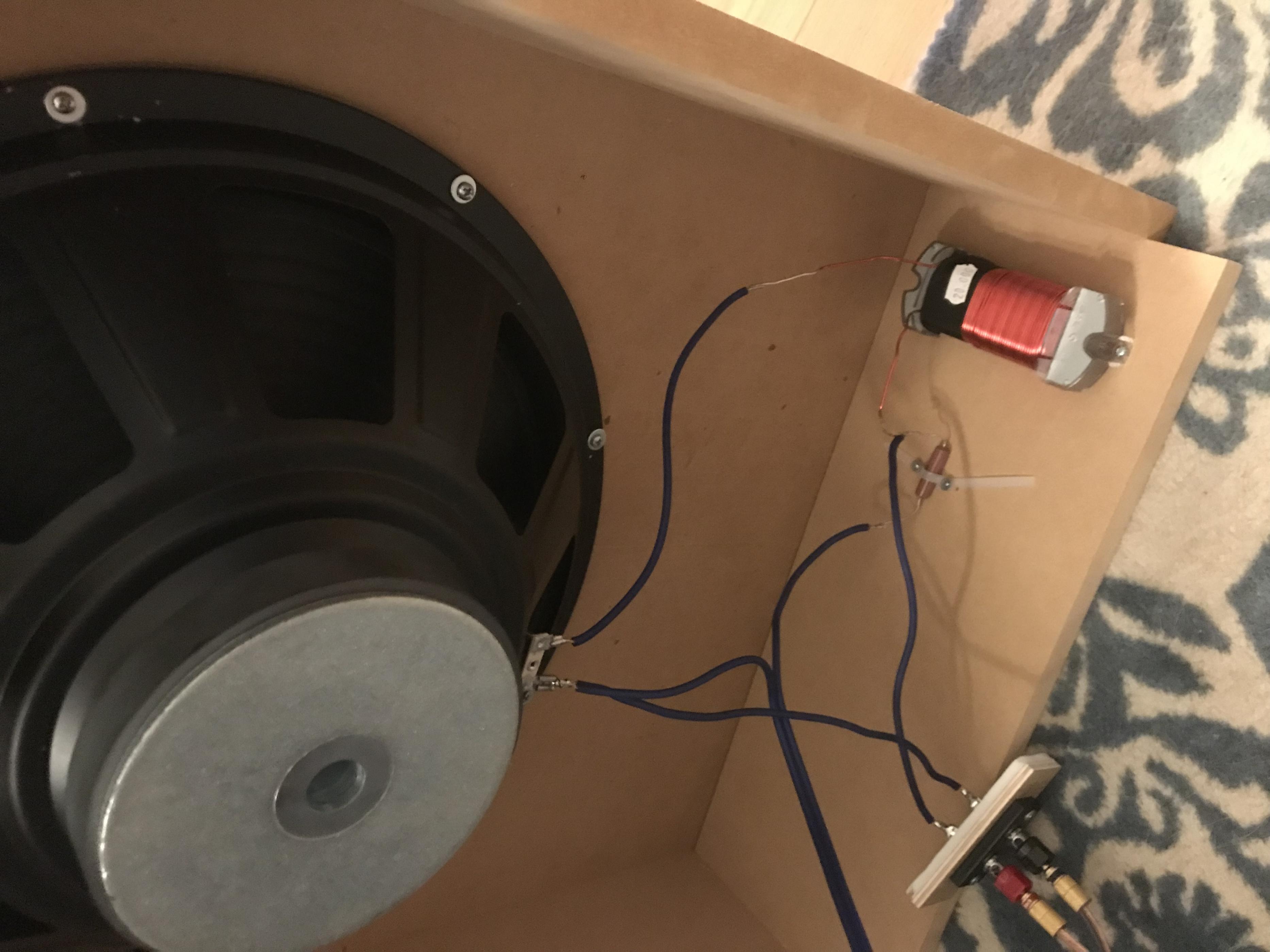

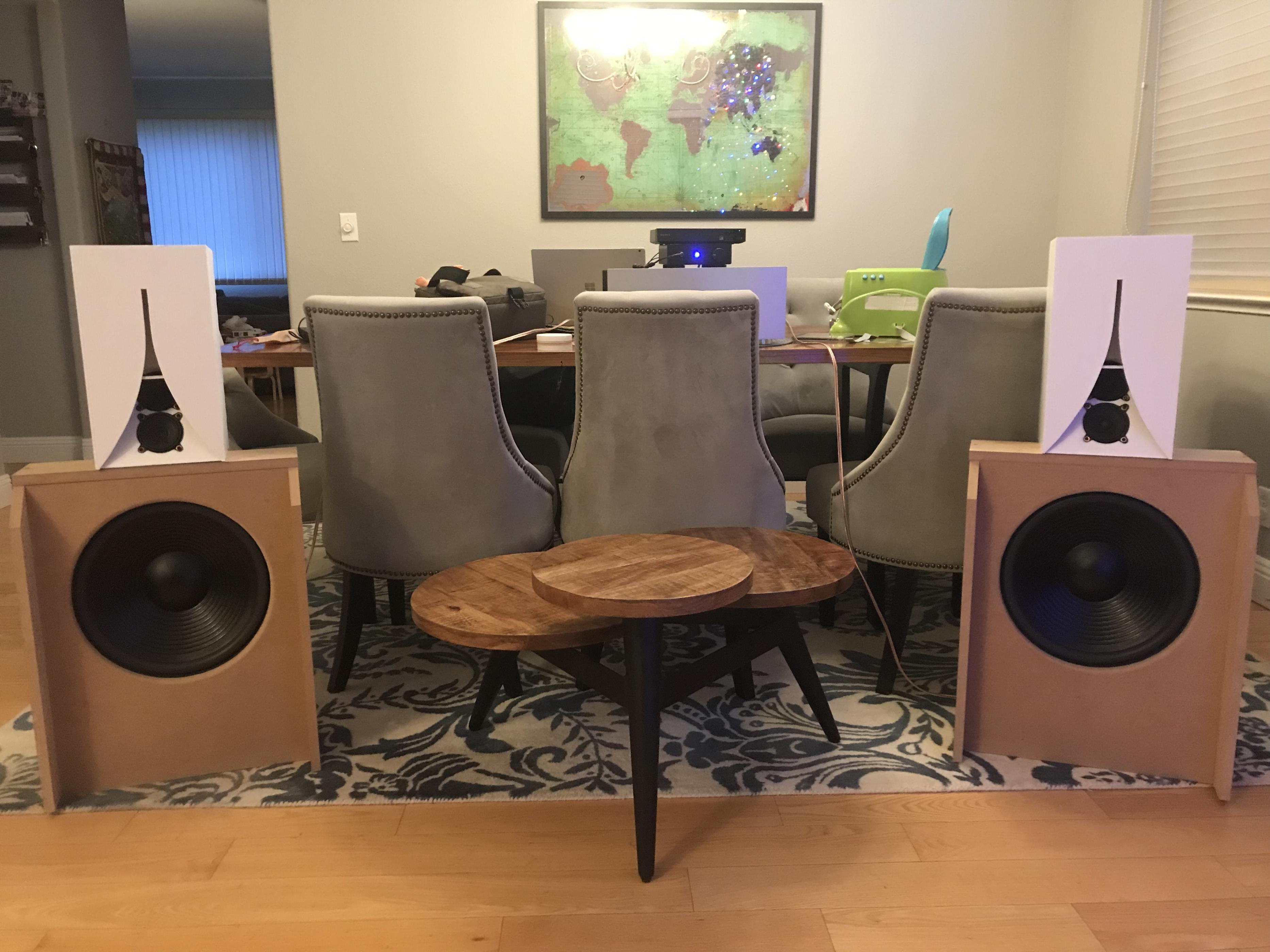

I built some open baffles to experiment with adding more low end to my system this weekend. They’re roughly based on John Busch’s Manzanitas in terms of the GRS15 woofers, baffle size and wings and the 20mH inductor on the XO. I have an 8 Ohm mills resistor in series with the 0.53x Mini-k with dual 3fe25’s. I like what I’m hearing so far. They blend pretty well and give the low end I was missing along with some good punch on percussion. I think the woofers still need some break-in time to loosen up the surrounds and things will get even better. Maybe some more XO experimentation later this week too.

Faital Pro mid tweeters?
Those are good drivers.

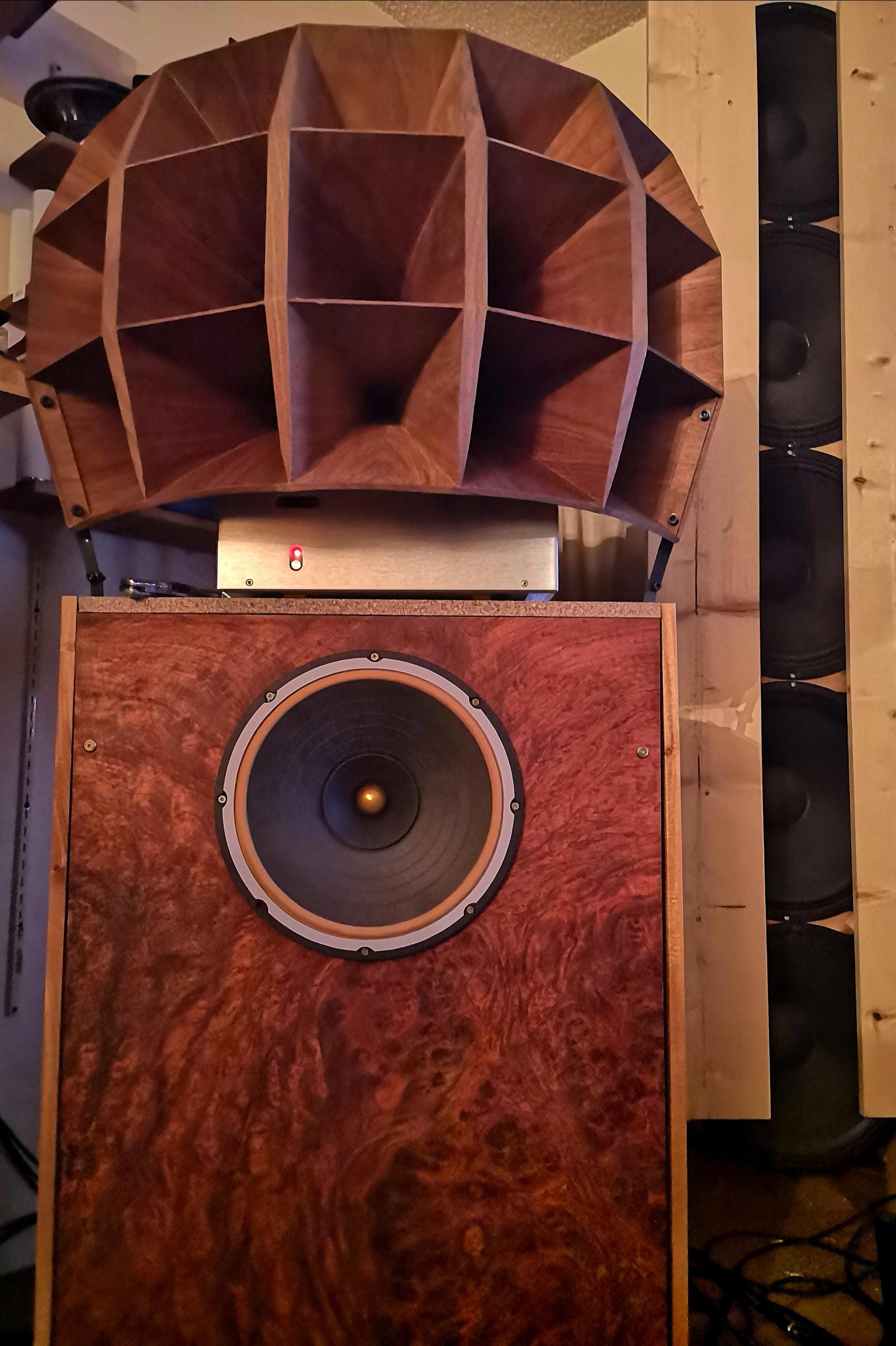

I use 5 fifteen Inch woofers for 30 to 130 hertz, open baffle. Posted a photo as a response to a query on a Facebook site.
Some trolls went nuts, saying the 90" tall stack isn't a line array, and that at the frequencies I use it at, it is in fact a point source, and does not launch a cylindrical wave, nor does it boost efficiency by having the drivers in such close proximity.
OTH, I've heard a stack of woofers, and it does play loud and clean, with minimal excursion, lol.
IMO, the concept will also work fine in a box.

1/4 wavelength at 130 hz is about 2 feet, so it should have a bit of line source behaviour at its upper range, but 100 hz or below it becomes closer to a “point” source that’s feet wide?

The guy was getting ridiculously abusive, so I blocked him. He made little sense to me.
I'd already stated this was made from spare parts at hand, from possible replacements for projects I'd sold years ago, in case a customer blew drivers, or if one happened to fail.
He was telling me I should have bought new drivers for this, with higher Qts than the 0.50 ones I already had.
I understand some people like the 1.0qts sound in free air, but I'd rather use a drier sounding woofer, and eq it a little.
Next he goes off, pretending my old plate amp is a class D amp. It's not.
Then he complains that a thousand watt amp into a 4 ohm load is too much power. It's 500 watts into this 8 ohm load, besides the fact that it too, is a spare from a previous sold project, again, in case the sold amp fails on the customer.
Then he attacks using 1*8"*90" timber at hand, to slot load the front output to a 6" *90" opening on the woofer stack, adding resistance and bass depth. I did it to avoid more hole cutting( it's messy) and to decouple the woofers from a frame, rather than using a resonance generating regular style baffle.
I looked over the troll's other postings, and decided not to engage with a know it all know nothing,and blocked him before he explained a 90 inch, 130 hertz point source.
