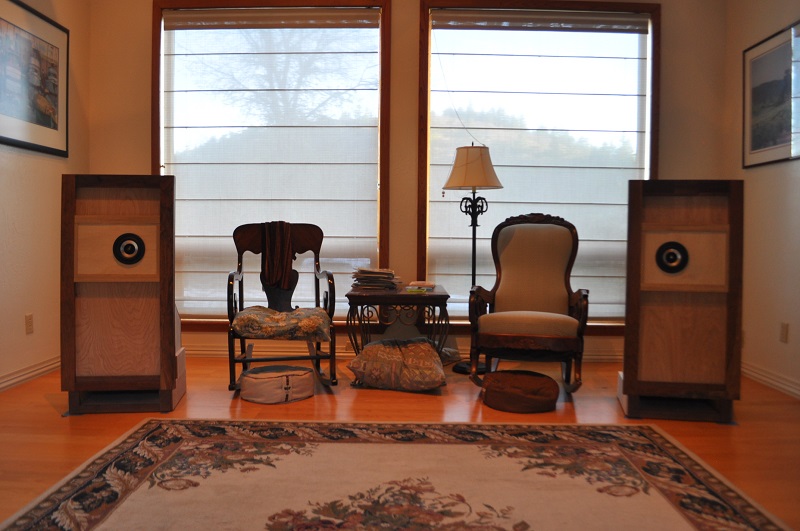

I recently replaced a Eminence Kappa 15LFA with a Faital 15PR400. On paper they look very similair. But it was a really good sound improving upgrade, the Faital goes about 5Hz deeper and augments the mid/low with more of a throaty presents. I like it a lot.
It's filtered low pass/second order with 12mH and 100Uf. I estimate overall system efficiency around 97dB

Tweeters are GOTO SG-06, (1st order filter with a 1.5uF) and Wideband midrange are EMS LB12EX are unfiltered.. Nice and simple, no padding or notching anywhere.

I played around with various voltages, my PSU is variable so makes this easy, and settled on 10,5V. Two friends of mine prefer there abouts as well. I do love them, but they take months to break in and a lot of patience to dial in. My openbaffle is in it's 4th iteration and I doubt will ever be finished.

One of the benefits of the the LB12EX is that they already play very low. With the right enclosure or OBB size/placement they can be made to provide impressive bass into the 40Hz -3dB region. In my listening space with an modest OBB this wasn't happening. By using a narrowed baffle and without filtering (idd similair to Bastanis), the LB12EX rolls-off earlier, so I could cross-over at around 150Hz (maybe a little higher) to the woofers below. I like a nice low cross-over point. The cross-over point was derived by ear, over months of tweaking.
