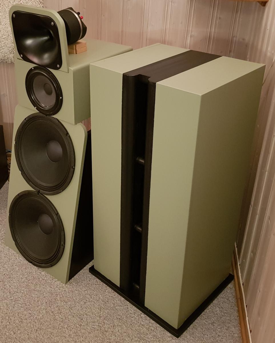

Ny latest build. Army style.
Looks great except the colour , guessing you had a lot left over. Seriously a good looking rig.
@head1962
It's slot loaded open baffle, SLOB.
With 6×12" GPA 414 alnico
I didnt build these.
Very goodsounding bass from 30-200 hz.
I build the 3-way satelites my self.
Ugly green, didnt look so when l was in the paint store. I do it again with other color later when the upgrades are done.

it looks like the green Bruel & Kjoer used for there audio measuring equipment!
Looks massive and nice. Great work. But try to put some (a lot of) space between the speakers and the back wall
